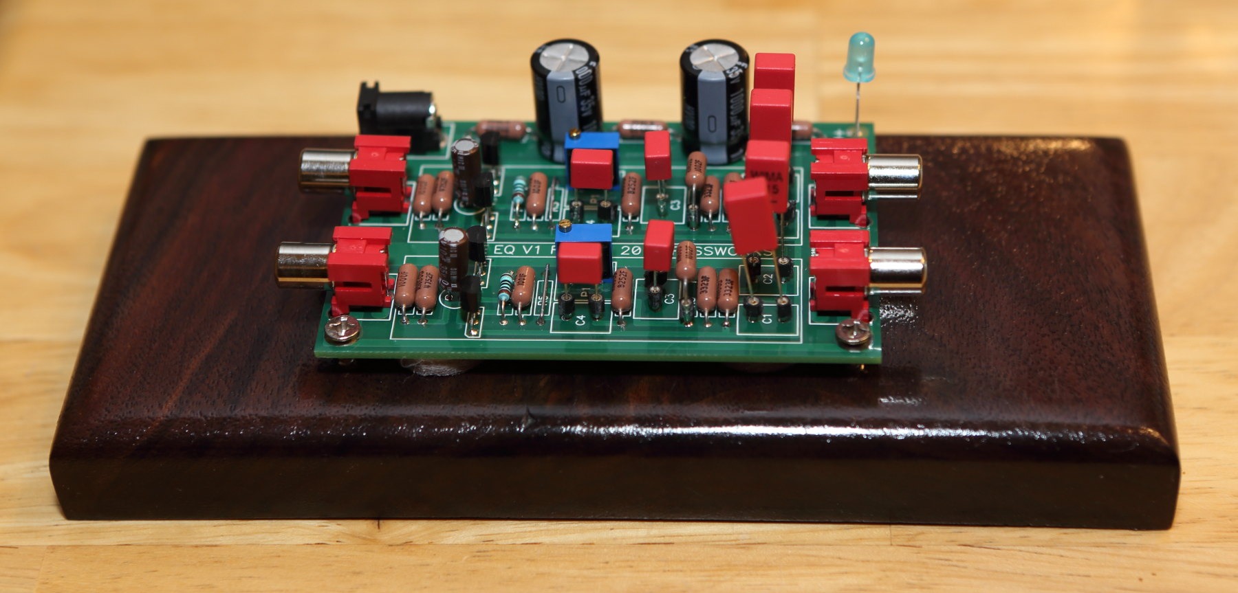

I opted to finish mine "breadboard" style. I added little rubber feet and it will sit behind my preamp.

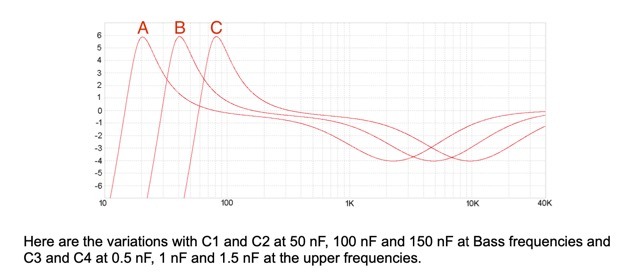

I really look forward to incorporating these boards into my new 'small system' being constructed, and I'm trying to 'guesstimate' some starting values without running a simulator. A small request from those with experience using this circuit. In Nelson's intro to the board he presented the below graph, but the traces were not labeled. Clearly, curve B is C1,2 = 0.1uF, and presumably C3,4 = 1 nF.
First question: Which of the two remaining cap values go with curve A vs curve C?
Second question: The "reference curve" as presented (in Nelson's intro) supposedly used C3,4 = 470pF and its treble minimum was at 4kHz. I believe that's inconsistent with the below graph, in which the lowest C3,4 value was 500pF. If the C3,4 value of 1nF produced curve B with a filter minimum at about 4.6kHz, then aren't these treble curves - with minima from ~2.2kHz to 10kHz - about an octave off? [We see that the frequency shift produced by changing R5+P1 is significant, but could that explain the discrepancy?]
Many thanks for any insights or suggestions!

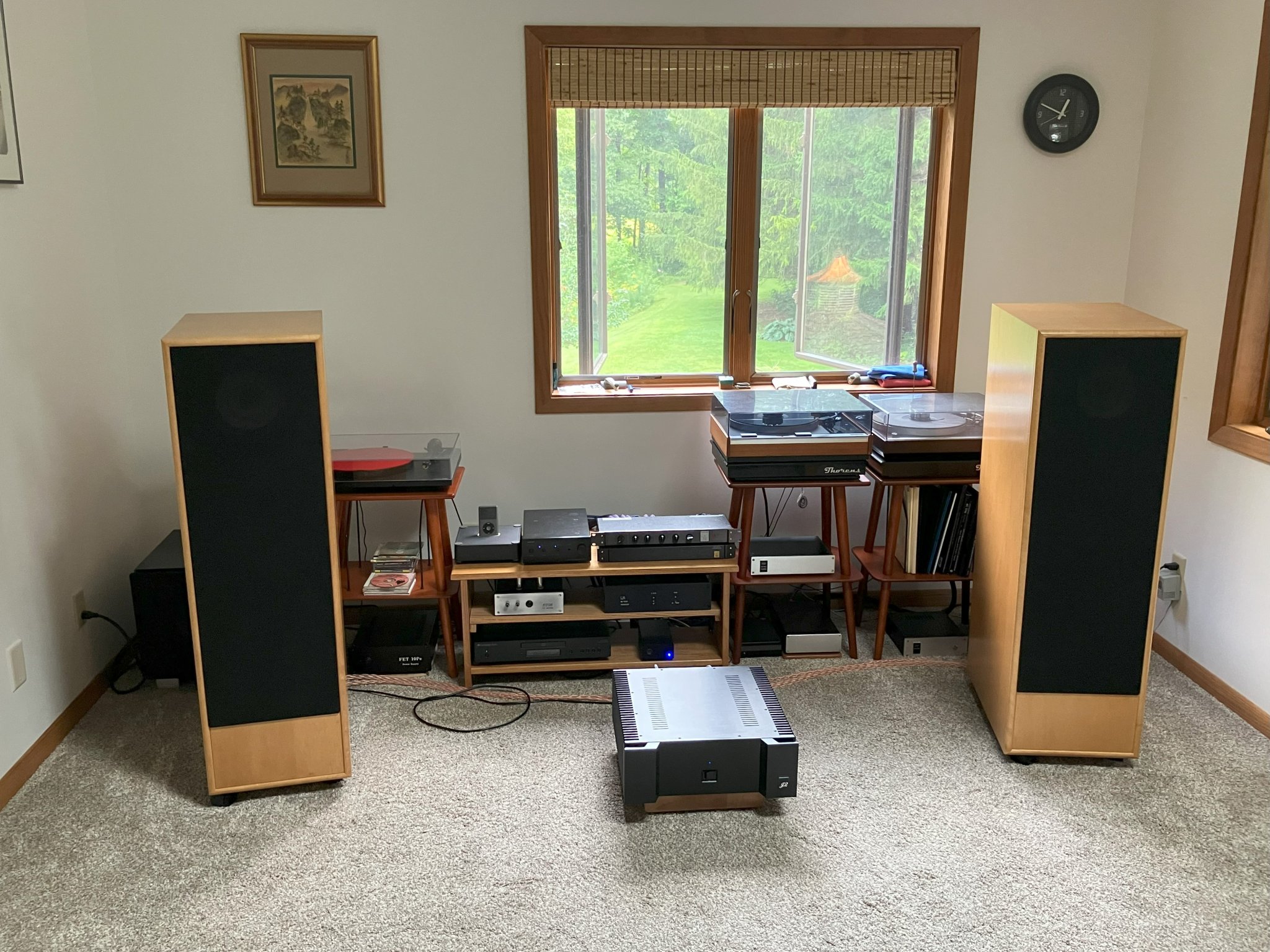

I changed my listening room from the SLOB's to the Lowther Medallian 2 cabinets with PM2A drivers. Threshold FET 10 HL preamp with a EUVL J2 clone amplifier. The Full Range EQ I built to reduce the 7K Lowther "shout". What an improvement, fuller sound, easy to listen to and has the wife's approval!
Thank you Nelson! This project just saved me from buyers remorse with the Lowthers.
