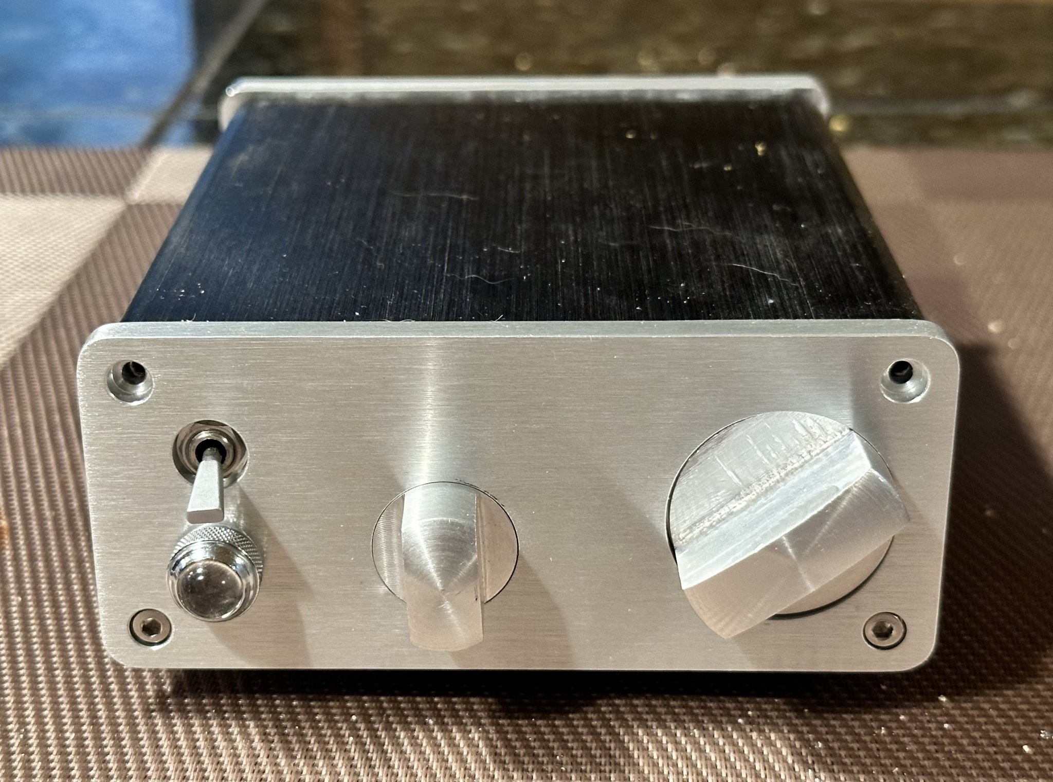

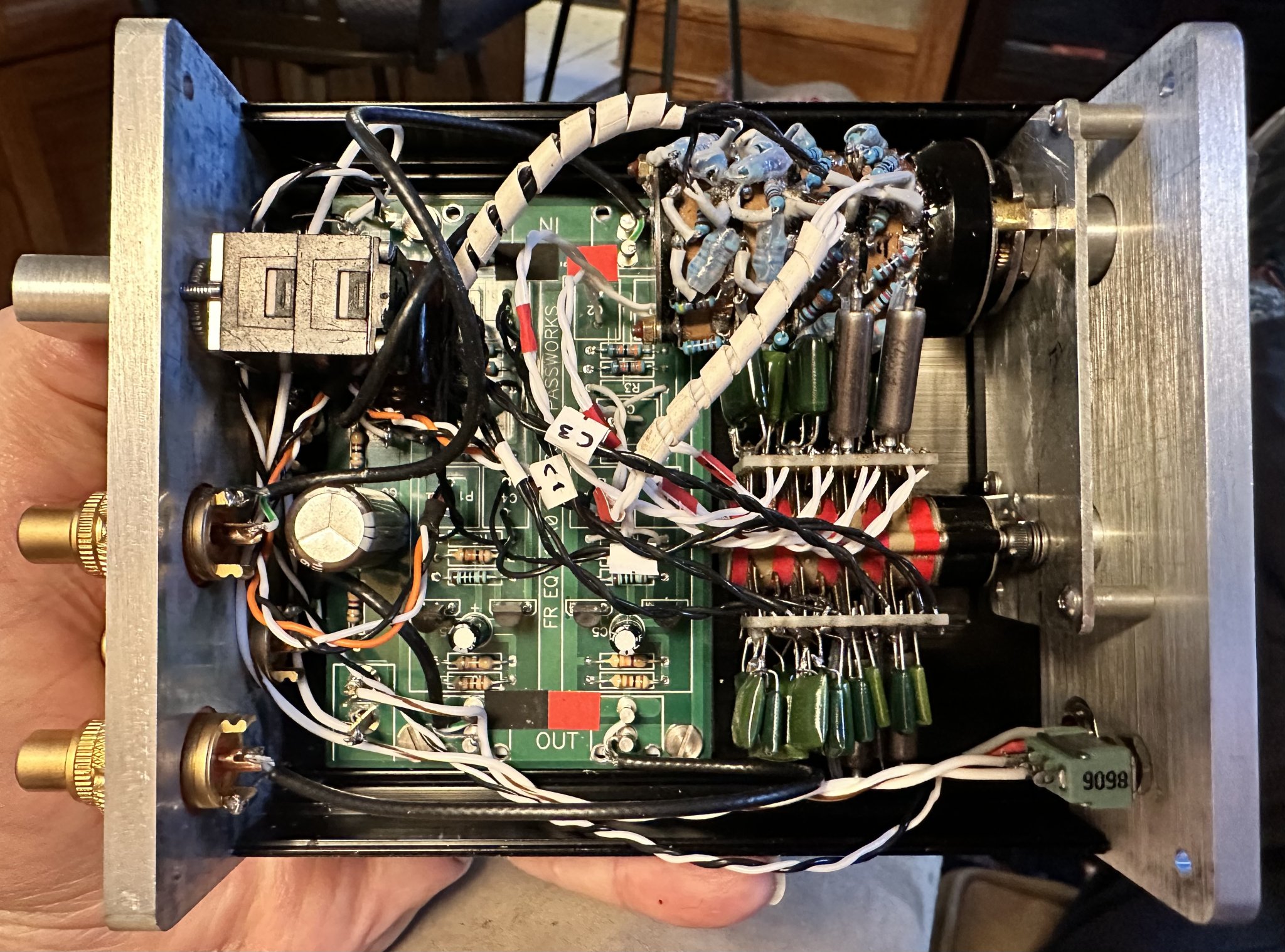

I just completed a build on this project for a pair of 8" FR based on Dayton PS-220, with a Beston circular ribbon tweeter crossed at 8khz. Unusually for me, when I turned it on, it worked flawlessly—I think.
I wanted it to be pretty adjustable, so I used a Grayhill 12-position, 4-deck for R3 and R5 values, and an other multi-multi switch for the capacitors. Also used a 100k pot on the back panel instead of the board-mounted trimmers, which seems to set the range for the resistor switch. Lots of fiddly soldering and doubling up some resistors to make up the odd values for the 12-step. Really couldn't cram anything more into this little box. Sounds good and seems to do exactly what it's supposed to do, although I have a lot of listening to do to get the speakers dialed in.
