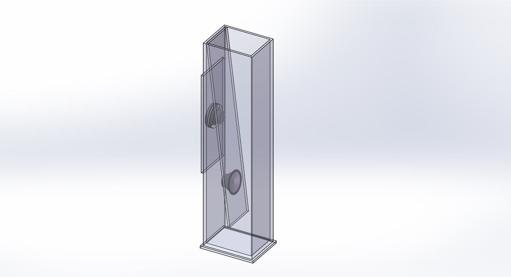

Like this? [Edit - judging by the article you linked to, I assume you meant to add the 2nd driver right on the front of the baffle, presumably under the full range driver... rather than mounted in the internal baffle as I believe was discussed elsewhere...]
Thanks, will do some reading there..For sure it will Doppler it to death if not correctly designed to minimize it and not entirely sure it can be done 'good enough', hence more a 'what if' project, so haven't devoted much time on it until I can do some real world testing. This semi-similar project strongly implies it can though: https://web.archive.org/web/20120317...d/dddllqd.html
I do recall that Vb has to increase to account for the 2nd driver, didn't account for that in this mockup. And yes, I worry about what the woofer driver would do to the full range driver when cranked up to 11...
Can someone who has built a larger BIB chime in on what the bass is like, ie, punchy<---->boomy?
It would be mounted on the other side and much closer to the throat depending on its specs to set the distance.

Also, that 15 coax driver you linked does look like a lot of speaker for the money... certainly worth consideration for a K/karlsonator 15 or other multi-way, if you were planning on using a coax horn for mids/highs. (Which, way back, I was looking for K-horn/Jubilee type sound, having read all the marketing fluff about how "full" and amazing they are). In fact, I think you said you had a set of the khorns, do they not compare at all to the Karlson type enclosures to your ears?
you would need to put good grill cloth or perhaps a standard protective round grill over the 15" coax in K15.
K15 has more ability to "hit" than a Klipsch La Scala and probably more like 4-15 on open baffle. You could make a vented La Scala per DJK's scheme which adds about 2 cubic feet to the back chamber then is ported. Some boost like with B6 vented box could help balance it better.
that 15cx I suggested is also at US Speaker - perhaps you could make
some other type of cabinet. A big vent reflex with small rear chamber shows "hit"
in simulation and also RCA-Fan's measurements - it may be less neutral and controlled
in the bass than the Karlson
For pop music, K15 does not lack "bass" - it has 10X more usable bass than say a 15 inch speaker on open baffle. In its range, K15 is powerful thing. K15 can be very "musical" with the right drivers. 12LTA in Karlsonator may go about as low as K15 but a good 15" in K15 would trounce the weak motor 12LTA.

i would not raise the Karlson off the floor although that's the way
its shown with Johnny Cash

Mmm, better imaging and bigger sweet spot, many I would suggest would consider these to be mutually exclusive........but I believe an open baffle full range could give to both, if, by better imaging you don't necessarily mean pin-point positioning but rather a more spacious, three dimensional image. It can certainly give you that live feel.
K15 upside down, on a stand up at the ceiling instead? Ceiling loaded! 😉
Scott - more spacious 3d image, but not a tiny sweet spot. Makes sense they might be exclusive to each other.. that stinks. Current setup there's maybe 2 ft left/right at the couch you can move where things seem "centered". But that's with cabinets angled in only slightly.. It may have been a bit better when I turned them in more and tried that "cross them in front of the listening area" trick... til everyone in the house tripped over them and complained, haha
Open Baffles I'm still feeling rather "meh" about, not to mention the toddler poking the front And back of the cone aspect. Maybe something that was a 'U' bend, with the back of the U near the wall could work, except then it's just a place for them to hide during "hide n seek"... And I'd really have to hear a set of OB to be convinced it would make the kind of full sound I'm looking for... my brain just screams "nooooo, it can't make any bass, there's no enclosure!"
