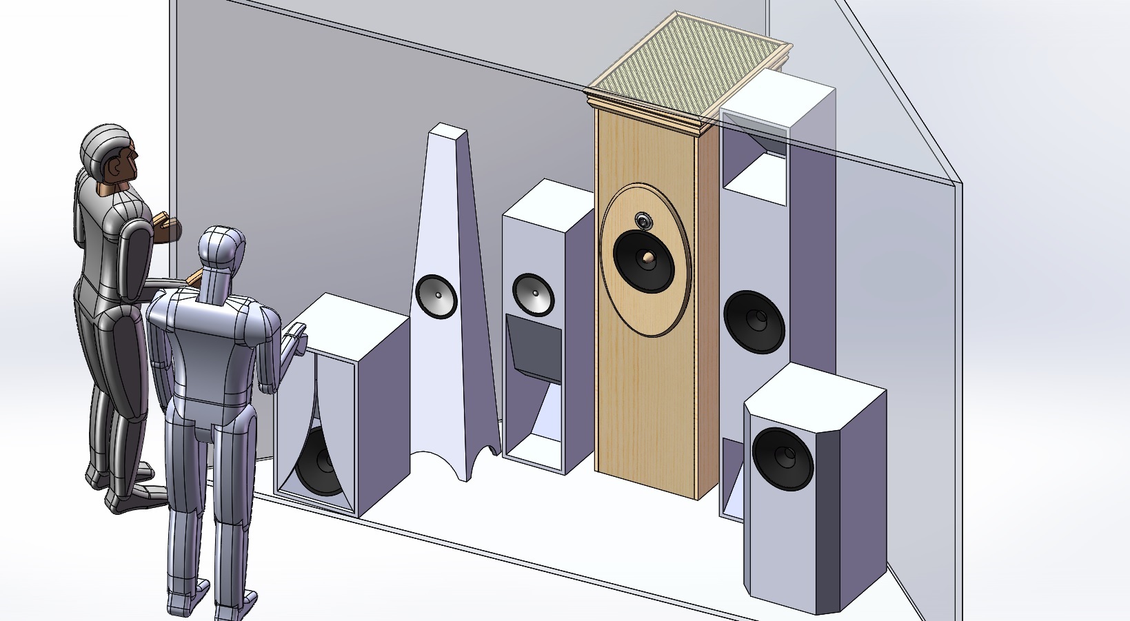

Modeled a few of these in 3d for fun and to get a sense of what they'd look like in scale. Most are basic mockups only. Can you identify them all? 😉
Only fooled with the single driver ones for now, but will end up probably modeling whatever else sounds good. I can make real models & drawings too if it's a new design or something that doesn't have drawings yet.
If we're not careful, this is what my living room will look like!
