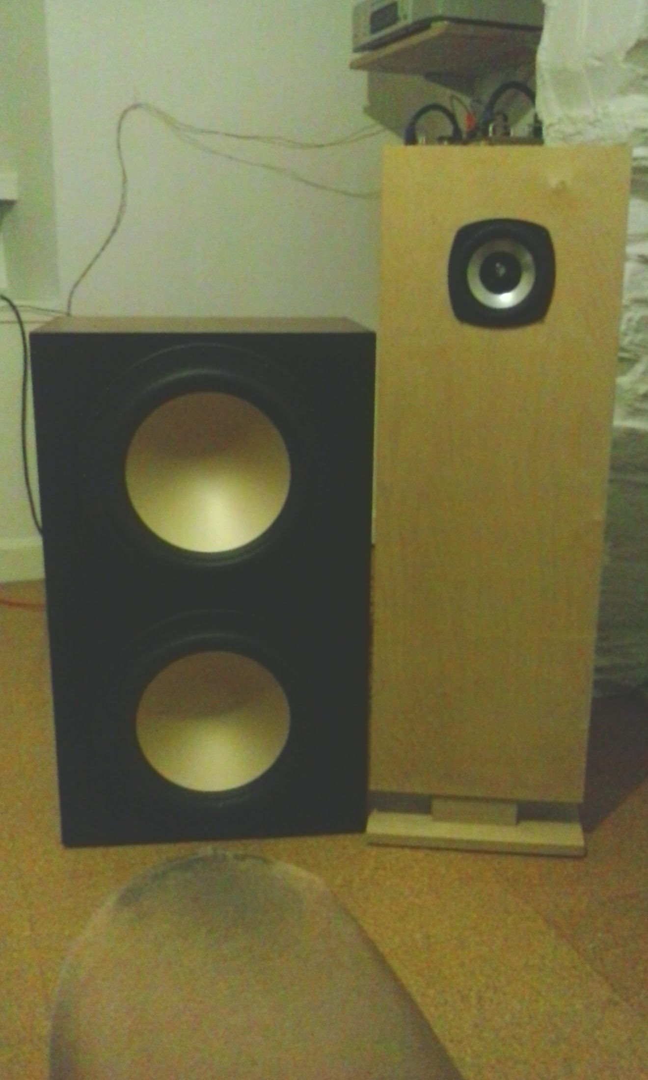

Scott - is that a dual setup, or are those helper woofers..? Well what all are they?! 🙂

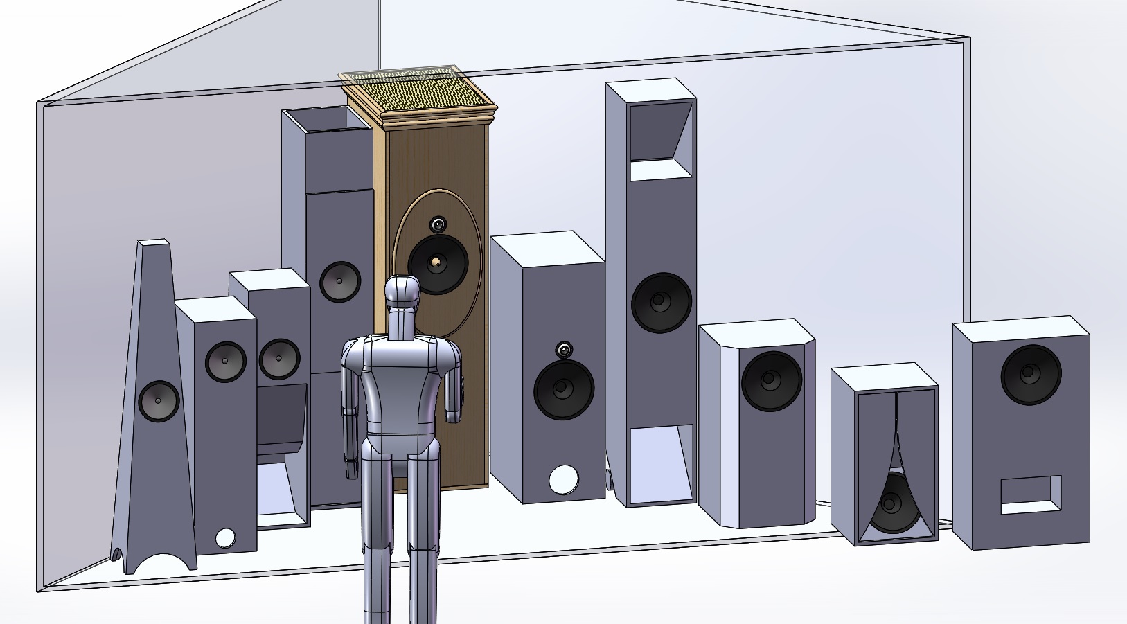

BVR were popular in the early 1950's and seen in University Sound's cabinet lineup for the Diffusicone fullrange series (see Abraham Cohen - HIFi loudspeakers and Enclosrues) You can use hornresp look at tradeoffs

1954 big vent reflex - aka - stubby horn reflex cabinet - Bill Woods calls them "half horn"
The woofers are HiVi M12's in a U-frame, 2 each side crossed at 125Hz. The small fullrange is Jordan Eikona (also with active crossover) in the VTL cabinet but I built it with a removable back panel so I could also use it OB.

Scott - nice! That's a bit fancier than was I'm shooting for, I like the look of the dual 12's... how is the bass open baffle with them?

How do you mean? U-frame is a kind of open baffle

Hey scottjoplin - what's your OB/sub setup?
Scott - I must have been between 2 thoughts there.. thinking a few words in front of what you're typing causes trouble! All I meant was "how is the bass from the OB 12s?"
I have them differently to in the picture, they are now against the side walls and about 4 feet from the front wall.

@ 007. I'm very happy with the sound. Very accurate, I find double bass a good test. They reproduce all types well, even old school dub sounds effortless and more interesting. I don't use any LF boost but a little EQ to flatten the response. Also they don't pressurize the room as other speakers do and the bass doesn't travel/carry through the house in the same way
scottjoplin - what drivers does your OB system use? What crossover F and slopes? I have Klipschorns in a room with flexy walls - I can tap the wall and it will go "booommmmm" = horrible coloration rendering the cornerhorn unlistenable. I like the Karlson's in general as they do well with drum transients, bowed and plucked/salpped bass. The little K12 makes a good front-load horn substitute and slotted pipe tweeter, much different than large WG sound.
Four HiVi M12's in total (Swans) Product information:M12 Bass-Midrange and a pair or Jordan Eikonas, using active LR4 crossover at 125Hz
