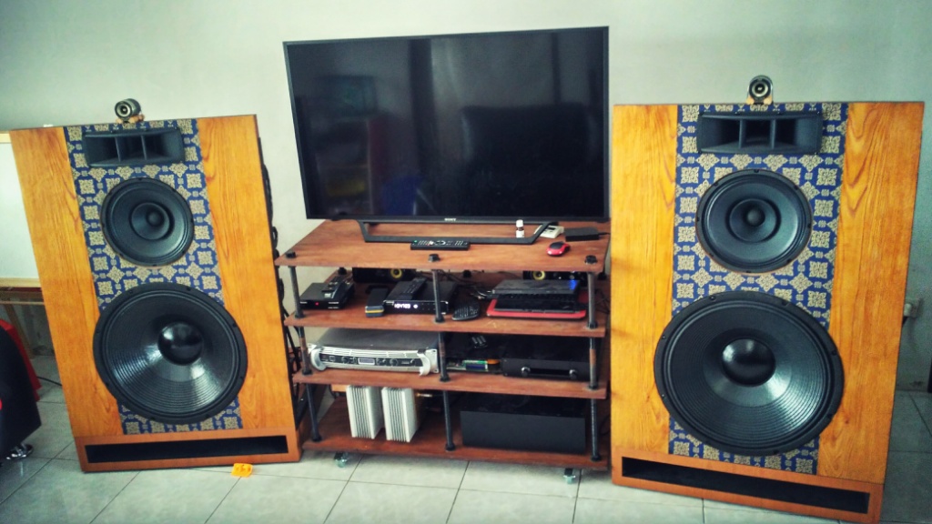

32" wide open baffle, 21" subwoofer powered by inuke nu3000dsp, class a amplifier for 12" + tweeter, big enough??
it is also in living room, main area for family member. i have 5yr twin boys, another 8mth baby girl. for the boys, i had taught them to take care of the speaker cone. indeed previously the took out some cones of hifi speaker, but now they already understand not to do it anymore. anyway PA driver is much stronger than hifi driver.

Gadut - those look nice, those 21s are indeed big. So they are set up with the 12lta running full range and tweeters at top end? What about those horns? The inuke3000dsp is what i was planning on to drive a single 15" sub (lilmike "f20" or maybe his "lilwrecker").
I was planning the separate single sub for home theater use only - just turn it on to switch the system to HT mode. Perhaps there is some merit in mounting the subwoofers in the same enclosure (or "board" for OB) but with separate internal baffles of course... I think i went away from this because the enclosures got rather large.. especially with the lilmike designs, blh/TH. With a sealed box, or even ported, the size would likely be much more manageable.
