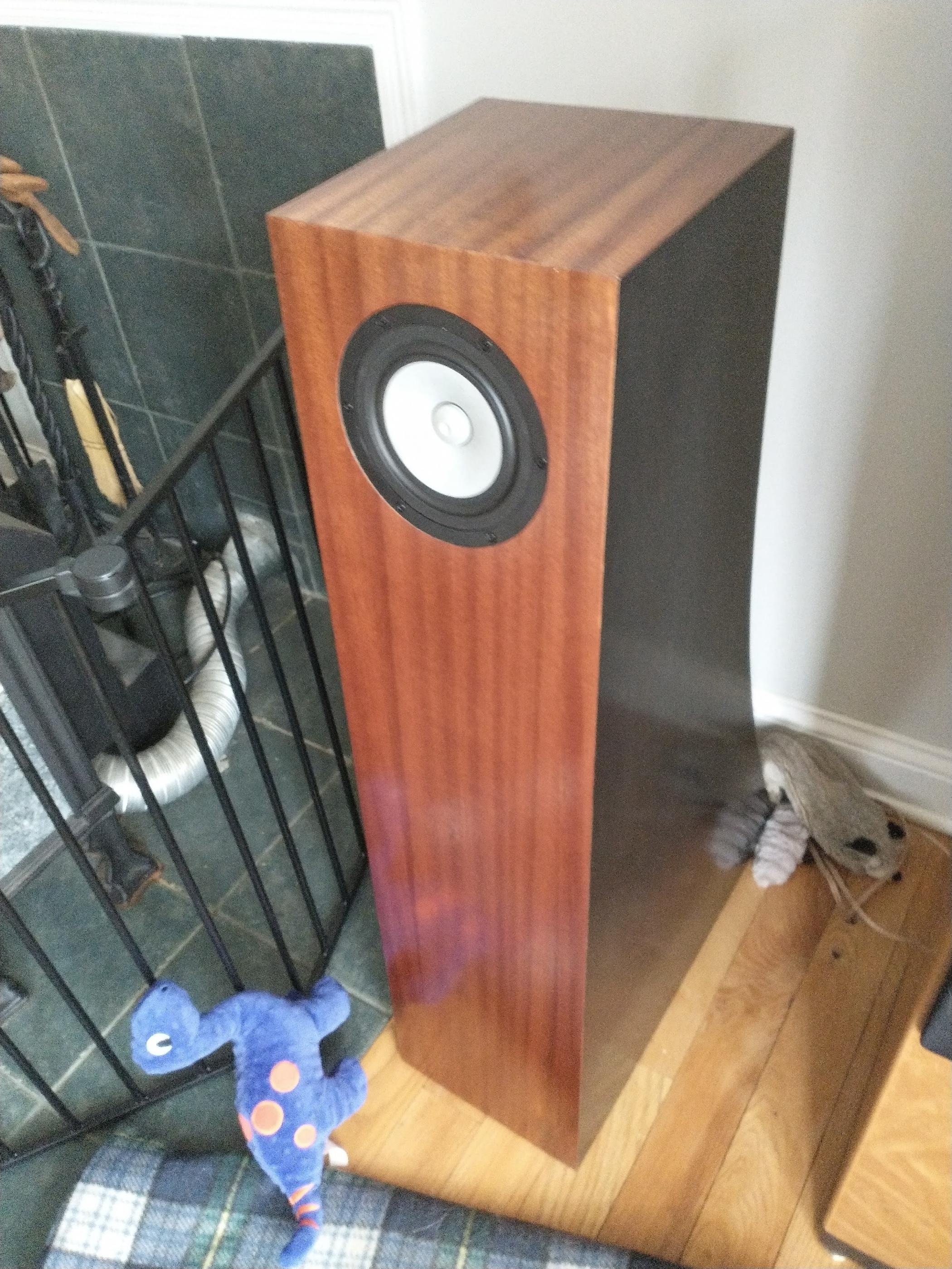

I used veneer that I had left over, curly maple and walnut, the walnut was too short to just run vertical so I cut strips and put them together at an angle. Frugal. Or cheap, but I like the outcome.
It's beautiful work.

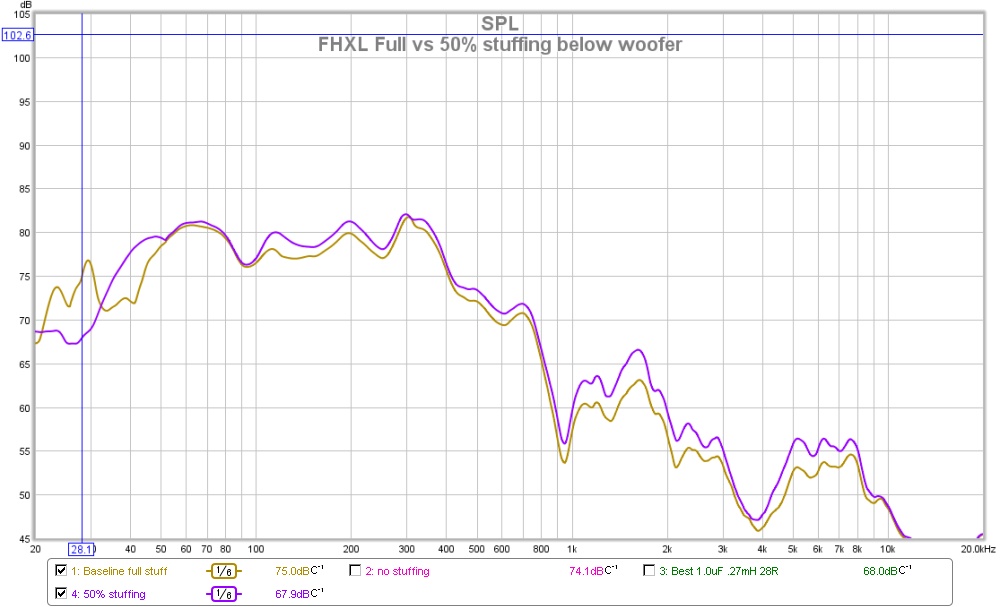

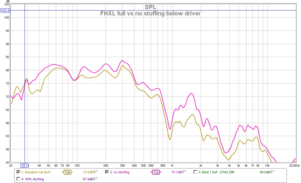

These are measurements from my FHXL with various levels of stuffing "below" the driver. Mic position was at the mouth of the horn on the back of the speaker.
Stuffing makes a clear difference...

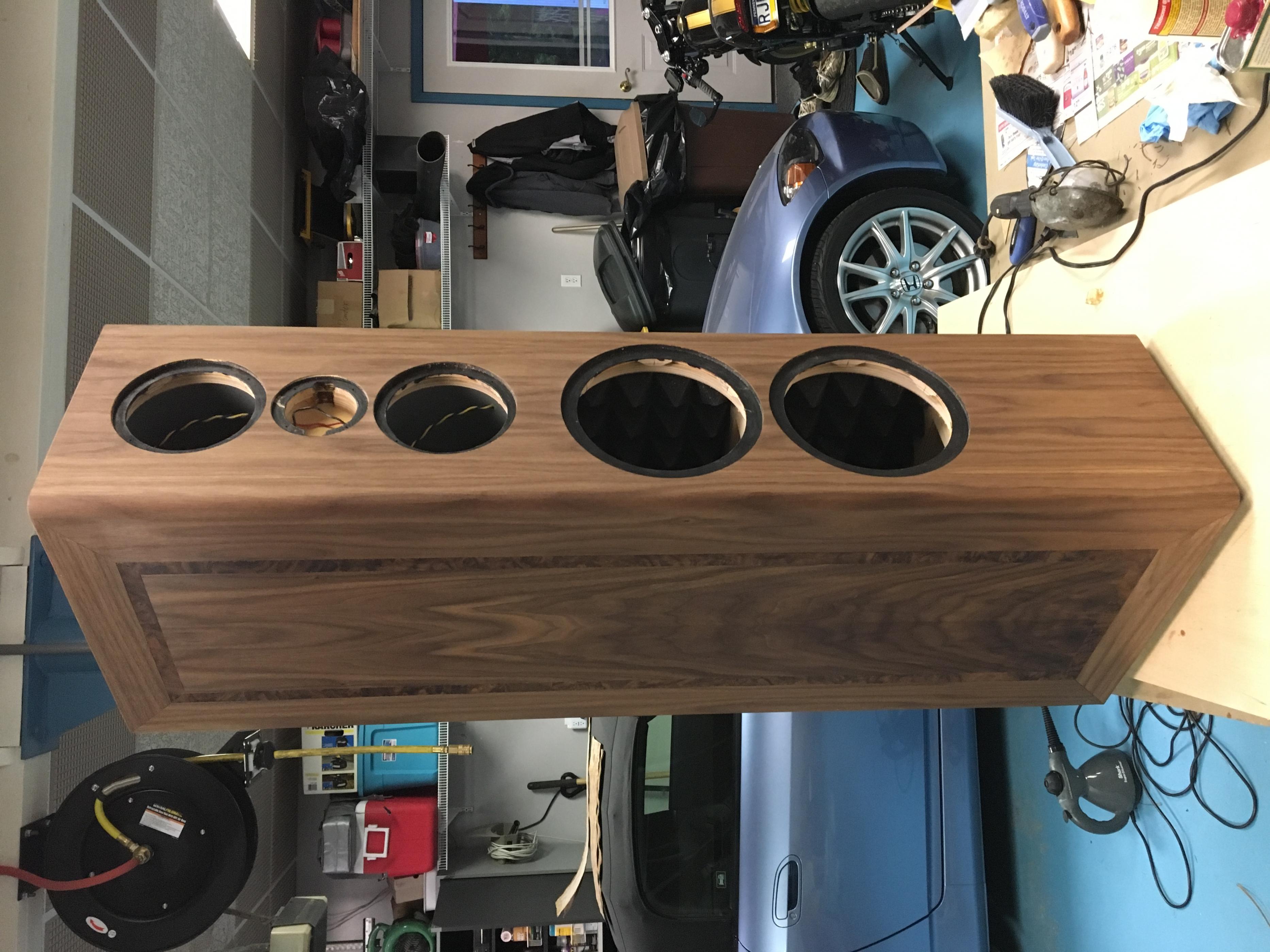

From what I see you have no reason to be envious. Yours are gorgeous also! I actually bought some wood dye and was going to experiment with dye on the curly maple. I got hung up on the bleaching part because the maple was not backed and it was very fragile. I don’t have any pics of veneering these but I used my wife’s rotary cutter and poly mat (like a razor sharp pizza cutter) and a metal straight edge to get straight cuts. I used the iron on method, started with the walnut and just ironed the joint of the maple on the front down first, keeping the joint tight as I did. After a nice joint was made I started working the rest down. The heat from the iron will allow the veneer to compress and expand as needed to lay flat from there. I discovered this working with burl which will not lay flat no matter what you do. Final secret: when sanding everything flat, use a razor blade to scrape up and save the lightest color sawdust. Blow out any cracks or gaps, fill them with blonde shellac and work your sawdust into the cracks.
Here’s a couple of pics when doing the Anthology’s. I used a water soluble adhesive tape on these to hold things together until ironed down. You can see the cutter and mat there.

Thank you but yours are in another league! Something to aspire to. I have much more appreciation for veneering, it really is a craft. I'm excited for my next build to try again. I did have to use the sawdust trick as I had to piece the tops together from three scrap pieces.

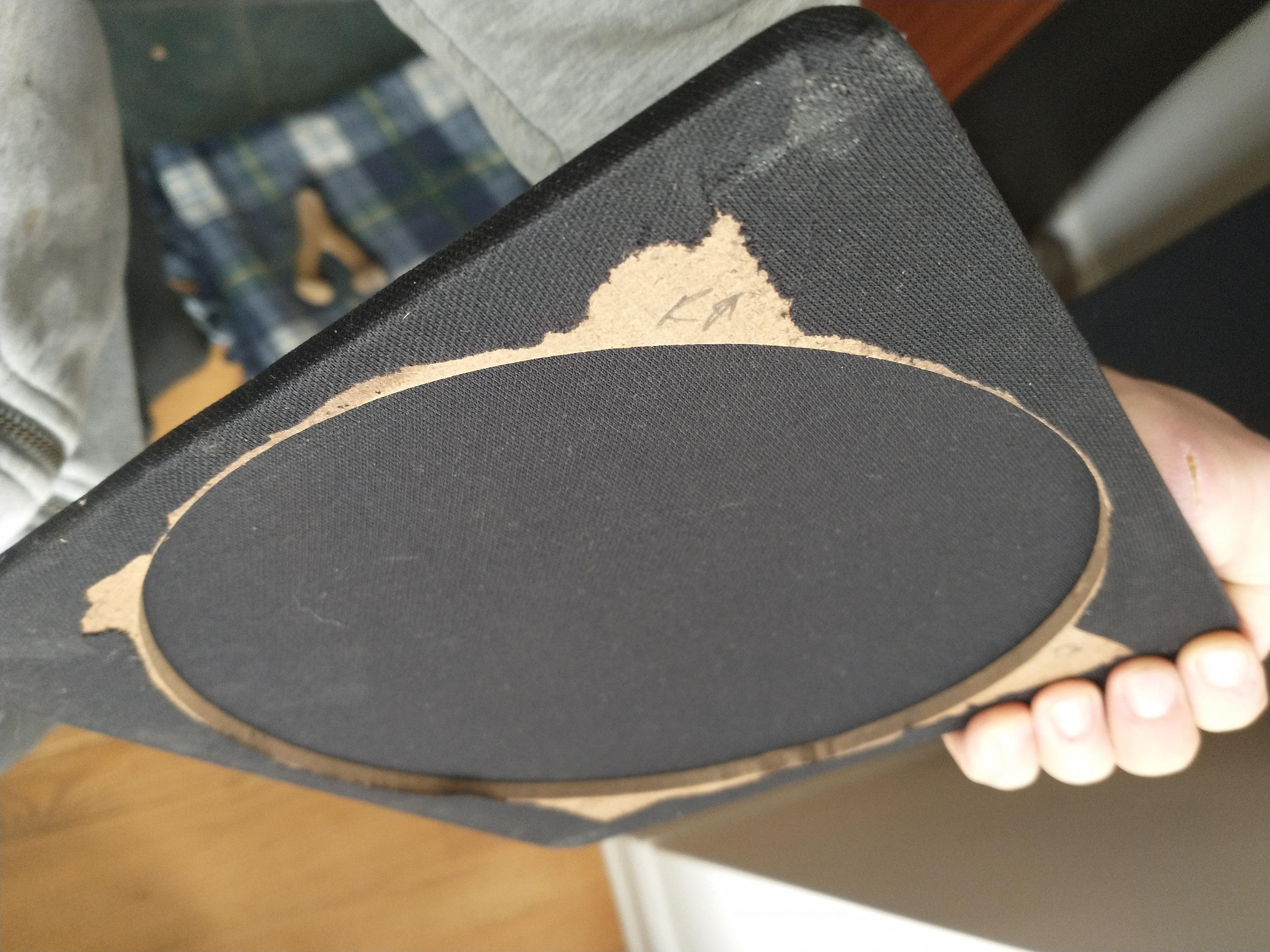

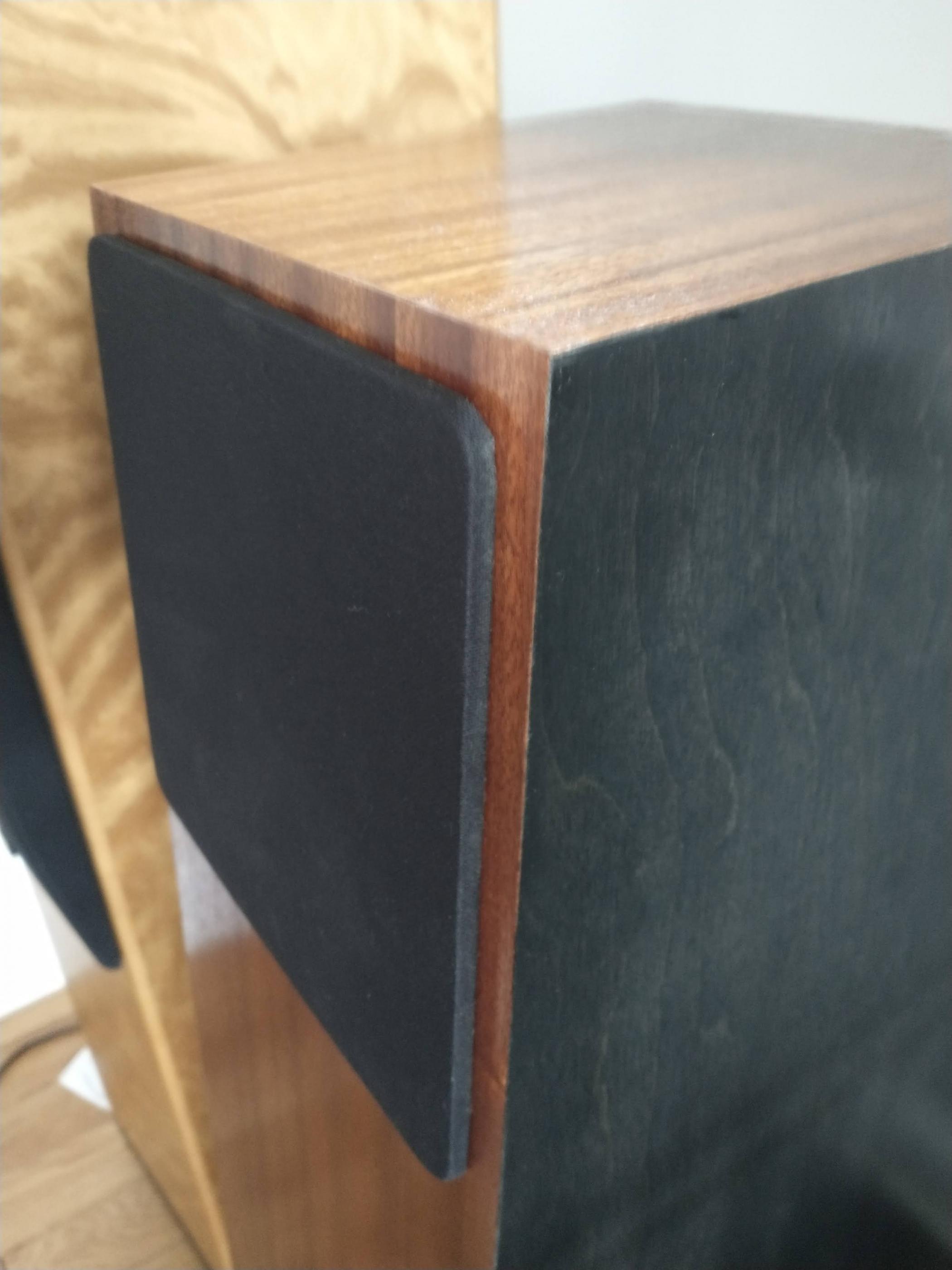

The grills are really simple, just 1/8" fiber-type board with the corners rounded over. These were temporary after my *&#% cat creased one of the cones jumping up on them, but they will work until I can make a nicer pair.
