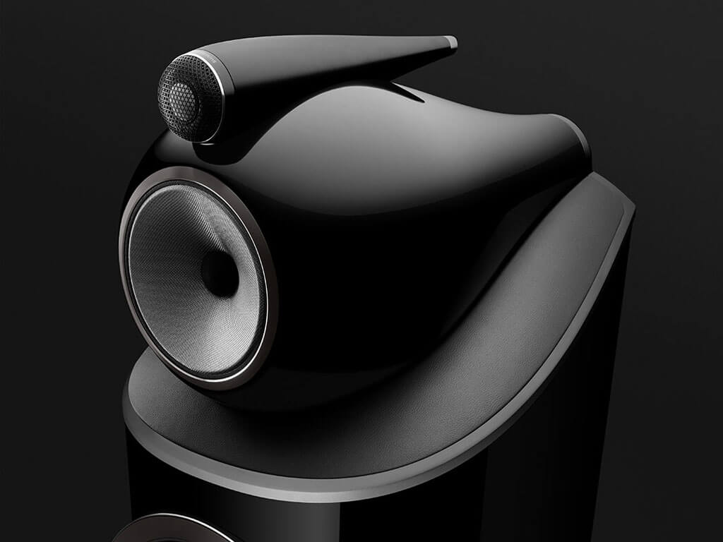

Ideal would look like a B&W midPod set over the top of the horn, simple, just to make it easy to swap drivers is just an extra bit flush with the edges. I wonder how something derived from the very specifically designed 5 petal flower used as n OB might be interesting.

Wow, blst from the past. An wddoert to imitate the B&W midPod Fonken-style with flat material.

I'd say this is what you meant with the B&W midPod into the FH:

Dave, Chris, Ron and I would have liked it too -unfortunately, Ring Audio failed to acknowledge their box was a Mk1 Frugel-horn with the driver stuck in a sphere on the top. The terms-of-use we clearly specify for commercial use were / are not very onerous, and their attempts at justification, even claiming that they 'exchanged ideas' with us (an euphemism for 'we provided them with plans') did not do them any favours.
Be that as it may, the pod Ring Audio used is OK-ish, but better is the extended taper B&W use like the attached.

I am not taling about a pod on top, the pod would envelope the top of the FH leaving the driver in the same place (more or less). This just disguises the rectangular portaion of the box at the top where the driver is.
It could be prototyped with a carved styrofoam shape that fits over the top of the horn (rear mounting the driver).

At the frequencies involved a stepped, or flat-sided shape is little different than a smooth one, just avoid sgharp corners.
In this image you can see some thots about stepped “supraBaffle” that emulate the B&W midPod. This BTW is Maiko, the more exotic BVR Scott & i have done, for a very expensive driver, NLA, and IMO not all that good.
