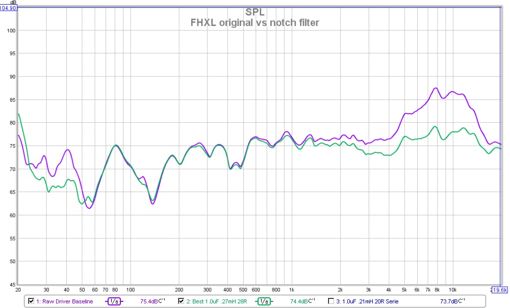

@FourEars: Here is a frequency plot that I made with my FHXL *in my room.* When I first put them in place, I thought they sounded odd compared to my previous speakers. I gave them a few months to break in and still didn't like what I was hearing. So I made some measurements and confirmed what I was hearing that I didn't like - it was a response hump in the 5-12kHz range.
So, after several days of measuring and experimenting, I built a notch filter: 28R, 1.4uF, 0.27mH all in parallel to one another, and put this in series with the driver. This flattened out the hump I was seeing/hearing and then I liked them a lot more!
Fast forward a few years and I put another pair of speakers in that same place and found the SAME response hump. Silly me, it was room placement, not the specific speaker... This time around, I have a new receiver, so I made the change with the electronic crossover in the unit instead of using an external notch filter.

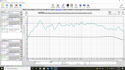

@Eric. I’ve had other speakers in that same spot and not had an issue but I do have a Umik and have not tried the actual listening position check. I think part of the issue is the height and 5 degree angle puts these on axis with your ears, whereas the DNAs are only 30 inches tall so they are always off axis. I’ll get off my duff and check these. My amp is Audyssey capable so I could try that also. I’ve always wanted to make the speaker sound right instead of compensating because my speakers get moved from time to time. I don’t know about anyone else’s experience with the A10p but it seems to me that putting ANYTHING other than a resistor in-line seems to kill my favorite aspect of the speaker and that’s how coherent the midrange is. I’m loathe to add passive filters because of this.
@Eric, here is an in room, at listening position sweep with no correction of any kind. I certainly do not have anything showing that would lead to shrillness. If anything, this is showing that I have a very “dead” room. If I add some bass, the average of the lower frequencies moves up to level with the mids and that is what my ear said sounded best. I moved them closer and farther from the wall with little effect. A bit less jagged low response closer to the wall but no big difference. Audyssey on my receiver did little or nothing to improve or flatten the spikes even though I used the same tripod for both mics. My receiver has EQ but only nine bands so I cannot make much fine improvement there. The big waves on the bottom may be room issues. These are playing to the short dimension of the room so I could see standing waves being a problem.
