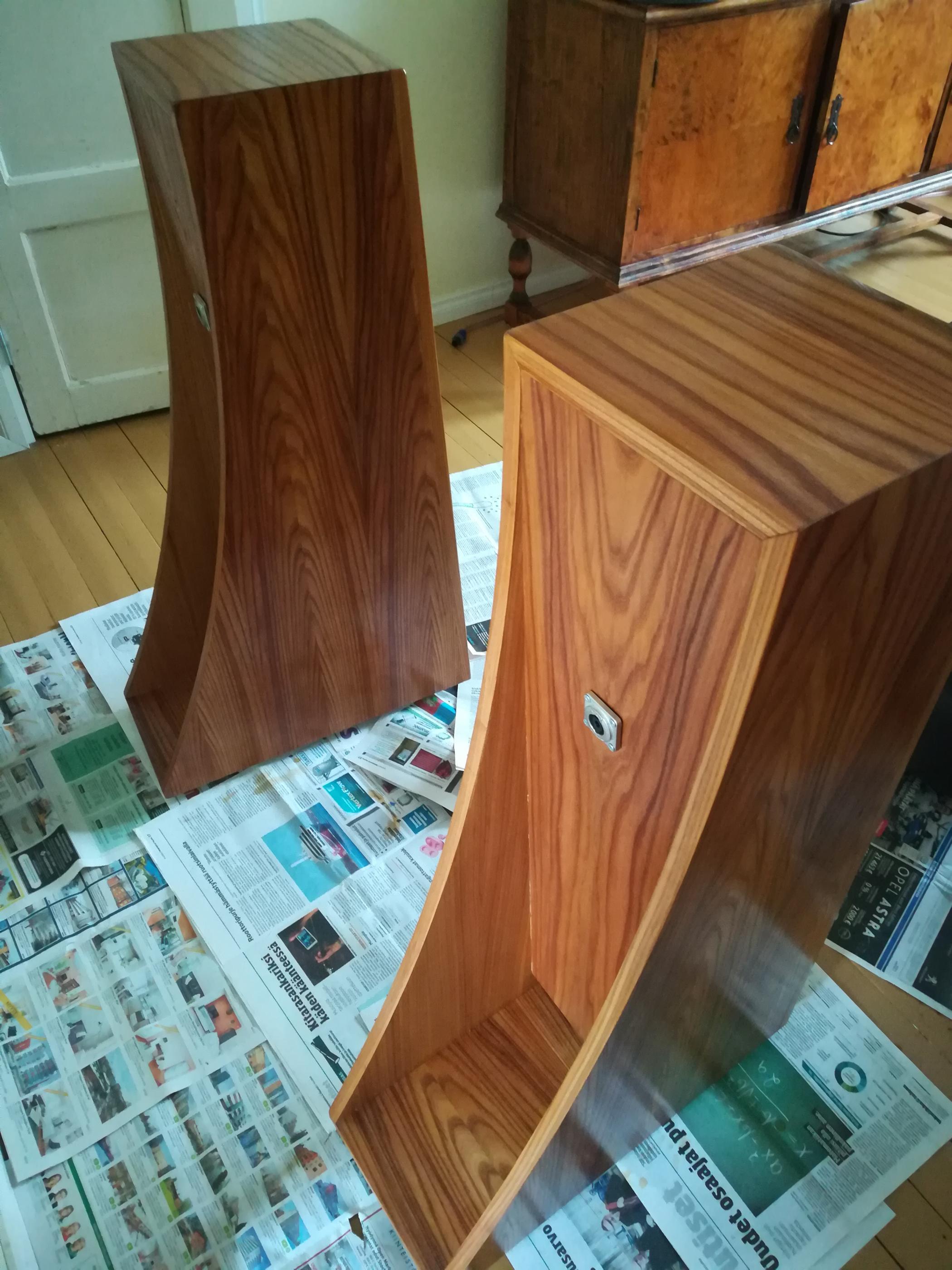

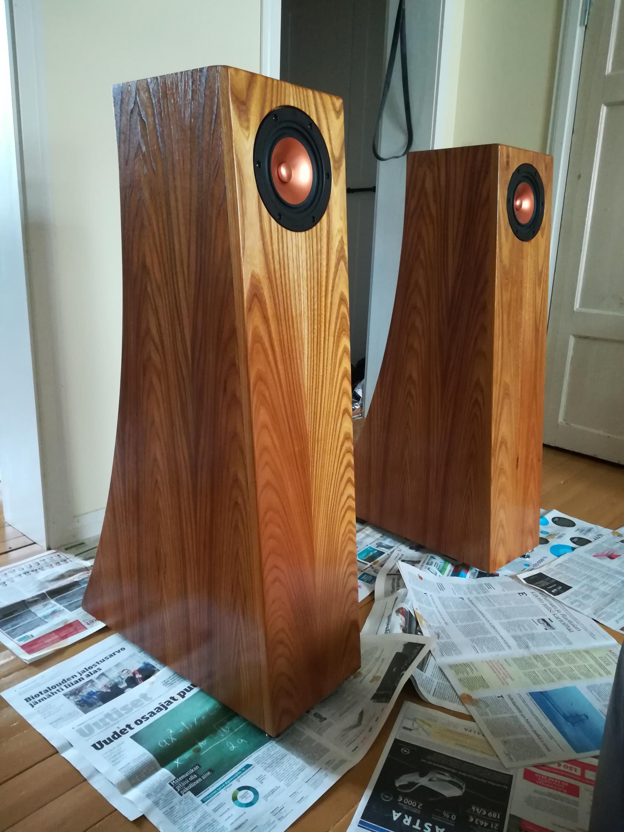

I removed a bunch of foam filling from the cabinets. If I recall I originally put 60g of foam to each speaker, and now I reduced it to 20g, expecting that I would have to put some back. It had a profound impact on the sound, in a very positive sense. The tin-canny effect I was describing earlier was eliminated to a large degree. What brightness is left is characteristic I'm sure. The soundstage opened up very nicely.
As to Paul's comment regarding using pure tung oil, at least in this case it makes a big difference in accentuating the grain. The effect is very pronounced compared to any other oil or wax I tried. Shellac I then use to provide a protective layer, and some shine.

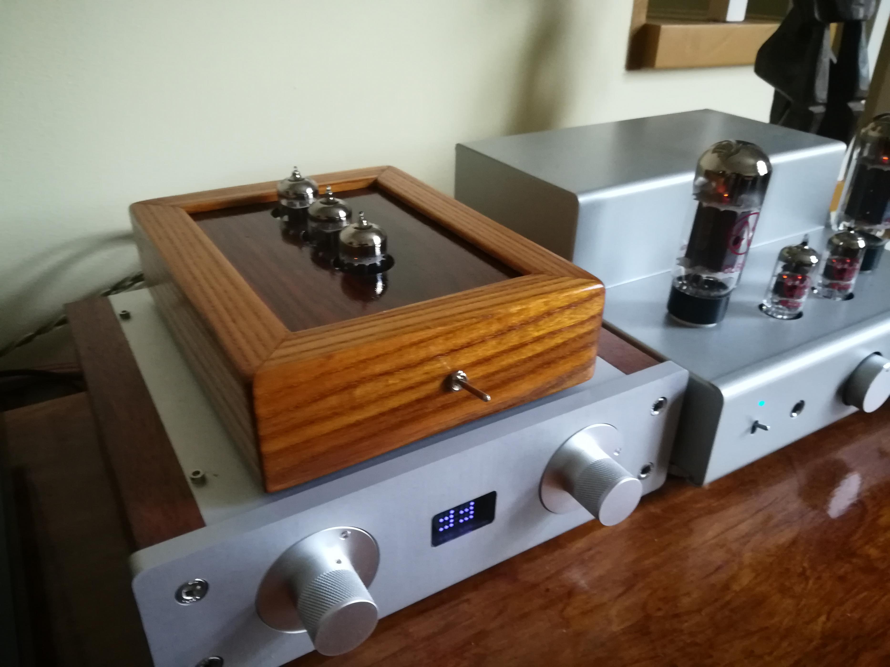

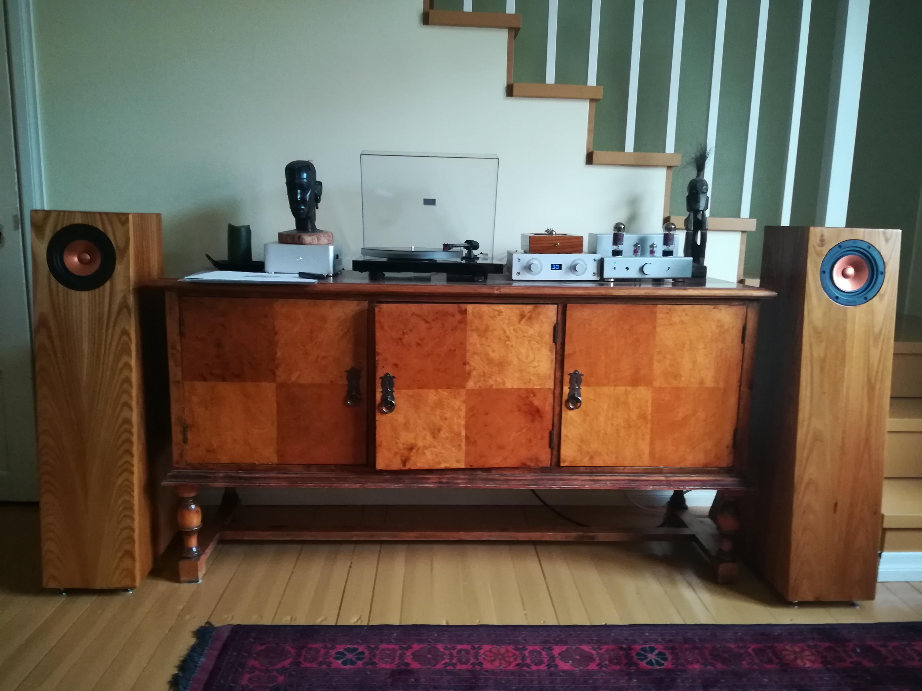

I proceeded to apply the shellac now, and consider the speakers complete. I'll add a few photos to show the end result. There is a bonus photo of my phono stage, I made a new case for it from the scraps of this project. 🙂

Thank you for the compliments, gents! I don't know about sweet spot yet, but there has been a definite improvement from the starting point. Pulling the speakers away from the wall helped too. Probably would be beneficial to do that even more, but then the speakers will already be in the way and the local government will start to issue protests. If you know what I mean. =)
The Local Government Who Must Be Obeyed... I’m sure the WAF is pretty good on those speakers though? They look great!
Thank you! My significant other was positively surprised about the end result, so yes, on the most important metric this project was a success. 😀😀

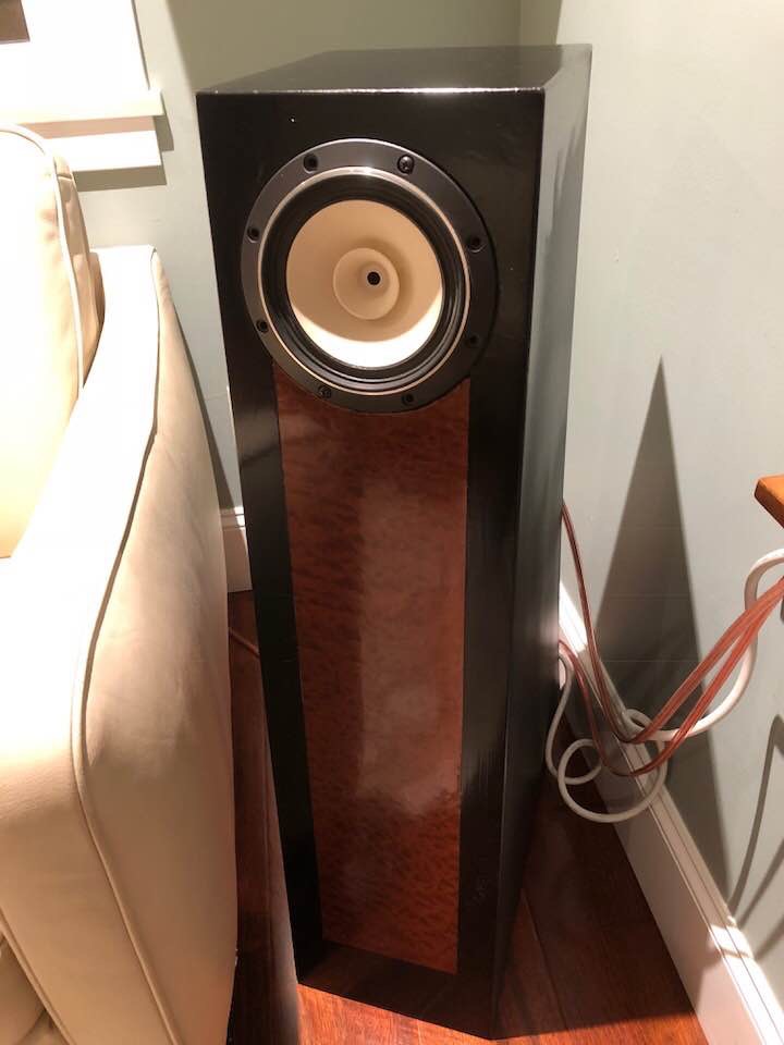

After stalling the build for years... it’s finally playing music.
I don’t have any other notable fullrangers to compare with and it is too soon to critique. These fostex haven’t played more than a few hours for a proper break in...
So far, they are enjoyable to listen to despite the lack of space for proper placement.
