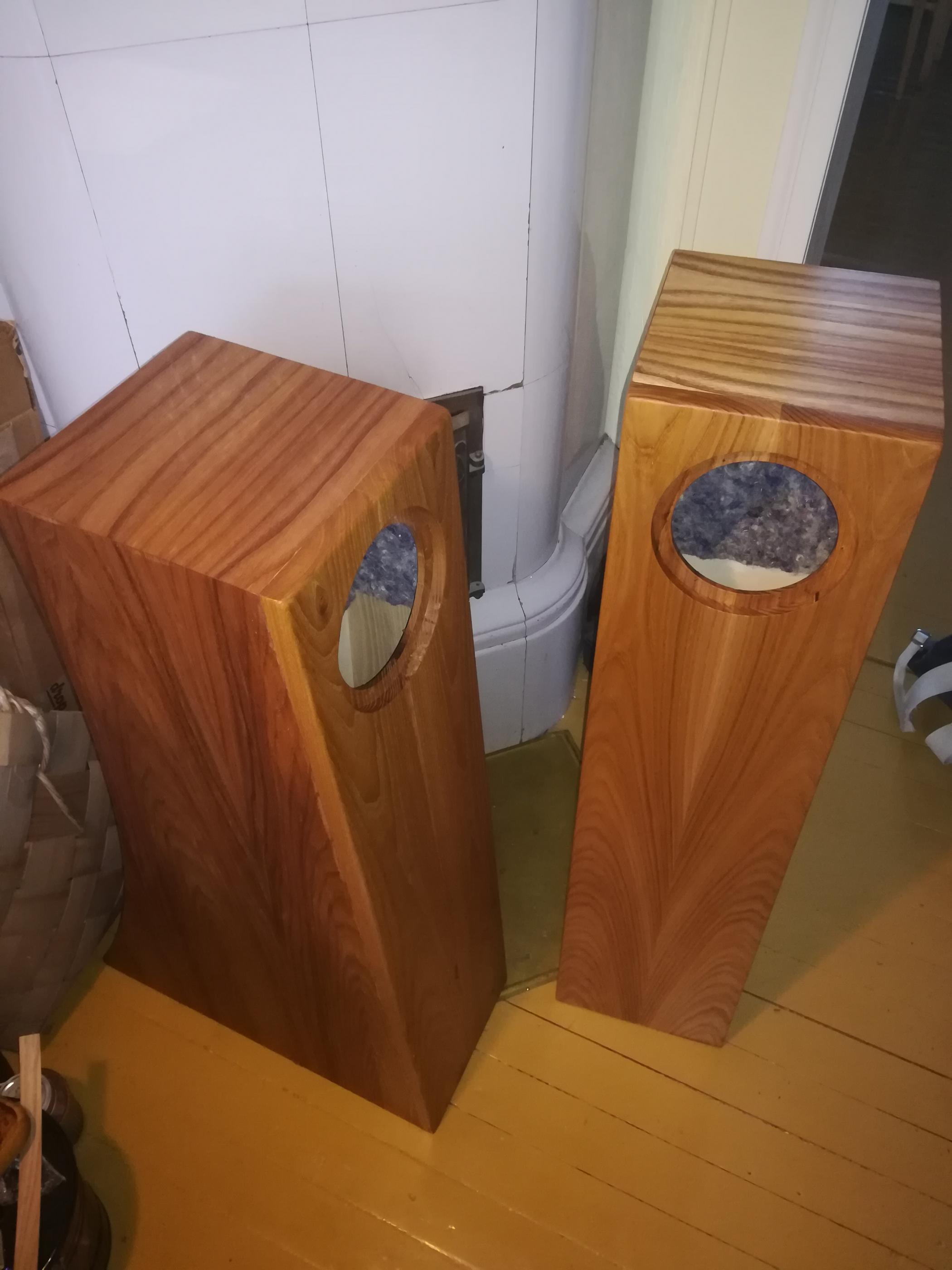

Thanks Eric! I have been experimenting with different finishes that I have available. A few oils, nitrocellulose lacquer, waxes, shellac and so on. Tried some pigment as well, but it didn't really flatter the wood. My treatment of choice is (at least at the moment) tung oil followed by shellac. The tung oil really brings out the grain wonderfully, and the shellac adds a bit of further luster as well as protection. You can see an example from my experiments on the previous page, message #966. Both finishes darken the wood with each coat, so I will have to be careful not to overdo it. When applied with moderation the warm tone looks quite pleasing to my eye. Please tell me what you think!

Tung Oil is nice to bring out the grain. As I'm sure you know, Tung Oil never really "dries" it just soaks into the wood, thus it limits what can go on top of it. Give the Tung Oil a few weeks (months?) to fully absorb before you top coat it. It will change the color of the wood and the grain a little during this time as well, so patience is key (this is the part I'm not very good at).

Yeah, patience is not exactly my forté either. =) Thanks for the warning, I am aware of the long curing time of Tung Oil. I was expecting to see some ill effects in my experimentation pieces, as I applied the shellac on the same day as the oil. I haven't seen any problems with the surface at least yet. I will probably give it a few weeks anyway after applying the oil to the cabinets, and do some listening in the meantime. =)
Linseed and tung oil can be purchased in either 100% pure or polymerized. The later will dry faster even cure, a coat or two of dewaxed shellac makes a good barrier between the oil and top coat.
Yeah, mine is pure tung oil. You say you would put the shellac between the oile and top coat? What would you use as a top coat then?

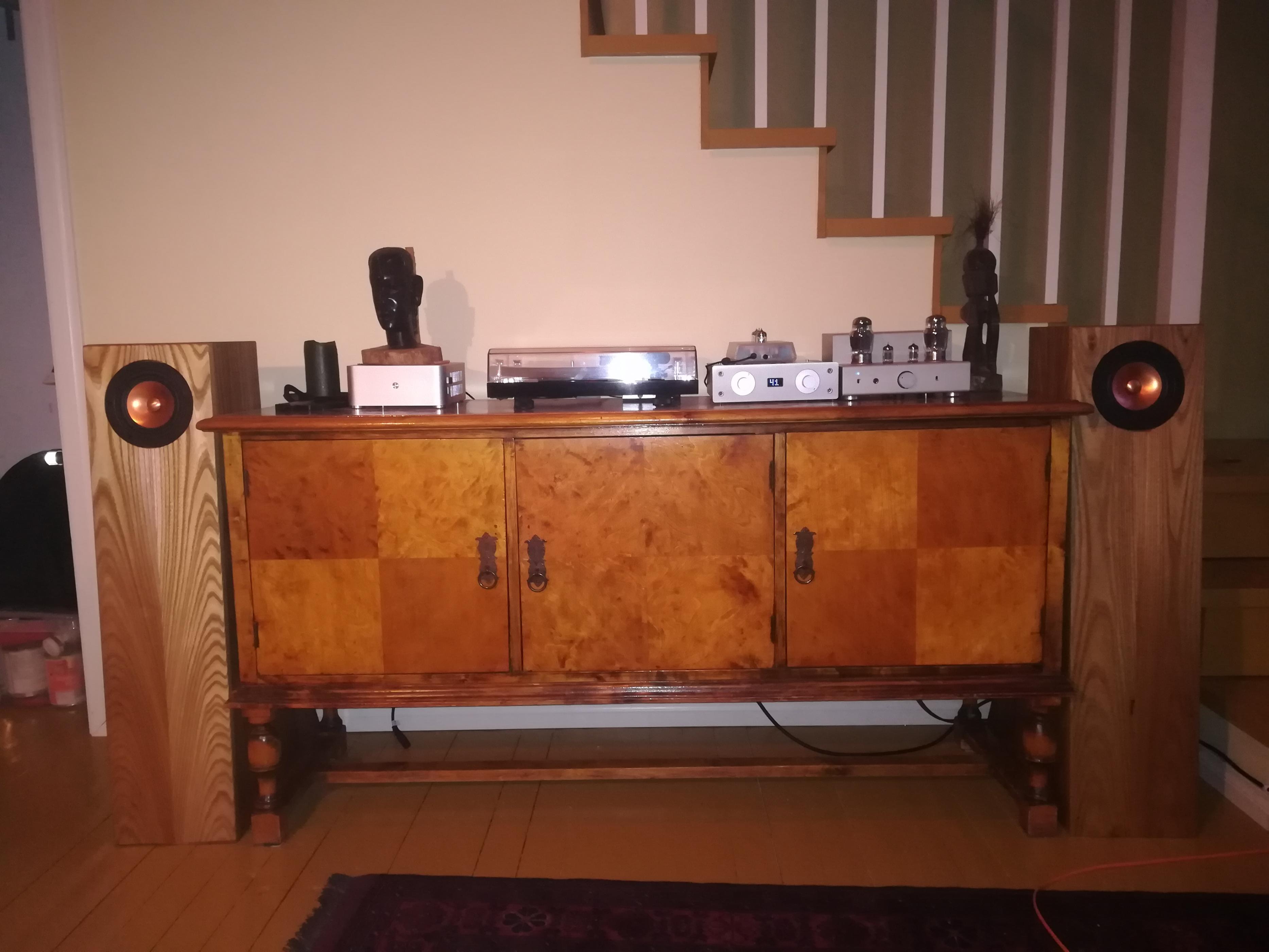

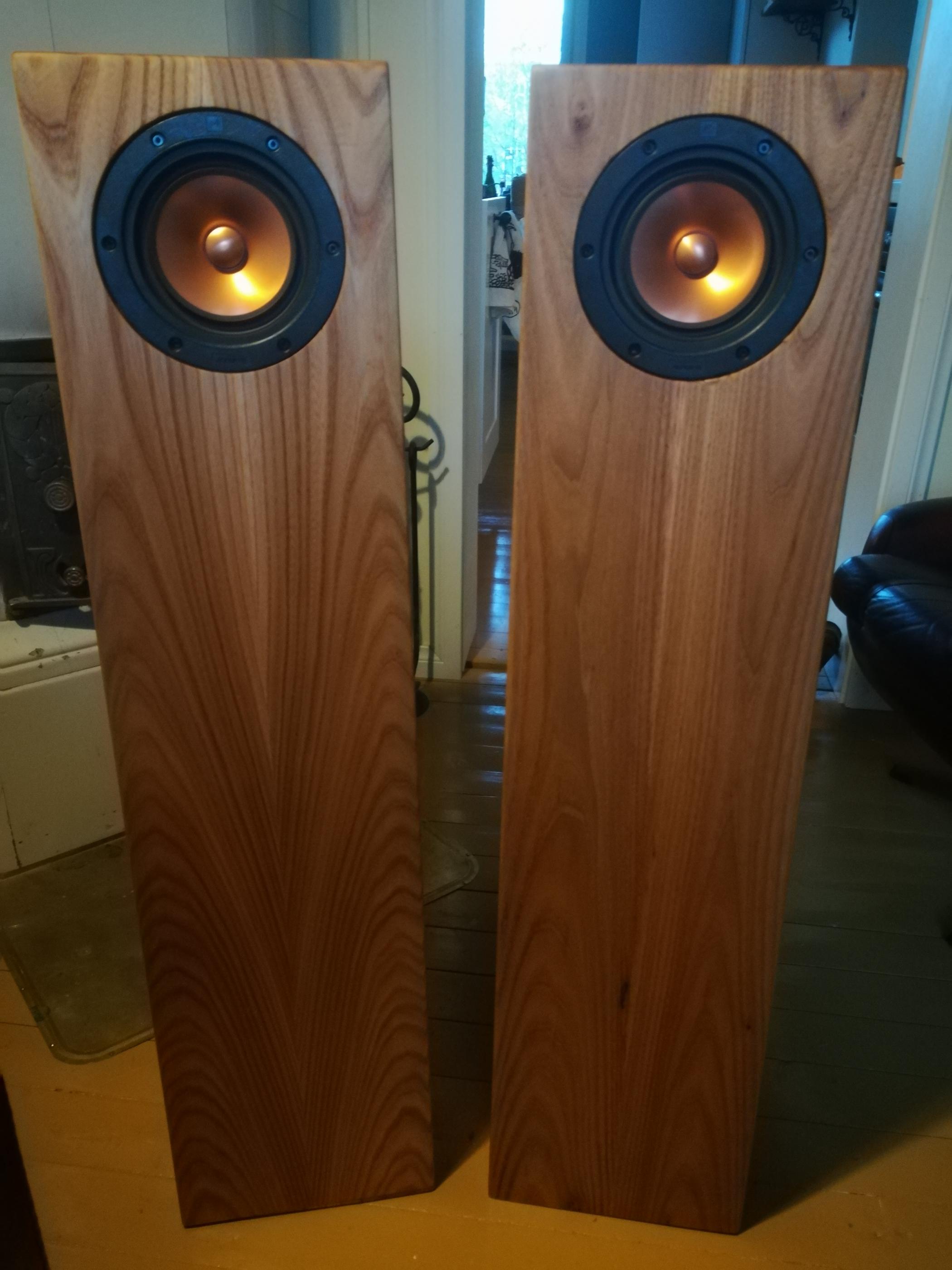

Tung oil applied! The speakers are now basically complete, and I will now spend some time listening and perhaps adjusting with the fillings before taking further finishing steps. There were some glue marks that had gone unnoticed before, so some way still to go before the surface is actually finished.
I was able to make some brief listening tests yesterday. First impression is a bit underwhelming, honestly. Sound seems a bit muffled to me, like the singer would be positioned behind the furniture you see in the picture, instead of in front of it. The drivers are not really properly broken in yet, so hopefully things will improve as they get more use.

Looking gorgeous - yes, often those glue marks only show up after finish is applied, which is why I test with lacquer thinners first. Since I veneer with iron on yellow glue, the solvent won't affect the adhesion, and it vapes off fairly quickly.
As for the muffled sound - how may hours playing time on them?
Maybe get them out from the wall a bit -I like at least a foot myself.

As Chris has already advised, please try bringing the speakers away from the wall; you might also need to adjust the stuffing a bit.

LOVE that grain down the front baffle! Just awesome! Since your finish is only oil right now, you *might* get away with gently sanding down the glue spot and then carefully applying oil to the freshly sanded area to blend it back in. I would recommend practicing this on a left over scrap first to see how things go.
Looking at your images, I can't see the spots you are referring to, so maybe they are not as bad as you think...

As for the sound, I already experimented with the placement a bit and giving the speakers a bit of breathing room both from the wall and the cupboard did improve things. I wonder how they would sound in a larger room... The drivers have been used with moderate volume for 30-40 hours so far, so they are still in early phases of the break-in period. That is why I'm not terribly worried about their performance yet. It is certainly not only negative impressions about the sound so far anyway, on occasion they sound quite fabulous actually. Yet I can't help but notice the singers being very often a bit buried in the mix (I would have expected a change to the opposite direction), and a "tin box" - type of overall restrained sound that is more obvious on some recordings than others.
I think I will be able to sand out the glue marks, and re-apply oil without leaving visible blemishes. You have to give them a moderately close inspection to notice them, as Eric kindly pointed out. =) The marks are in fact visible in the first photo on the vertical front baffle seam, as light streaks. I'll let some time pass and keep track of how many guests notice them. =) On the other hand, the fact that I notice every time I look will probably motivate me to fix it at some point...

With only 30-40 hours playing time, you've got many times that yet before they're fully broken in, and can make final assessment as to fill levels.

They should be pulled out such that the chest/rank is behind the baffle.
