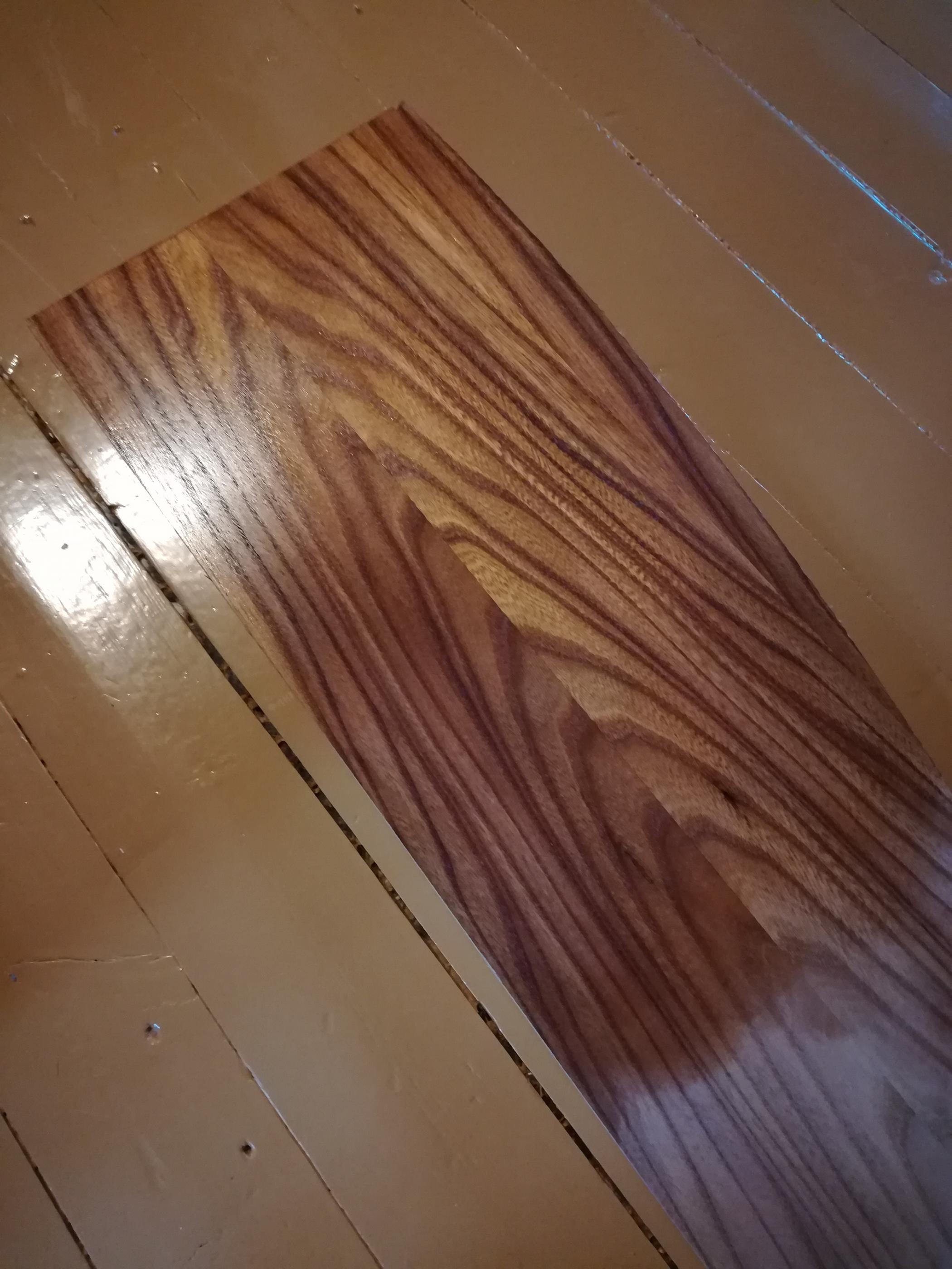

My FHXL project is slowly taking shape. I have all the components I need, now all is needed is some time with tools and elbow grease. I was able to get the majority of the wooden parts made at a friend's shop, so I didn't have to learn veneering at this time. There will be enough work on the assembly and making sure everything fits right, I'm sure.

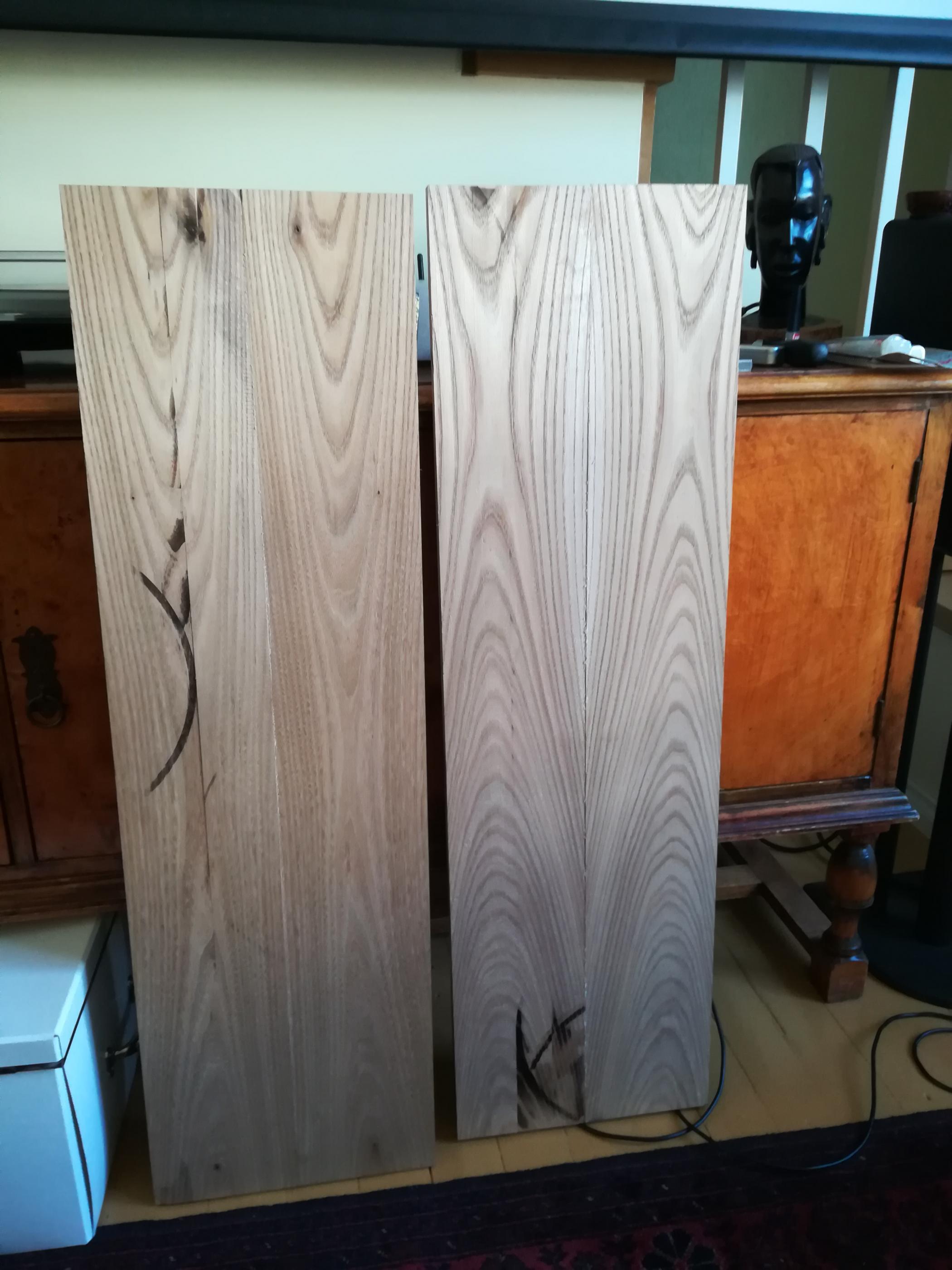

The baffles I made out of an elm plank. In the picture they have not yet been cut into final shape nor finished, so some nasty saw marks are still showing. The other parts will be elm-veneered birch plywood. Let's see how well the woods match, since the solid wood and veneer might have a bit of a difference in tones. If the difference is too noticeable, I will probably stain the baffle to a darker colour, I think the contrast might work quite well.
Meanwhile, back at home a pair of Alpairs is playing mellow classical music to an empty apartment. =)

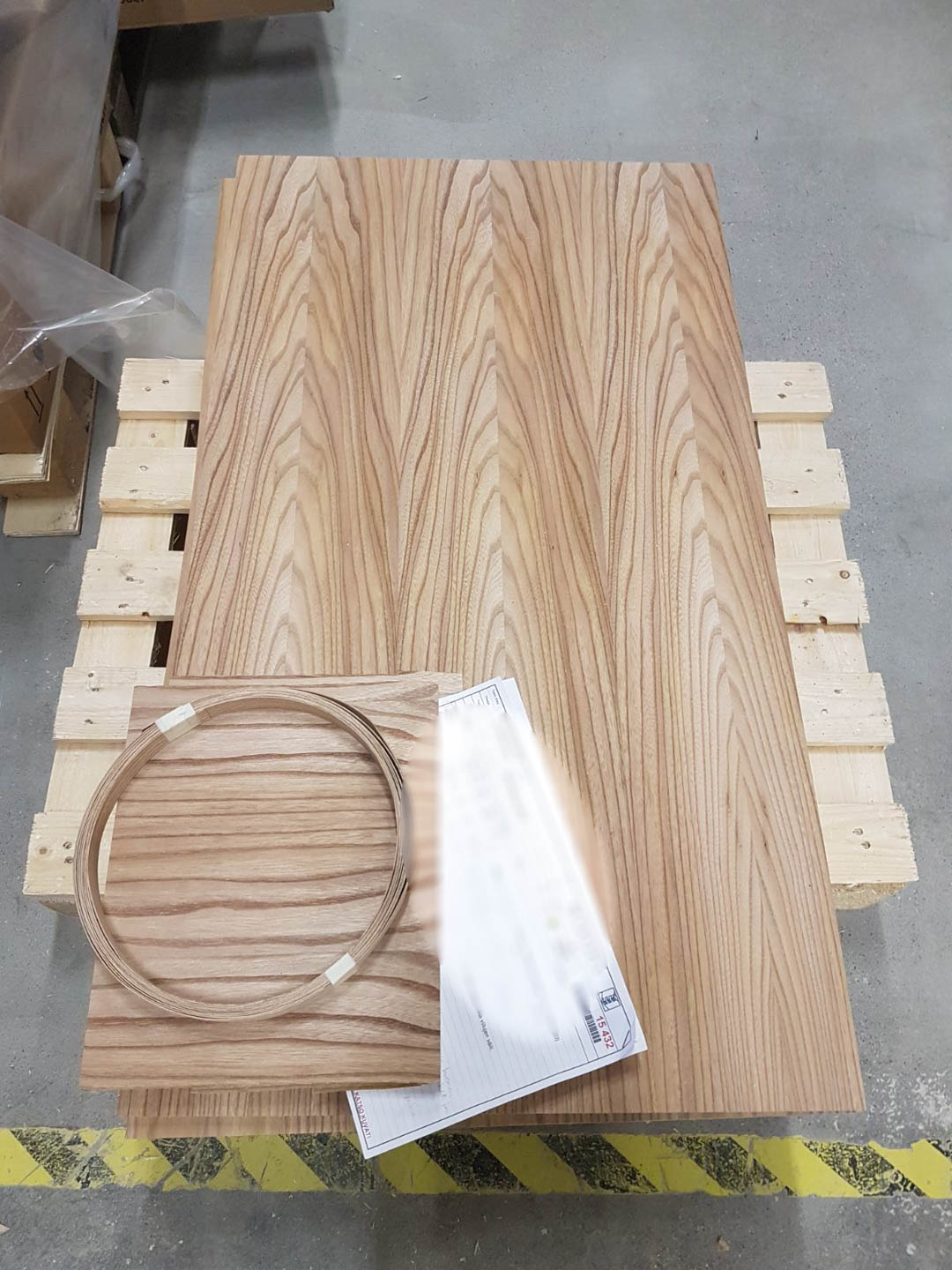

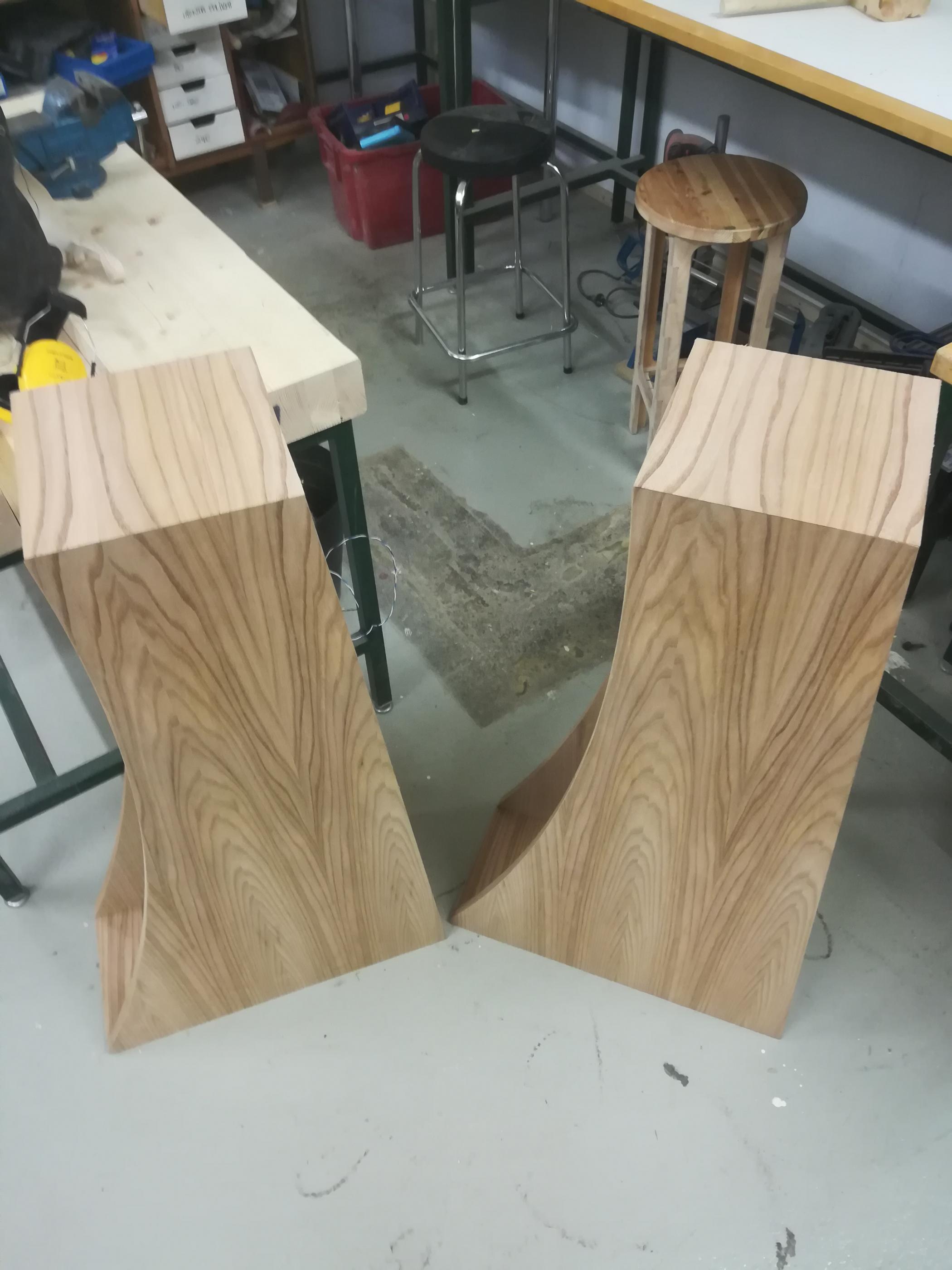

Still working on my pair. Slowly but surely getting there, though. Cutting the driver holes will be the next step, after which it will be time for final assembly and finishing. Latest finishing experiments start to look promising!

Nikodemuzz - Wow! What a nice looking veneer - those are sharp! It looks like your cabinets are already closed up and you say the cutting driver holes is your next step. It will be helpful to chamfer the backside of those driver cutouts, which can be difficult once things are closed up. But, if you used a 50-80 grit sanding drum and your electric drill, the job is still very easy. Check the images I have posed here.
Thanks Eric! The elm has a really lively grain, and the matching of the veneer over the top section turned out really nice. I am attaching the front baffles last, so they are not yet on. The plan is to make the driver holes before attaching them. I'm using a plank of solid wood as a baffle, in a similar manner to your speakers actually. I didn't put an extra layer of plywood underneath, though.
Thanks for the chamfering tips! To be honest, I don't really follow as to why the backside needs to be chamfered? If it is needed, then thanks for the heads up! Doing that before the cabinets are sealed will be much easier.

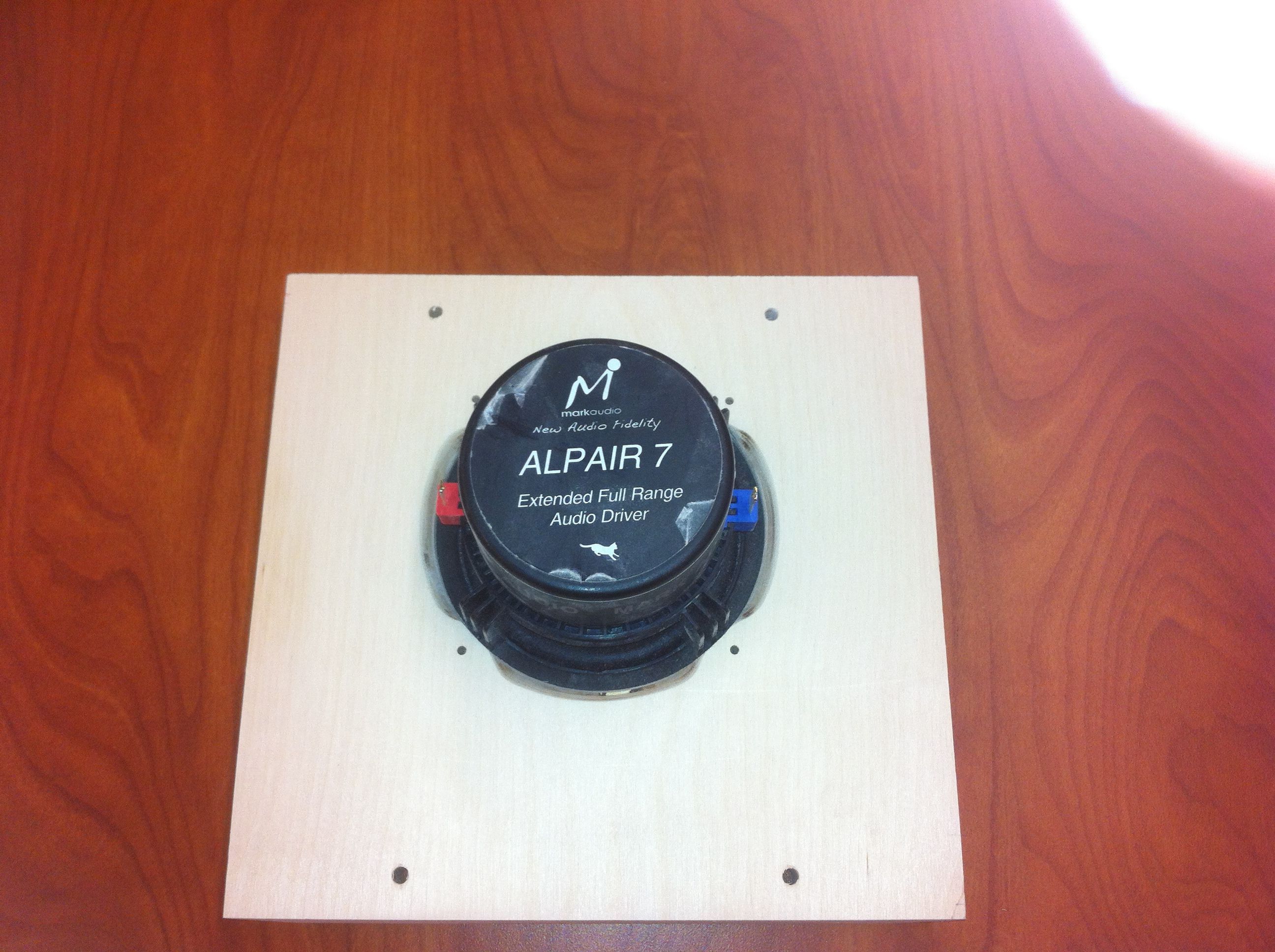

The purpose of chamfering the rear side of openings for full range drivers is to reduce as much as possible cavity resonances and diffraction / reflection at the internal edge. The paper or metal cones of full range drivers are generally very light weight, and in many cases the total cone profile is shallow enough that much of it would be bounded by the walls of the through hole - particularly if drivers are not recessed for flush mounting.
Admittedly, with the spacing of the screw mounting holes in the Alpair's bezels, there's not a lot of clearance to the edge of cut-out, but I've had lots of success in scalloping the chamfers to create small pads at the screw locations.
Attached photo is of A7 - which is even shallower than the 10s - but you get the idea.

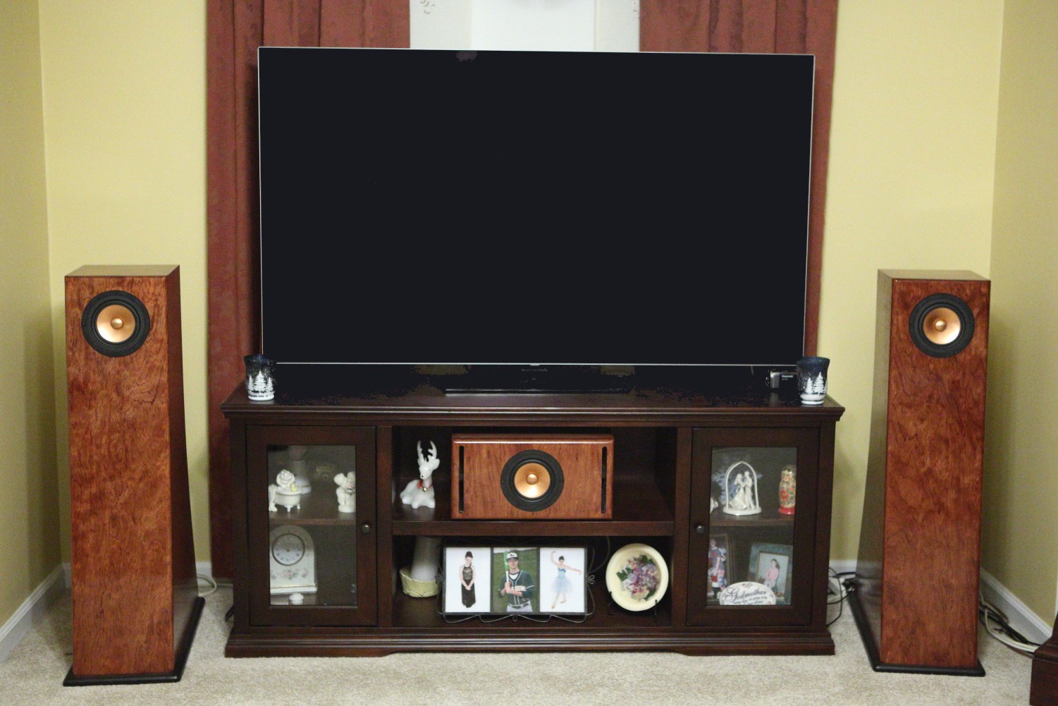

This is not one of my greatest images images (it was late and dark and I was trying to avoid using flash) but here is my LCR array. The center speaker design came from Dave and can be found here:
Thanks for the explanation, it makes sense now.
Alpair 10 Center Designs
Looks very nice indeed!

Thanks, guys! Figured Bubinga indeed - though a few of you followed my build thread from last summer 😉 Just wanted to show them in their native habitat..

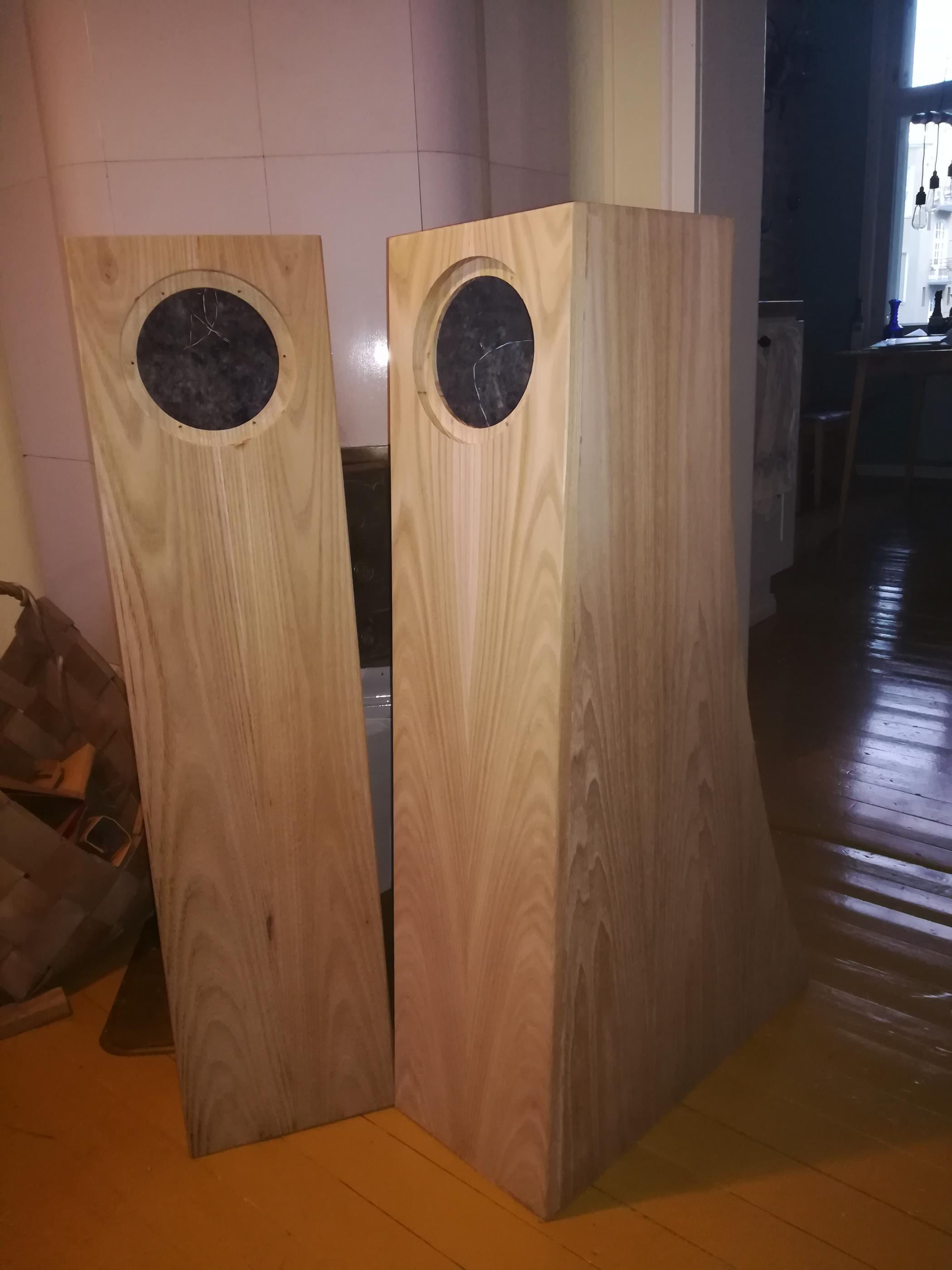

Another progress update. =) The driver holes have appeared on the baffles, and the cabinets are now sealed. I have not done the chamfers (at least yet), because I was worried that there would be too little material left in the flange where the driver is attached. The material thickness I have there is around 6mm with the flush mounting. It seems adequate to me, and the plans show the driver flush mounted on the 18mm baffle as well. Am I worrying about nothing when I'm anxious about the rigidity of the mounting flange if I remove more material?
Anyway, there is still a ton of sanding to do, as well as some small touch ups before I can move to finishing. But I feel as though a large milestone has been reached!

What beauties - love that grain! Are you planning on a clear or colored finish for them? I'll defer to Chris and Dave on chamfering if you only have 6mm of material left, but my thought is to leave well enough alone here...
