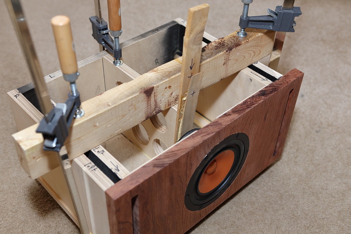

I've tended to use a more simple holey brace than the full-blown recommended brace. The recommended brace not only couples the front baffle panel to the rear panel, but in many cases has a cut-out which couples the back of the driver to the rear panel as well.
I've found it difficult in the past to get the depth between rear of driver and rear panel correct...if the brace is not deep enough it doesn't couple with the back of the driver, if brace is too deep you cant get the driver in deep enough to the baffle.
My compromise is to create one section of brace from bottom of cab to bottom of driver (off center to the left) and a second short section of brace from the top of the driver to the top of the cab (off center to the right). Simply determine the depth of the cabinet and cut the depth of the brace accordingly.

Once again thank you all for the input, it’s something I’ll do after the cabinet is built, sounds a Little challenging, might have to get a bigger hammer as carpenters say, anyway thanks again.....
It is a little difficult to match the brace to the back of the driver, so I made up the difference from brace to back of driver this way, I made sure there was at least 1/8" difference between the two, put some silicone on brace , small bit of wax paper on silicone then mounted driver-- until silicon set up. done.

Fitting the brace between the rear of the cabinet and the rear of the driver was a bit of a trick for me when I build my center channel. I ended up cutting the brace a bit short and using a pair of wooden shims with a bit of glue. I screwed the driver in place, then adjusted the shims so that they were nice and snug. I don't think I would have been able to do it any other way - there are too many variables for me to get an accurate measure.
Eric - yup, those "just snug enough" fits are a royal pain, and the clamping arrangement looks vaguely familiar
frazier - I'm not sure the cured silicone would provide the rigid coupling that Dave has in mind for those braces kissing the driver magnets.
I've used piano front rail key punchings (shims). Easy to fine tune 🙂 the fit. They're about 7/8" dia. Key Shims – Vintage Vibe. If you know a piano tuner they may give you a few. You could put 2 or 3 stacks in a row.
I've found that up to a couple of layers of none glued veneer edge tape, or even scraps of paper backed veneer - both approx .5mm thick - can work quite well.

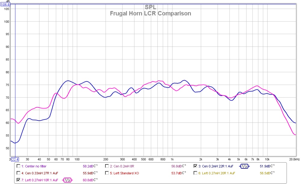

Just spent some time tweaking my filter network for my FH 10.3 center speaker and the FHXL 10.3 left and right speakers. As per usual with my graphs, please ignore the dB scale on the left hand side of the response plots. The point is merely to compare the relative SPL across the frequency range. Listening reveals that these speakers are indistinguishable from one another.
I just keep getting more and more impressed with this design! One thing that stands out: these drivers are very revealing - poor quality broadcasts/recordings just don't get any love. But throw on a well recorded CD or album and they just come alive! Wow! 😀
