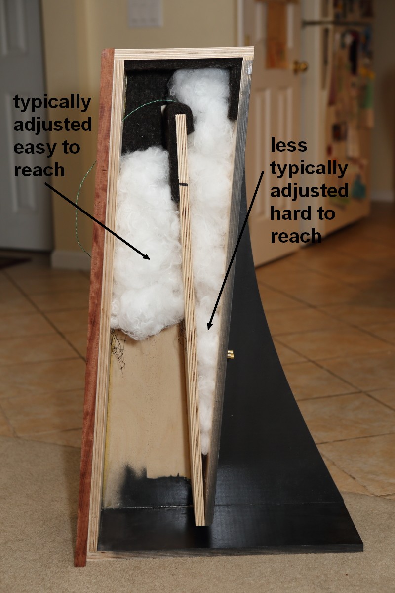

1- You can stick your hand through the driver hole to adjust stuffing

Typically, it is the stuffing "below" the driver that is adjusted. This is easy to reach through the driver hole and is just on the other side of the front baffle. You'll need a "net" of some sort to keep the stuffing from falling down where it doesn't belong. This is what most typically gets adjusted.
The construction advice for stuffing the top of the horn "above" the driver (the folded part behind the driver that is on the other side of the rear baffle) is to stuff equal amounts into the tapered length of the space. Thus, stuffing is most dense at the "point" - the farthest distance from the driver and stuffing is least dense closest to the driver. This spot is not typically adjusted and is harder to get to once the cabinet is sealed.

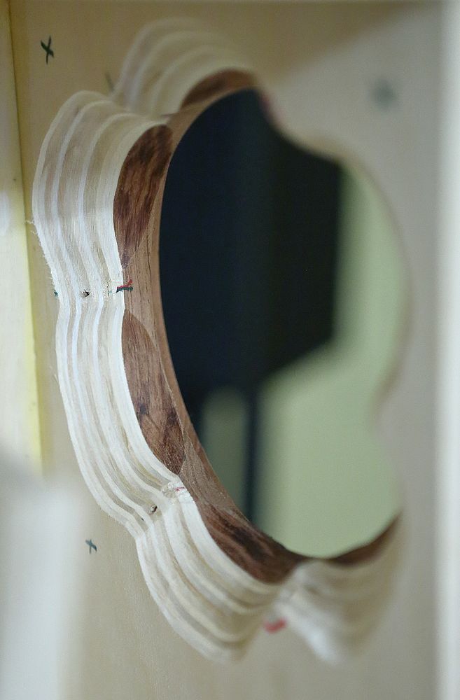

1- Box is all glued up, driver screws directly in the wood. A pilot hole is a great idea. On the behind of the driver hole, you chamfer for breathing all around, except where the screws go, so you have more meat there.

Here is an image of chamfering to open up some space for the rear of the driver. My front baffle is 1.5" thick, so this was a necessity. You can see where I left more wood intact (and the holes that were drilled) for where the screws will attach.

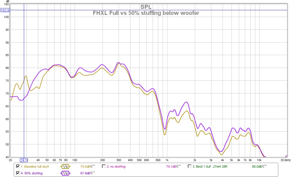

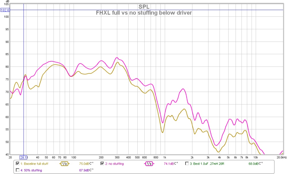

While we are on the topic of stuffing, here is what I measured from my FHXL in my room. 100% stuffing (gold line in both images), 50% stuffing, and no stuffing "below" the driver. These measurements were made with the mic at the bottom rear of the cabinet. I get more bass with less stuffing, but I also get a larger peak around 1-2kHz and again from 5-8kHz... everything is a tradeoff. Pick the one that best suits you.
