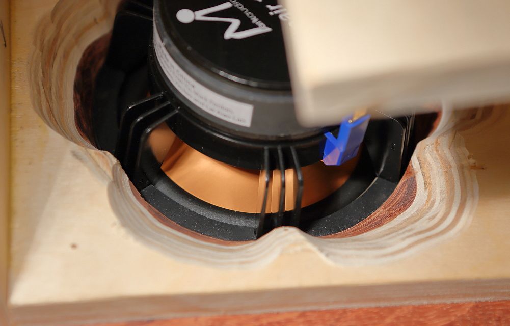

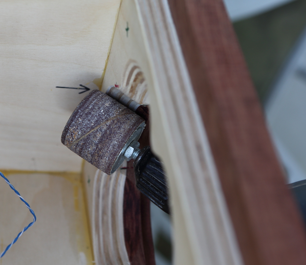

Yep, that lip needs to be removed...

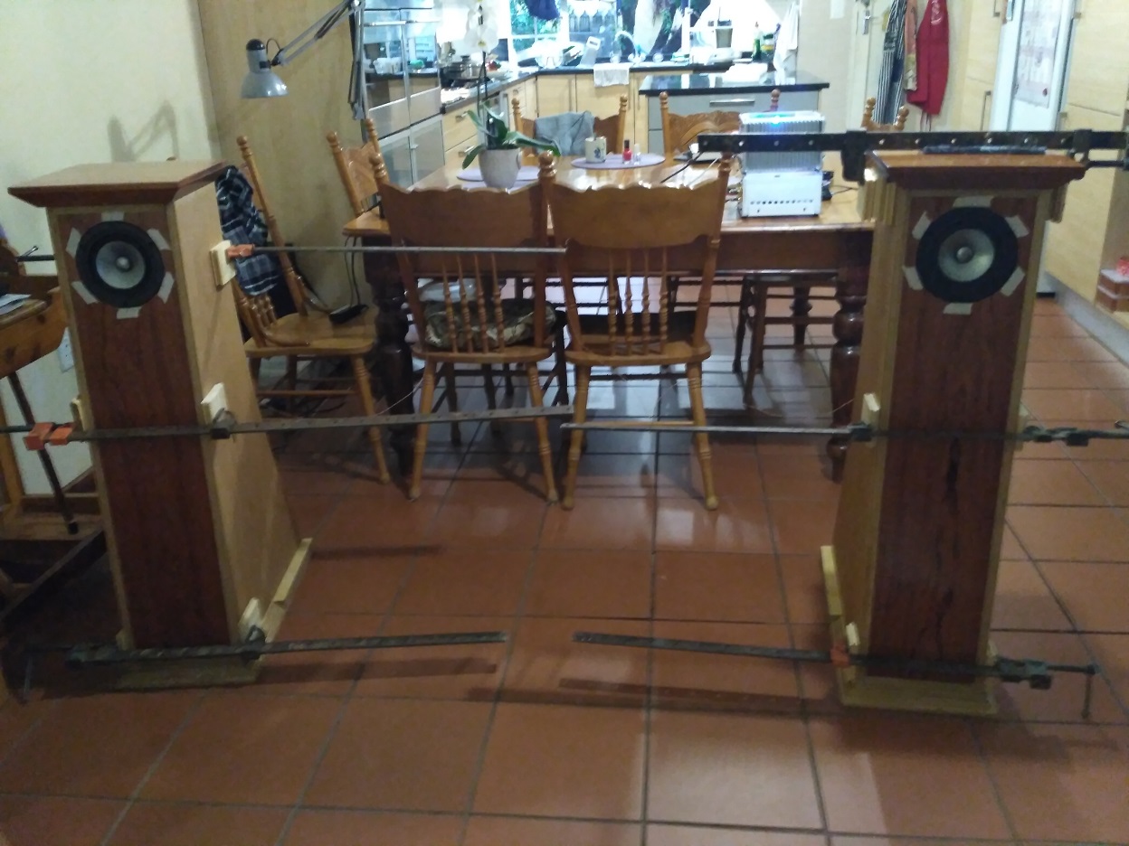

We finally finished my brother-in-law’s FHXLs (with Alpair 10.3) this weekend. I had the opportunity to test them at my house with my setup two weeks ago. That was to adjust the stuffing before they were finally glued together. The drivers were broken in for about 200 hours prior to installation.
In my small house and driving them with my ACA (and Aksa Lender preamp) they sounded absolutely fantastic and much better than anticipated - the detail, the depth, the soundstage, the imaging, the bigness, the bass, the beautiful midrange and vocals. The first photo shows them temporarily clamped up and being tested. A few friends came over for listening impressions and all were blown away. And I fell in love with these Alpair 10.3 drivers.

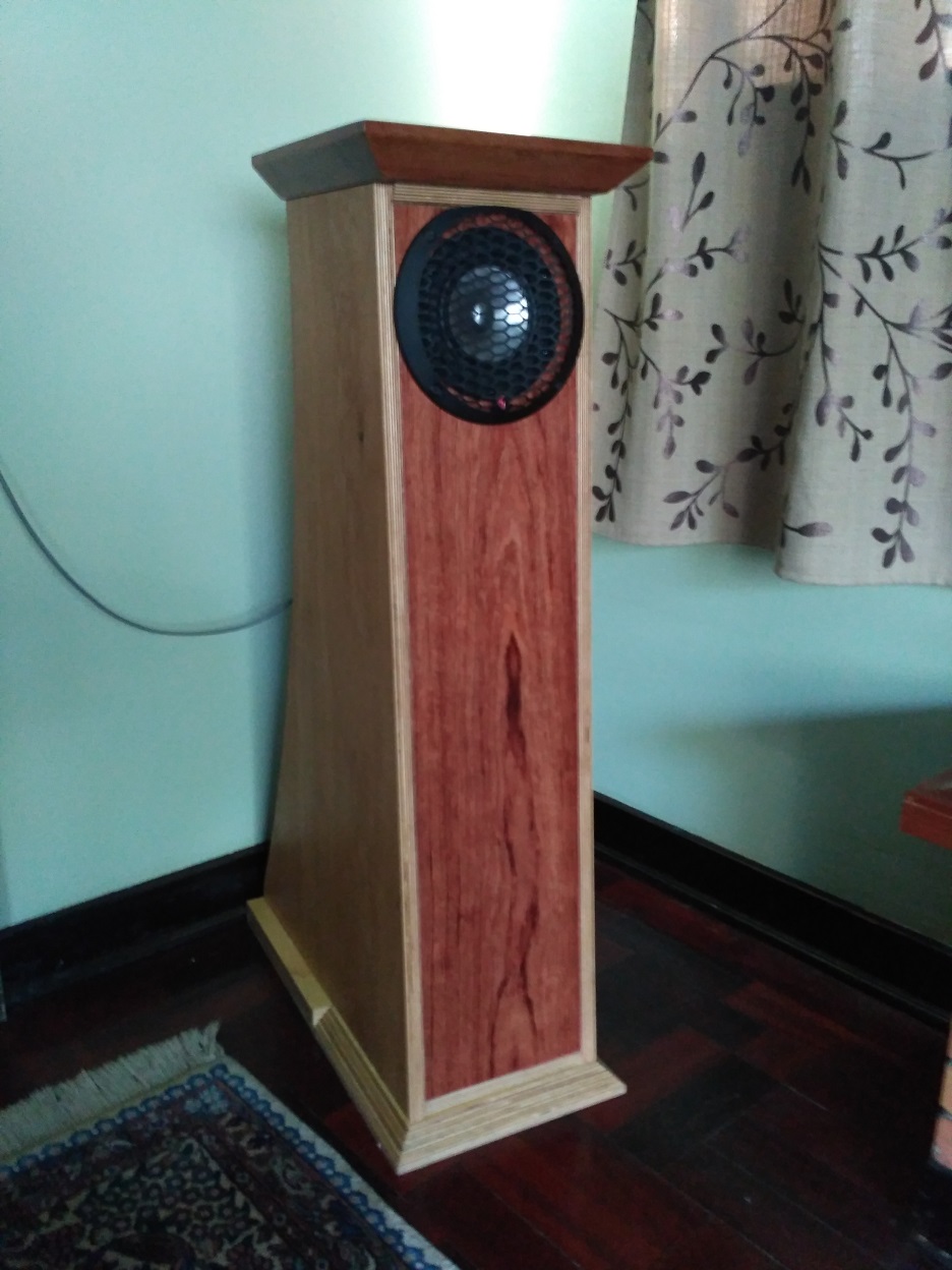

Last photo shows the final result. My brother-in-law did most of the woodwork and it was his idea to add the top to the speakers. He is a creative artist with a carpentry shop. I am not sure if this actually interferes with the sound. Unfortunately we also had to add grills to protect the drivers from inquisitive and exploring fingers. The grand children indented the previous drivers within a few days after installation. The FHXLs replaces FH Lites (with TC9FD) which we built in the beginning of the year.
Russian Birch plywood was used, with Rosewood veneer on the baffle, White Oak veneer on the sides and solid Red Oak for the tops.

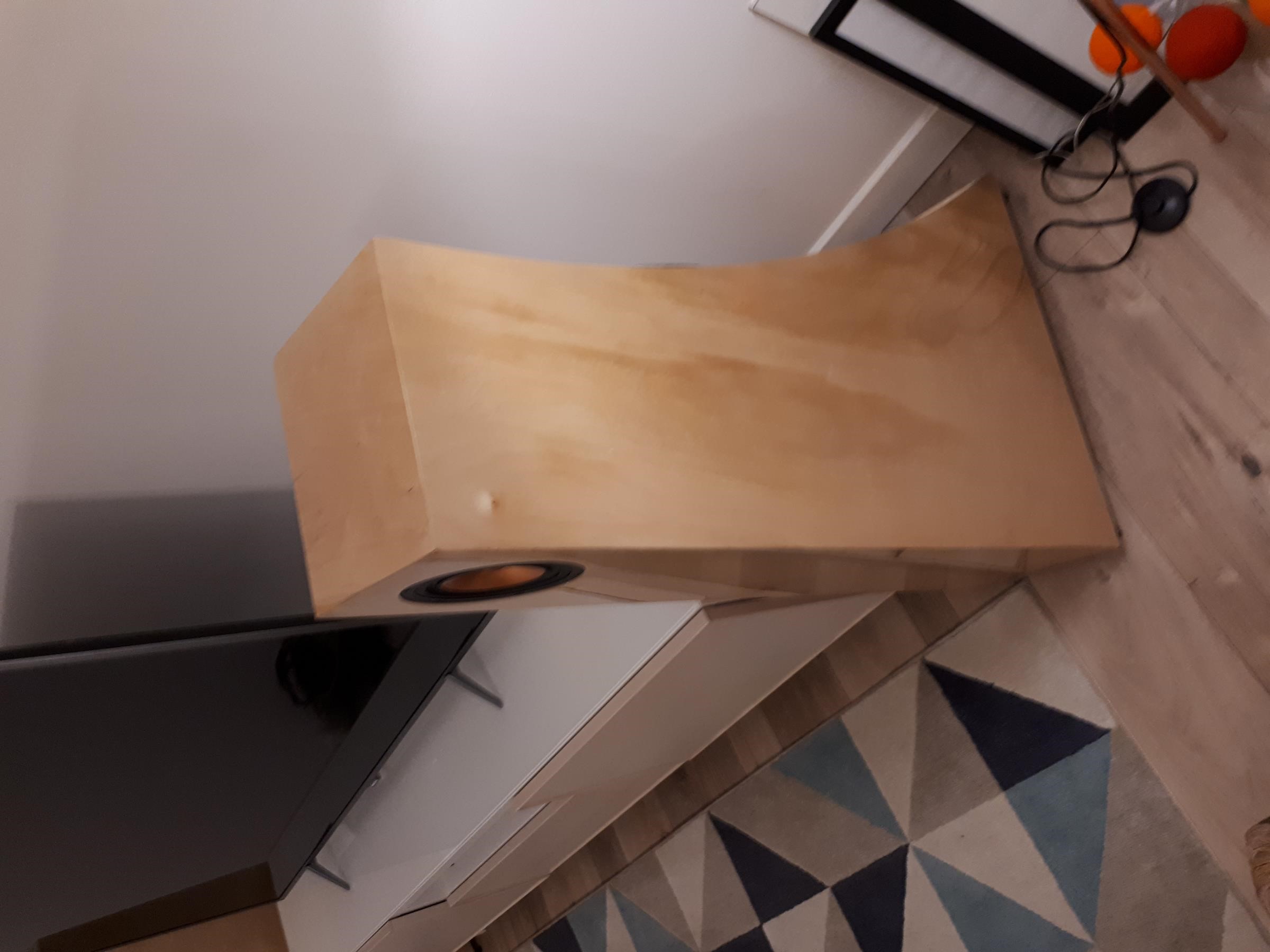

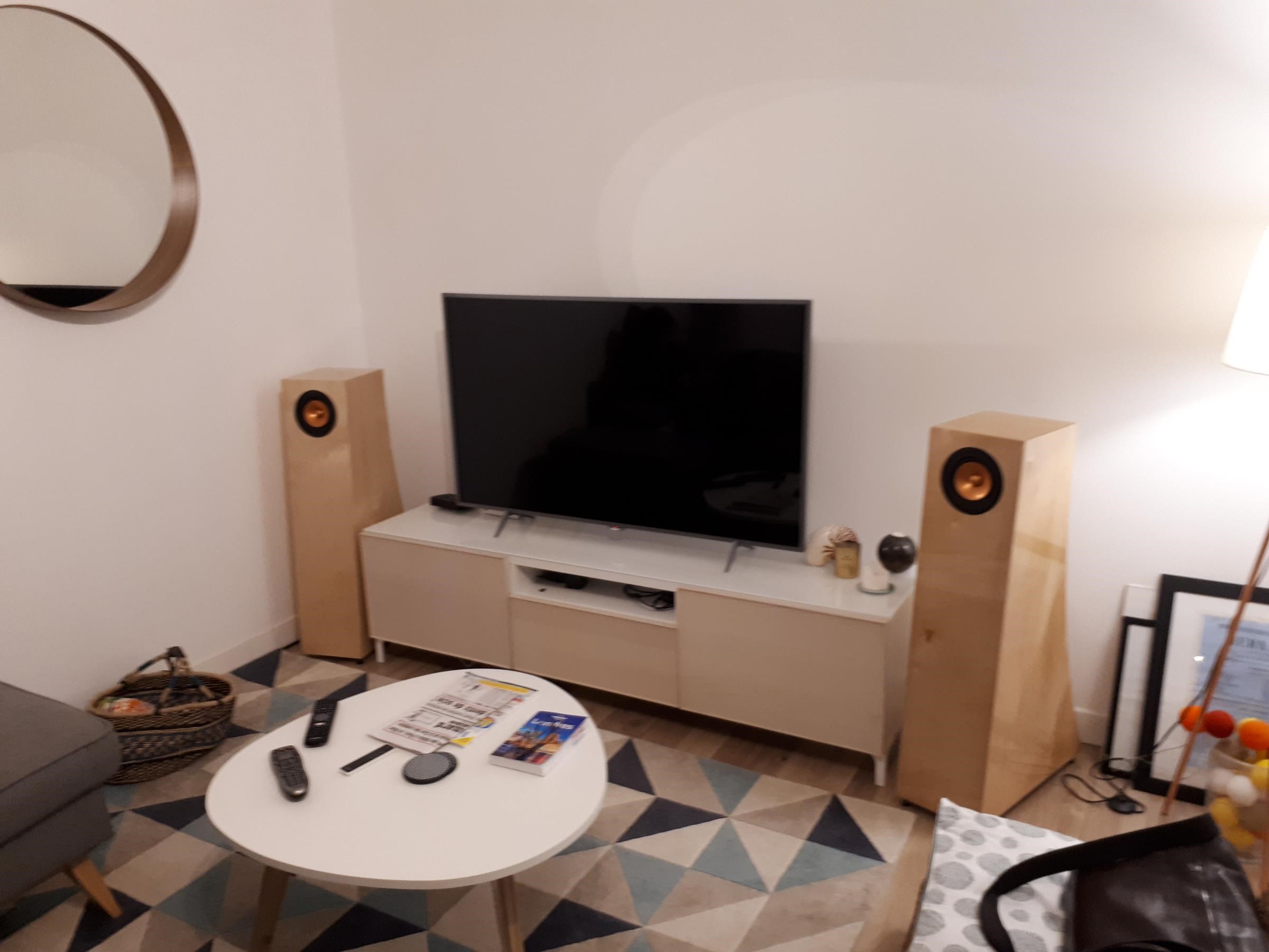

My pair of Frugel Horn XL based on the KJF Audio Flat Pack Kit.
I performed the assembly and let the finish to a professional (D.B Restor Finition at Chatenoy-le-royal France).
For the finish, the following steps were followed: - 2 (crossed) layers of isolating varnish
- Smooth sanding
- 4 crossed layers of incolor polyester varnish font
- Smooth sanding
- 5 crossed layers of incolor polyester varnish
- Polyshing

Yes, these are 10.3.
In my audio system, I use:
-A pair of Frugal Horn XL with Alpair 10.3
-A Ripole subwoofer with two Eminence Kilomax pro 18A
-MiniDSP 2x4 HD with Dirac Live Plugin for room correction / UMIK / Cross over at 120Hz
-Homemade amplifier based on 1 Anaview AMS0100 used in stereo mode to drive the Frugal Horn XL and 1 Anaview ALC0300 mono to drive the Subwoofer
The Frugal Horn replace a pair of Horn using Tang Band W5-2106.
At the moment, they have run only 50h.
I will wait at least until 150h before changing the crossover to (I think to 80 Hz) and to perform measurement and room correction (I use currently the same room correction as for my Tang Band).
For a raw comparison - using my ears - between the Tang Band and the Alpair 10.3, in my particular configuration, I would say that the sound is much more detailed on the whole range (especially medium/high frequencies).
Note: I was already very happy with the Tang Band ;-)
