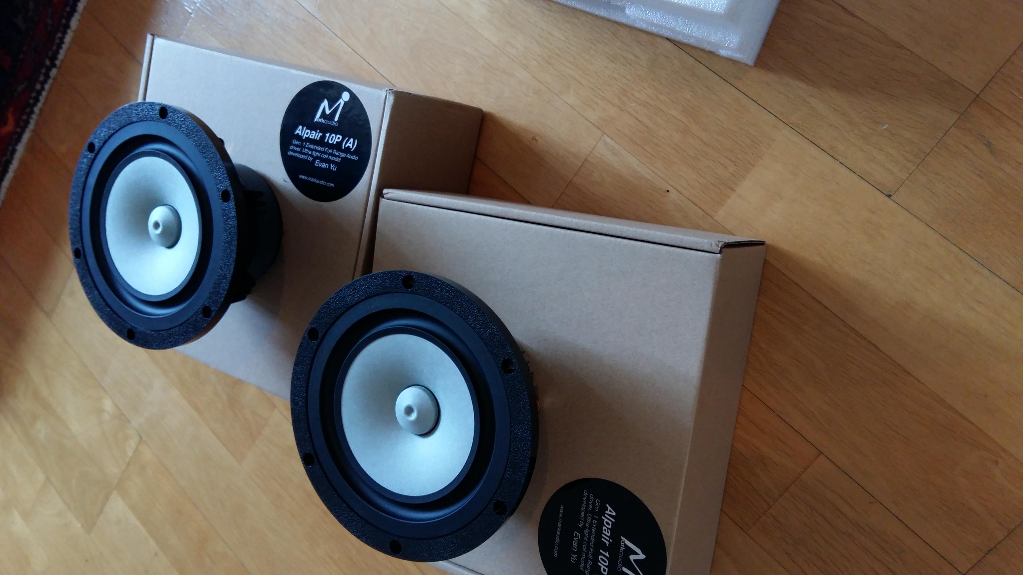

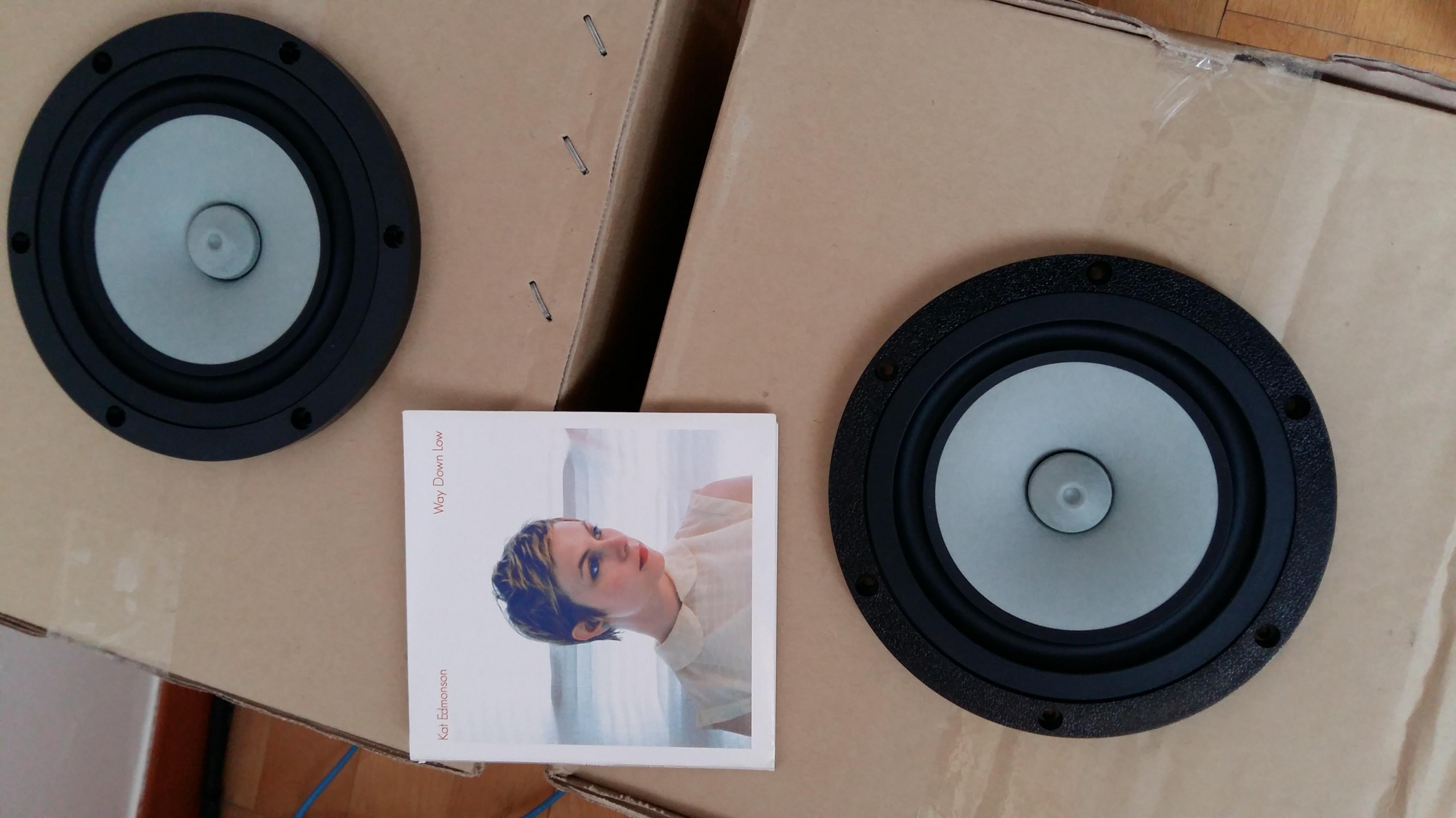

Sean, if you have the floorspace to accommodate the XLs., I doubt you'd regret them. Between the metal and paper cones, I could take either - just decided on the 10Ps as a change in flavor after living with Alpair7s in my small home theatre system for a few years.
Hey SCD, Chris...thanks for your comments. I've toyed with 2 ways but love the coherence of single drivers. I have the floor space. Drivers are on their way direct from HK! Not a lumber store in sight. I think I will be doing the low-level break-in from a couple of card board boxes whilst getting the build materials together. I will post pics but it may be a bit.
