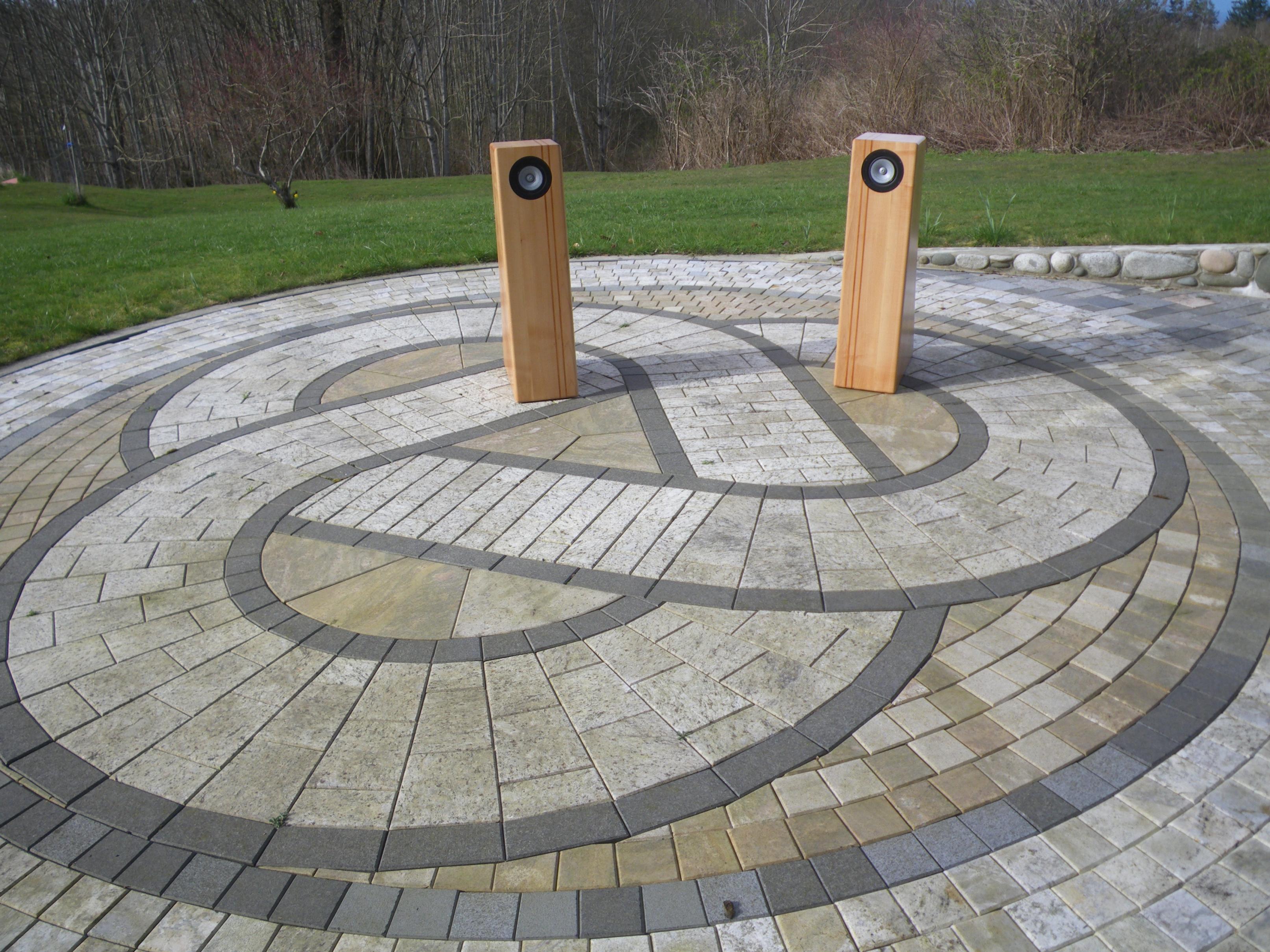

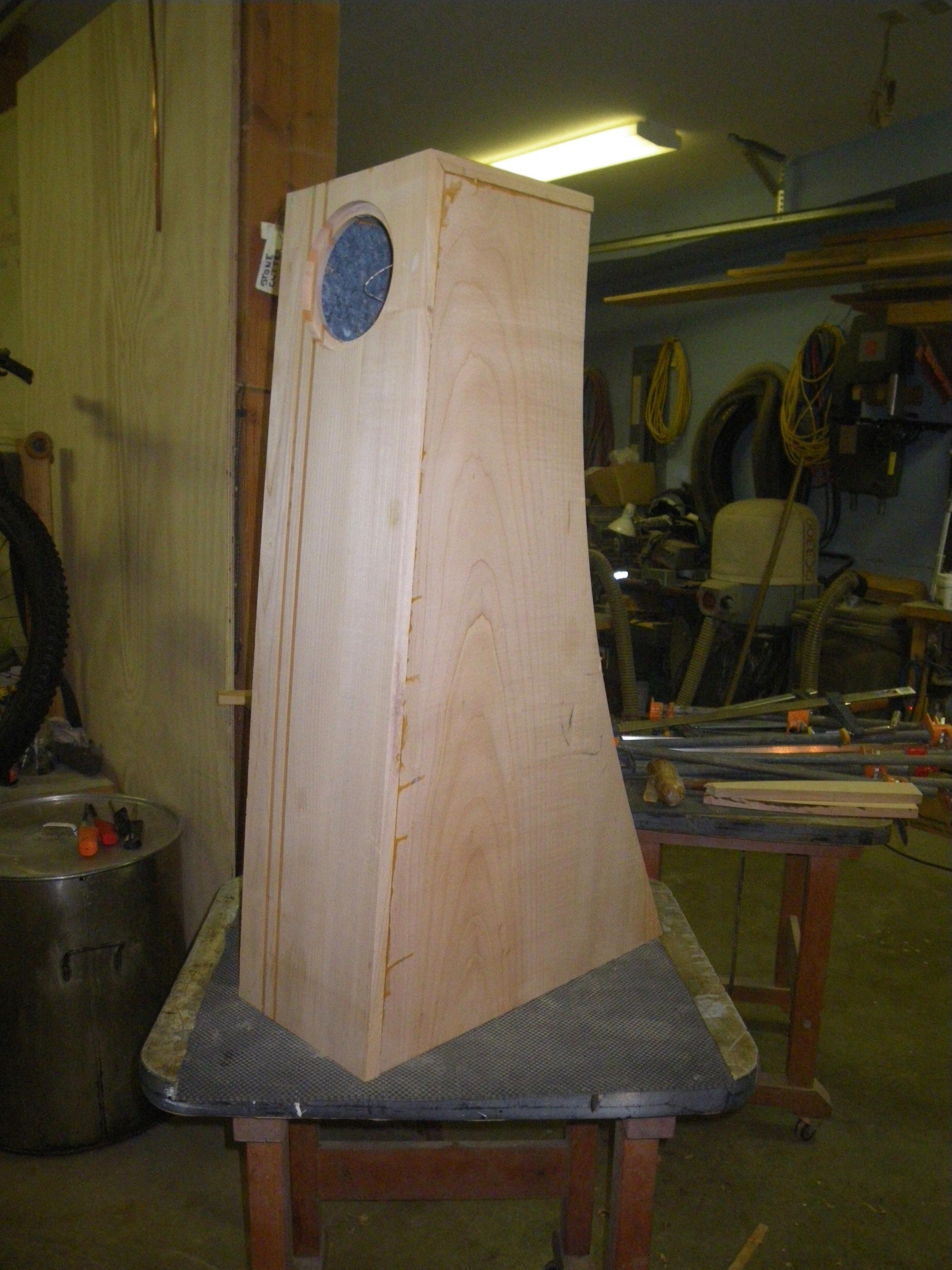

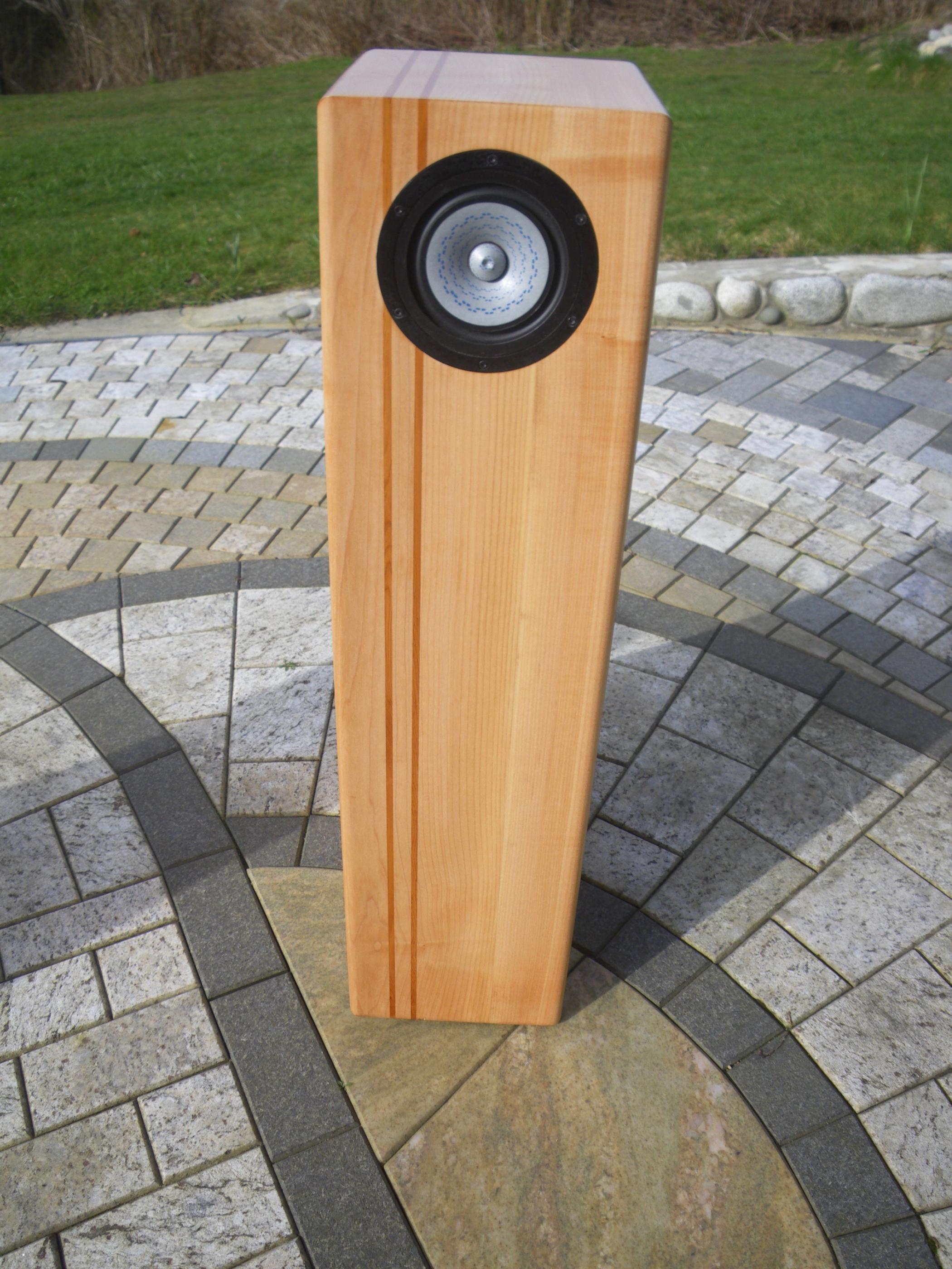

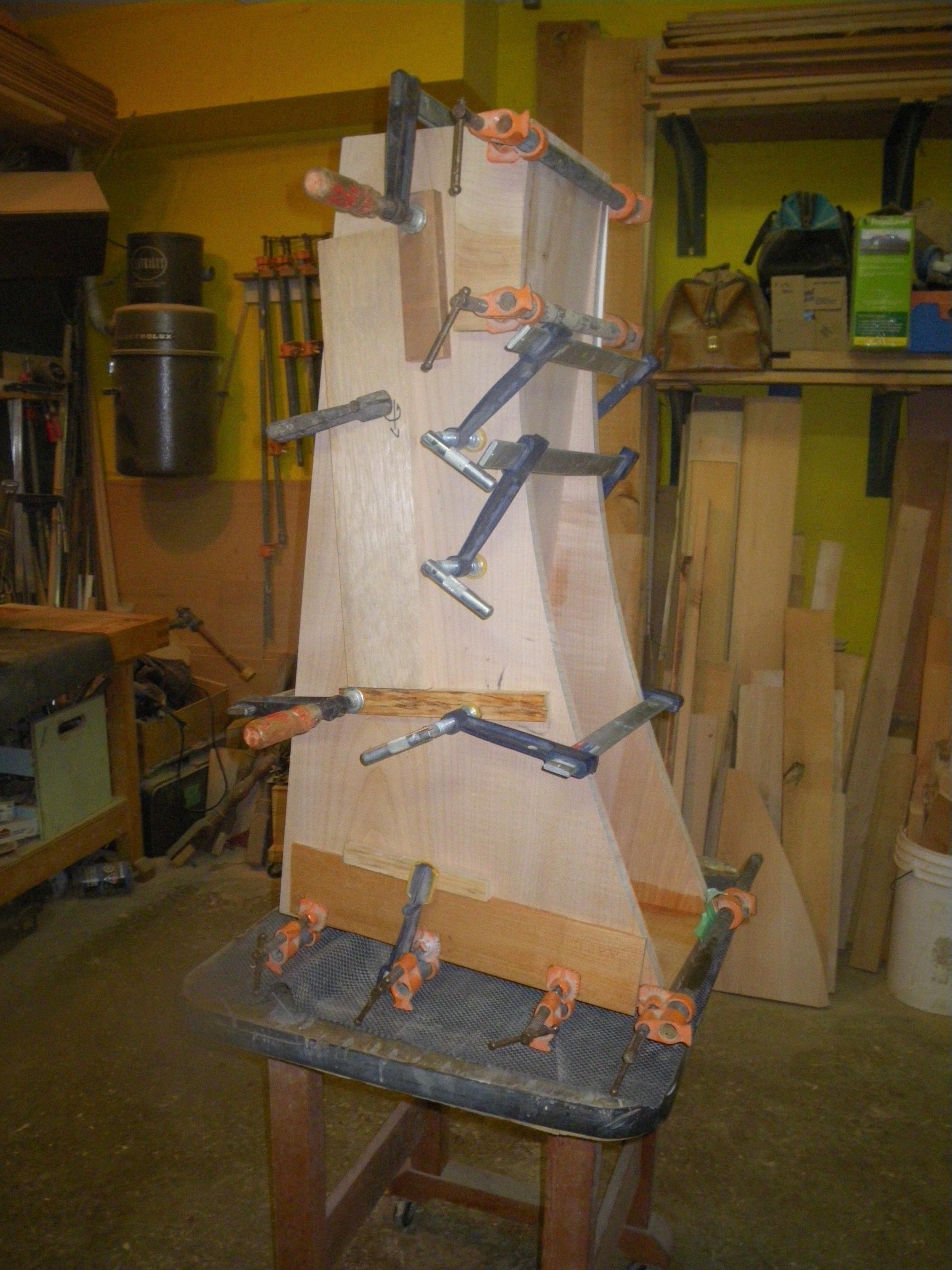

Hello Folks:
I thought you might like to see the set of Frugel-Horn XL that I built. They are made from 3/4inch Big Leaf Maple. The drivers are Alpair A10p EN. I added a few extra braces to help keep the panel resonance to a minimum. I followed the plans from D.Dlugos and added 1/4inch to the width to account for the braces. I and am very happy with the outcome. My wife also likes the look and sound.
Thanks Dave
I also made a set of floor standing Trapezoids for the Alpair A10.3m EN drivers ( separate thread)
