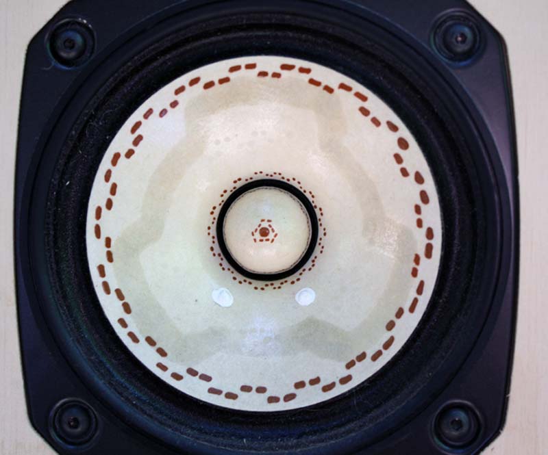

By FE128eN do you mean FE126e, my treated FE126eN, or the new FE126En?

Yup, you are correct, I misremembered; it is of course the enabled FE126 that I bought from Dave at the end of 2011.

This is a link to the drivers I had ordered at the time, so it should be the FE126eN, enabled by planet10: http://www.diyaudio.com/forums/atta...l-vancouver-island-diyfest-2010-a-fe126en-jpg

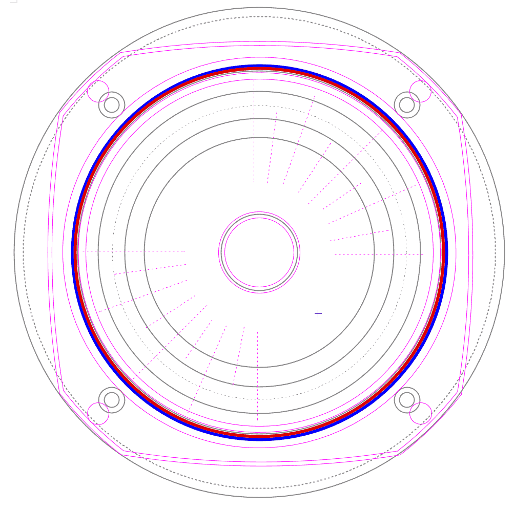

If replacing the FE126 with A7 one needs to do some work.
With thru-holes basically the same (A7 marginally larger) that is not a problem, but the A7 needs a much deeper rebate and that rebate doesn’t quite cover up the ears of the FE126 rebate. One can rotate the A7 screw holes such that one of them is at the top and not run into issues with the FE126 holes.
Blue is A7 thru-hole, red is FE126.
So it can be done, but as i often hear, it is sometimes easier to start from scratch, in this case reaming out the existing baffle and adding a supraBaffle — we now lean to a simple one the width of the baffle.

Thank you for this detailed response, Dave. I may just make two baffles and enlarge the existing cutout per the plans.
