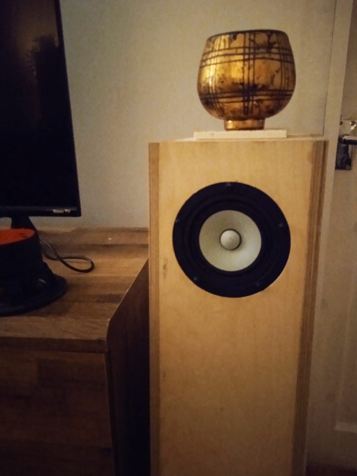

Well interestingly and purely coincidentally I switched in a pair of P7-PHD'S that a friend was selling tonight. And to be fair they are a lotter better than I was expecting, given the polarised opinions with listeners. They were only played for around 15 hours so a way to go until optimum performance.
The CHN-70eN anyway. P7PHD i listened to all the way thru break-in, it did not have the benefits to what i did with the older 4”. There is a thread here where the fellowloves the P7PHD and shows some tweaks that are purported to improve it. I, at the moment, am hanging onto the set i have, just to use the basket fitment at some point.
dave
The midrange is glorious. Just a BIG mid-range hump.
dave
You paint that as a bad thing Dave. I have to be reserved with my thoughts as I have at least a 85 hrs to go. And you know how jumping the gun went for me re. my Pluvia 7 HDs (Metal), so I'm not going to analyse in the same way you can. But I will say the first thing I hear is a lack of sibilance with the paper cone, further I can hear a lifted Mid in comparison, but there is a great bottom end going on as well as top end. As a drummer that's the first areas I'm drawn to.
Just a different presentation is all presently? They do have a promise of a glorious midrange though as you say. As I listen to 98% Jazz, it's obviously personal taste of course. I'm listening to Jazz FM in my 2-storey townhouse here in the UK as I type, and my feet are positively tapping. That is a benefit to me of course for early and late-night listening with neighbours in mind.
I'm really enjoying what I've hearing so far, just as much as the metal coned sister version tbh. In the words of the Vapors song -Turning Japanese I really think so 🙂 Obviously I will keep you posted.

As you say one man's meat is another's leather. It really is early days for me as I may hate them when burnt in? Doing what you're doing is just what I and others need especially with wealth of experience, I myself have benefited from it numerous times. I just felt they sounded nice in practice and yes, I can hear the roll off there at the minute as pointed out and viewed on the FQ plot. I will say I prefer the brilliance of P7 HD off the bat. But that mid of the PHD is something else! It's nice to have both drivers 🙂
I have put a hundred+ hours on the P7PHD's now and can report I have come to the same conclusion as many others. That is as good as they are a super tweeter is beneficial. The midrange though is sublime. Meanwhile the P7HD's are the star of the show and are just getting better and better.
