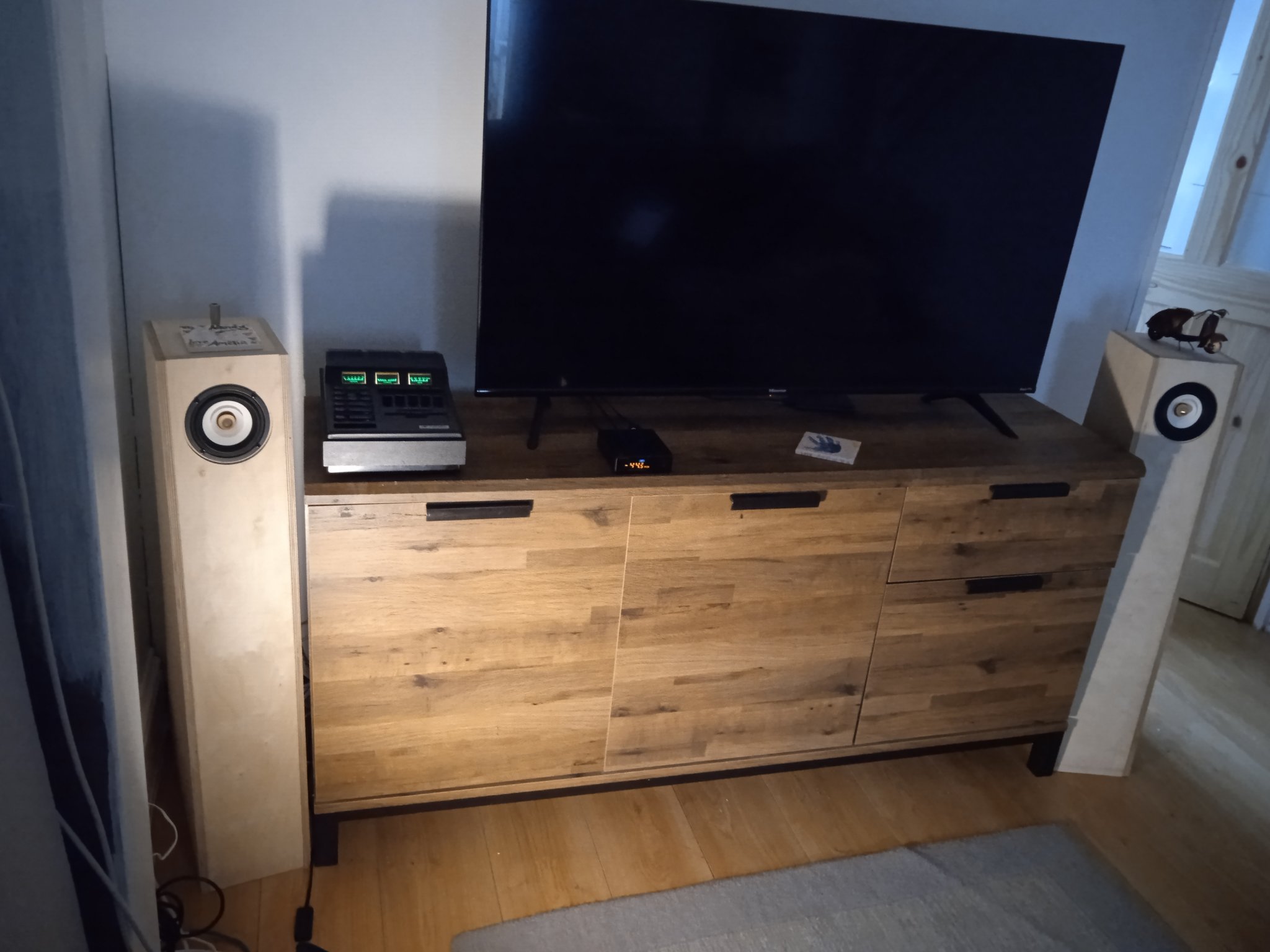

Well, my FH3's are up and running, and what a joy they are. I'm currently using Audio Labs/Aiyima 4" FR drivers with them. The result is very satisfying indeed. After trying all the stuffing permutations, just a small amount of teased polyfil in the choke section was the best compromise. I'm using 18mm birch ply, and so far no major cabinet resonance in the lower registers. An area I am particularly sensitive too.
Here you go. as you can see they are still in the completed build finish. I have some ideas of finish and when done will provide futher pictures. They weren't any more difficult to build than the tqwts I have built. Let me know your thoughts Material is AB grade 18mm Birch Plywood.👏
Pictures, please
I deleted the test videos as I thought folks would prefer to see them now they are complete.Here you go. as you can see they are still in the completed build finish. I have some ideas of finish and when done will provide futher pictures. They weren't any more difficult to build than the tqwts I have built. Let me know your thoughts Material is AB grade 18mm Birch
