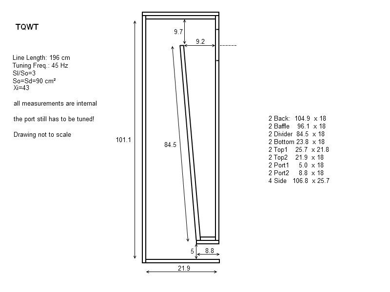

any thoughts on this one? I find it interesting with the downward/floor firing exit allows you to essentially tune the size of the exit to your liking for any given driver used... Might it have better bass esp with room corner placement?

The shape of a Voigt pushes the harmonics down in freqiency making them harder to kill. Mass-Loading really helps, from there driver position and the damping.
A poor one will have a ton of ripple, a well done one nice.
To explore the challenges of getting damping right with no mass-loading, see the challenges that BIB builders have had.
dave
Reactions: GM and gnat_leader

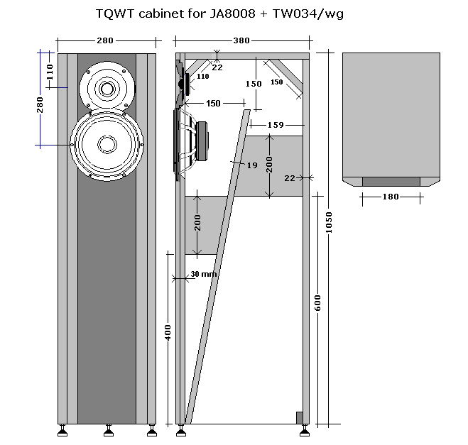

so in general then forward exit like this is better?
