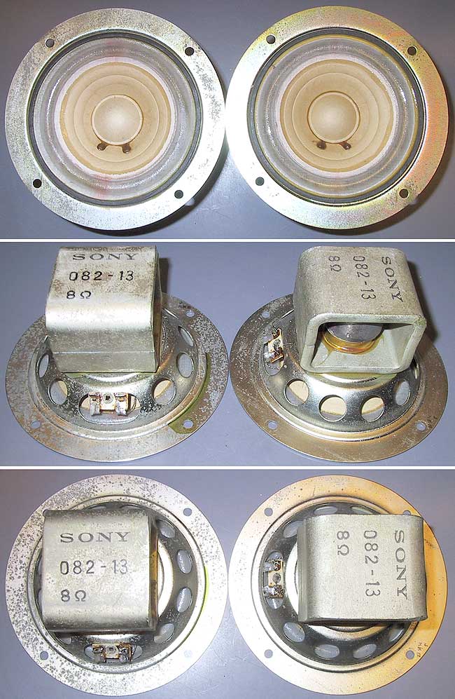

That's pretty cool. I've never heard of these, but FHmk3 are my first journey into DIYaudio projects.Joan is the big one, then FHXL, FH Mk3, FH-Lite.
Holey basket Corals would go into FH3. These are almong the best of the FE103A class 4” FRs.
Found in Sony TC500 Tapecorder, and Monarch had a model with 2x16Ω versions. Tapecorder has good oarts for making EL84 class SE amps.
Unfortunately often come with SSS (Stiff Surround Syndrome).

Hi there,That's pretty cool. I've never heard of these, but FHmk3 are my first journey into DIYaudio projects.
You'll find that the MA CHP-70s are at the very least equivalent to the Holey Baskets and probably much better with the lower frequencies.
I've been listening to mine for 11 years now and am still very satisfied indeed.

Remind me, CHP70, or CHP70.2?
Given the numbe of Corals with SSS and the reach of teh CHP-70.1, the comment about the bottom is likely spot on.

Hi Dave,
They are the original CHP-70 drive units I bought them from Spectrum Audio in Germany, at the time the only place that stocked them in Europe. Wolfgang with whom I exchanged emails with was very helpful indeed. Until I listened to these I thought my Grado headphones were better than any loudspeaker.
