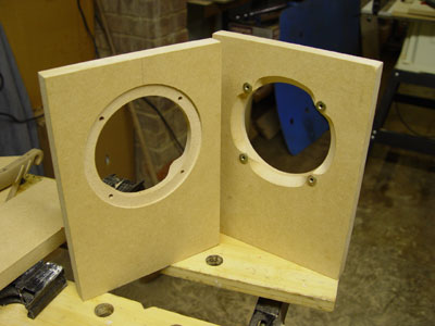

Took me a while to decipher this since I haven't understood all the diy language, but I think I got it. I understand that the bezel is wanted/required on the inside. However, the driver cutout on the outside, is this required other than the fact that it looks better when the driver isn't protuding out? I have a feeling it will be difficult to do this cutout with the tools I have at hand.
Fredrik, just to help you visualize the terminology - see the attached photo. On the left you see the front of the baffle with a rebate - for the speaker driver to be mounted flush with the front of the baffle. On the right you see the back of the baffle with a chamfer - a 45 degree cutout at the back between the mounting bolts. Both are important for better sound.
Jerry - thanks for the picture - says it all
It should be noted that not all “full-range” drivers require the rebate - i.e. those with thinner / tapered flanges such as many of the Fostex, Mark Audio Pluvias and CHN70, and probably other.
However, with the very shallow cones and total mounting depth, I think all should have the chamfer / bevel to rear side of cut-out to avoid cavity resonance.
Thanks, these kind of pictures help 🙂
