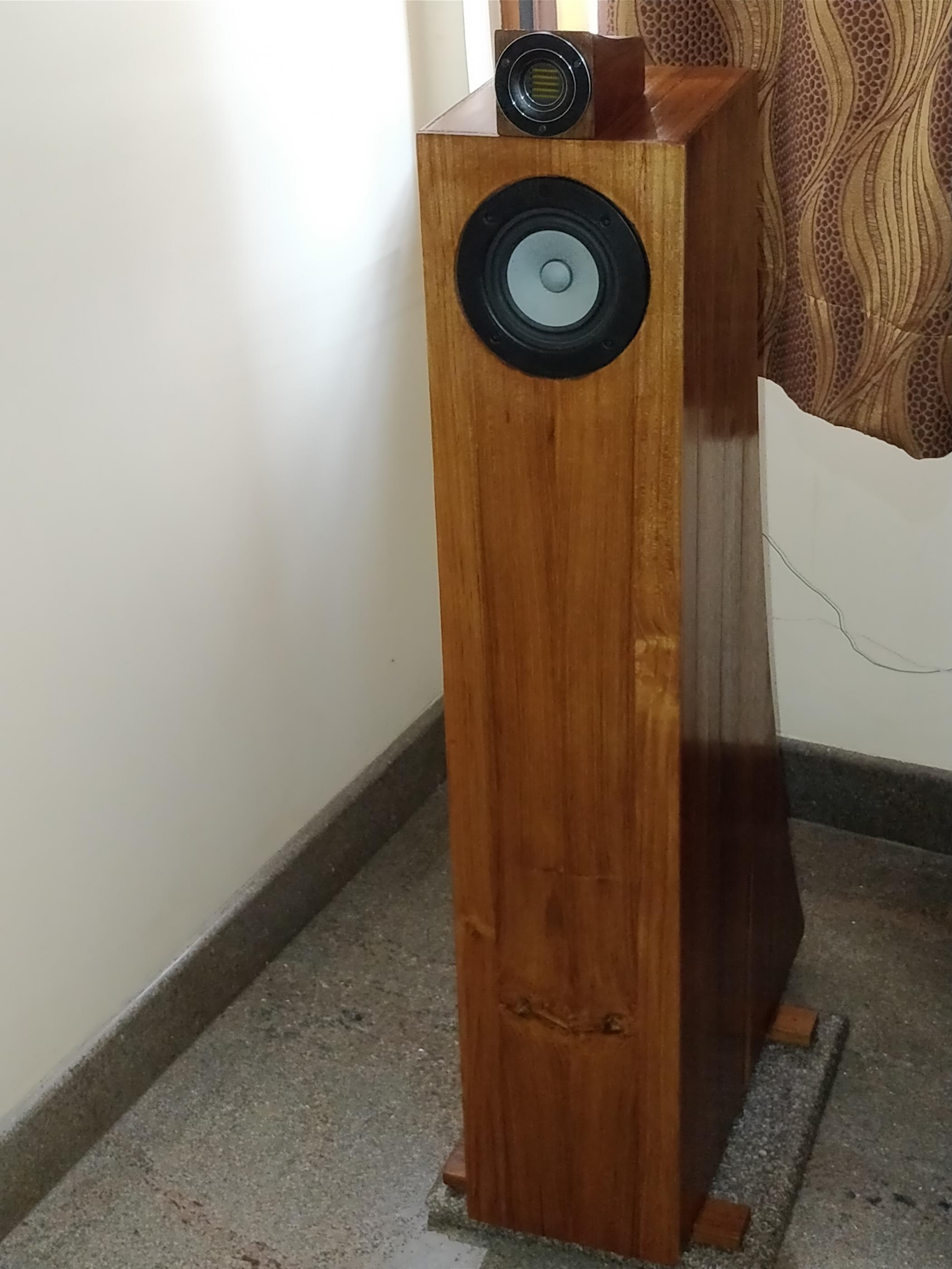

Was busy with finishing the exterior of my MK3 and super tweeter and hence the delay in try out of the CAT5 IC. The exterior has really taken a lot of effort and labor out of me. Instead of using Veneer I decided to clean my attic of Teak wood strips left over from my house construction. Had them cut and planed to about 7 mm thick strips. These were then stuck on the MDF cabinets, sanded, sealed, polished, sanded, sealed, pol... several times. The Tweeter is housed in a small teak block shaped quite nicely (also with the 5deg tilt) and also polished to a finish.
After this I have tried out the CAT6 (23 AWG) IC.. with a pair of twisted pairs for each side. Have kept it short to avoid picking up noise. Sounds simply sublime - no disturbance.

Looks like your hard work has paid dividends, and you have a very nice looking speaker there. Also happy to know that the sound is to your satisfaction. Enjoy the fruits of your labour! 🙂
