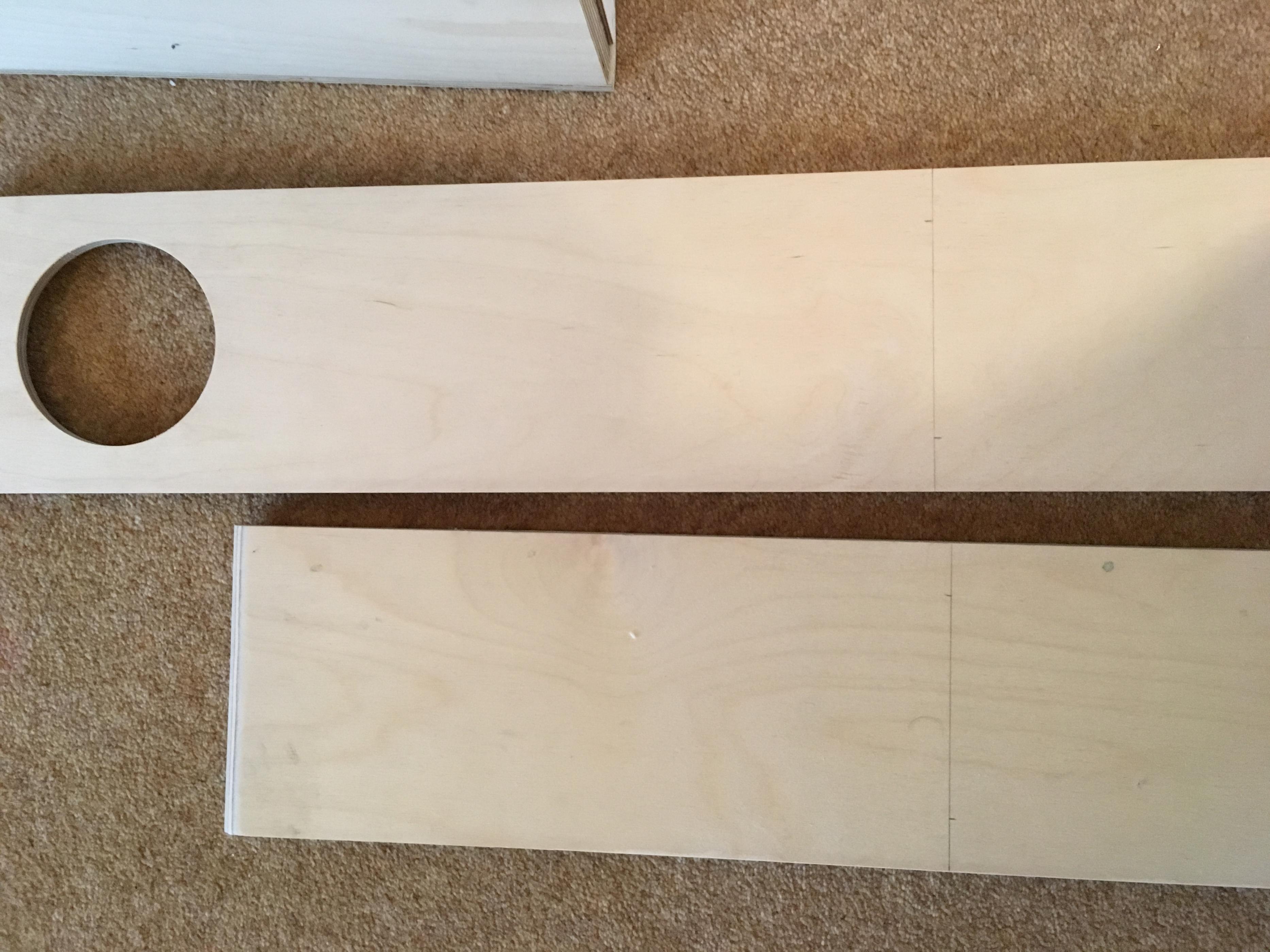

Hmm... the front of the Alpairs, when fitted with the finshing rings are flush with the front of the ply.
The rear has not been cut back at all and from a mechanical perspective I would not want to trim it to much. I guess I have the option of a supra baffle although I have no idea what diffeence this would make.
I went with a supra baffle. The air movement from the back of the driver needs to be unimpeded into the enclosure. I recessed the driver on the front of the baffle and cut my rebates where the driver would need them and left plenty of baffle for the mounting hardware.

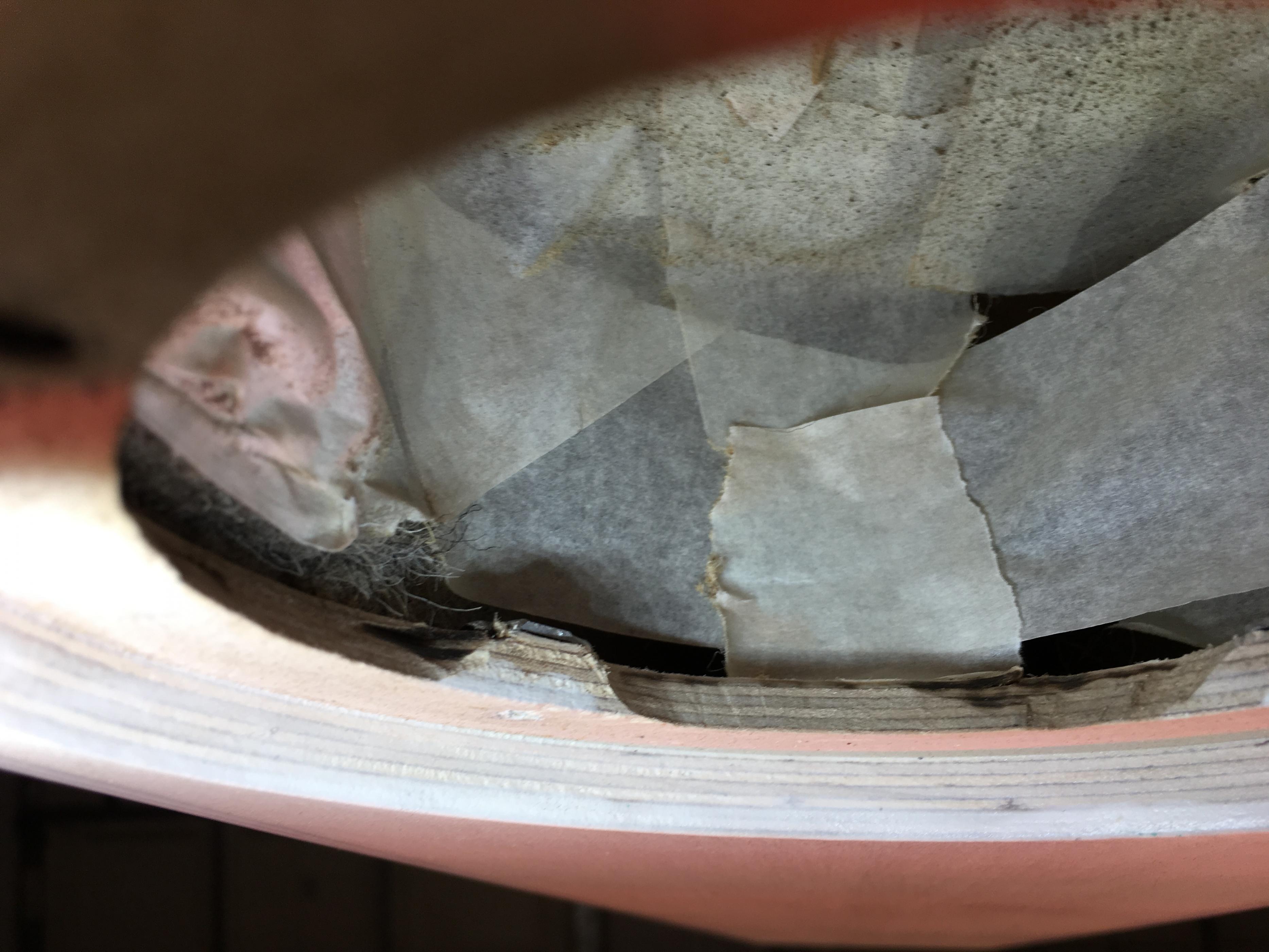

I have just popped the drivers and if you take account of the depth of the wood you are only left with about 10mm of gap around the perimeter. No way I,ll get the router in there now. I wonder if I could dremel it?
Do you really think it will make a huge difference?

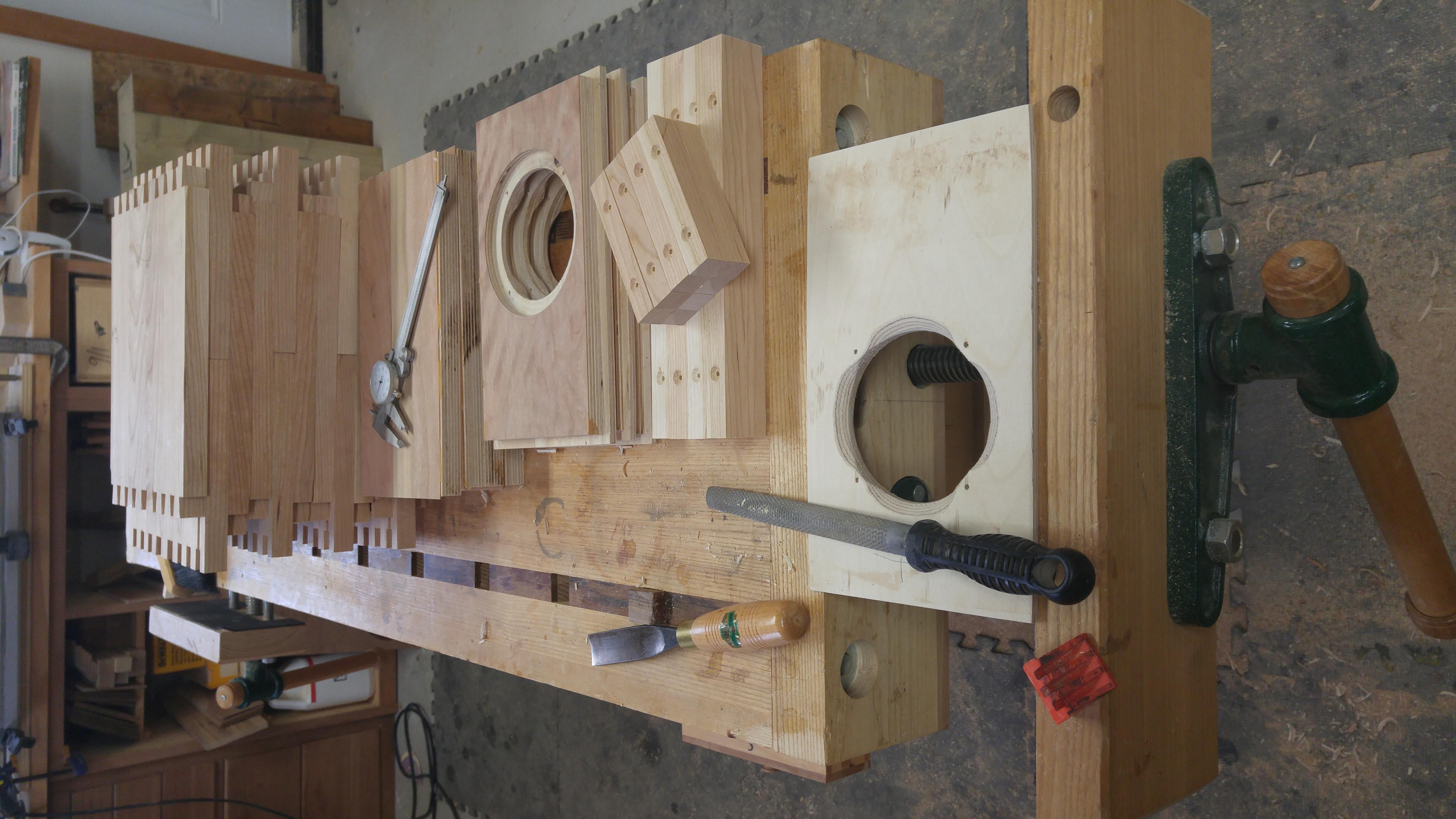

Could you get a rasp in there. I usually relieve mine with a gouge and rasp from behind but im thinkin you could rasp enough out from the front.

I've used a Dremmel in the past as well as a rasp. Kind of a pain, but from my experience it's the difference between an unlistenable speaker and a stellar speaker. Without a decent rebate, all the energy gets "clogged" and the sound quality drops to a point the speaker is not worth using. It's one if those small but absolutely necessary aspects of a speaker build with drivers mounted to the front of the baffle.

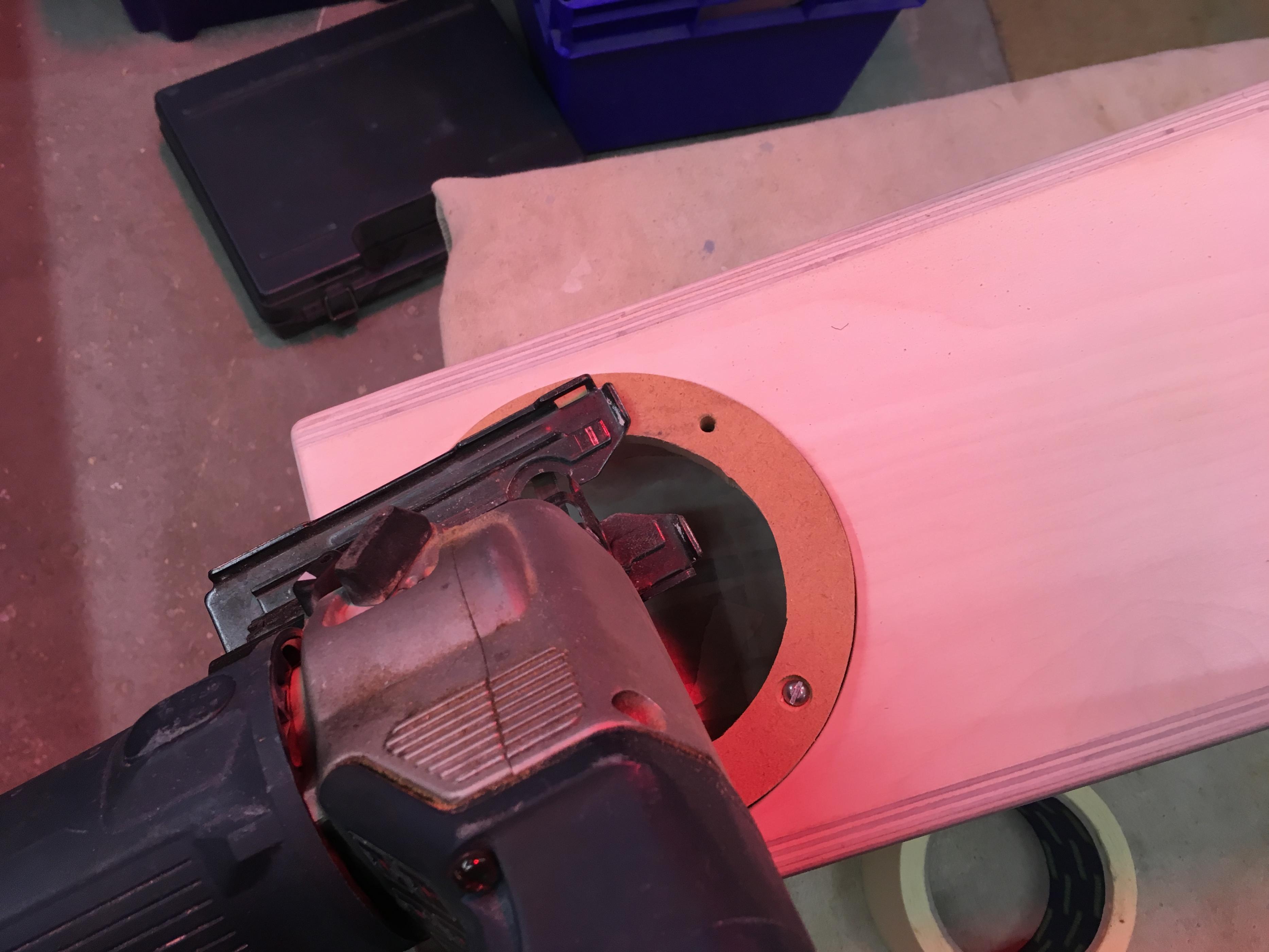

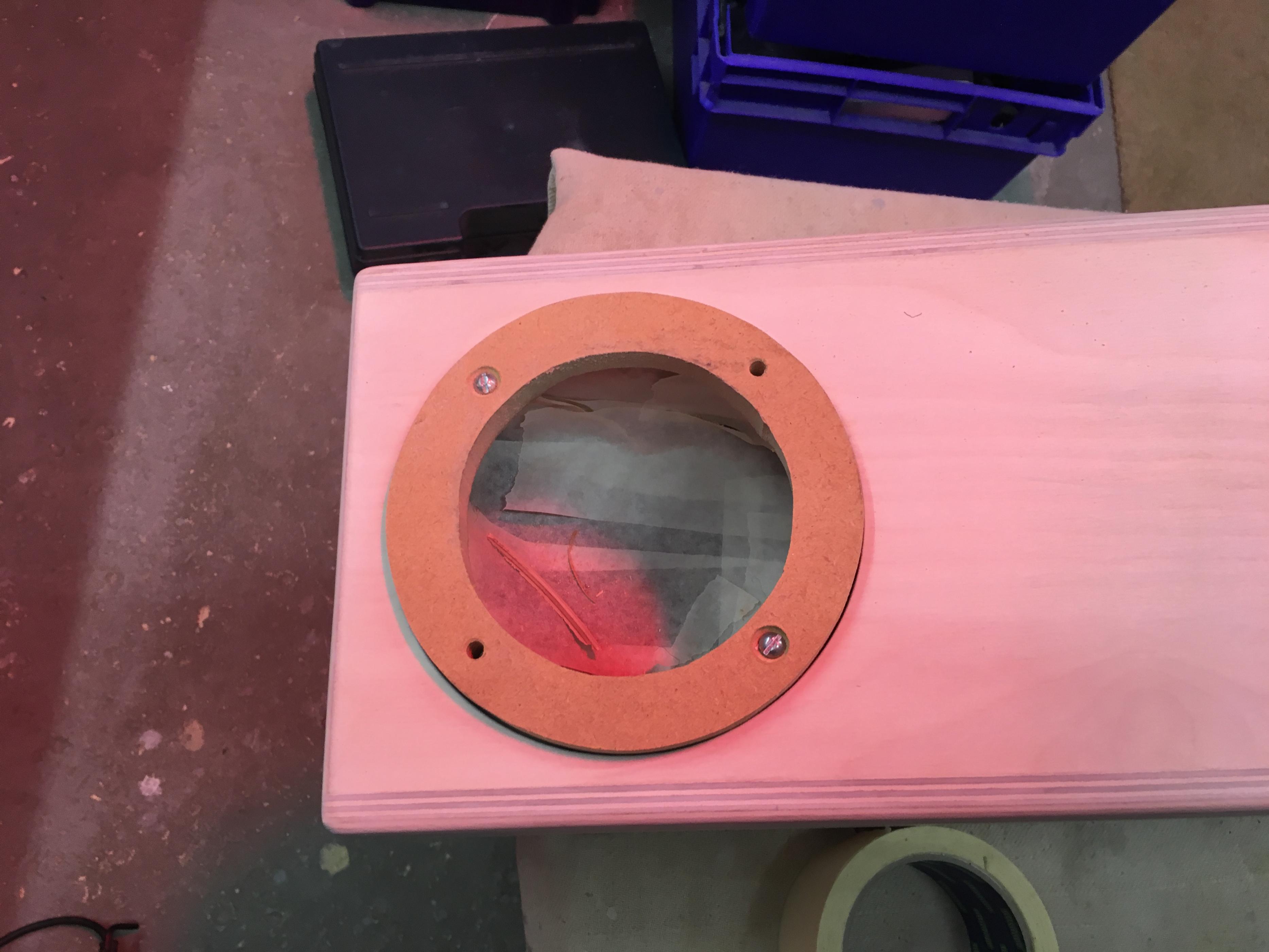

I'm sure it says
Anyway was not the truma I thought it was going to be. Cut out a working surface out of scrap MDF then set my jigsaw to 45deg and gingerly cut between the fixings. Not perfect but fairly quick.
Now back to listening
in your signature 🙂
