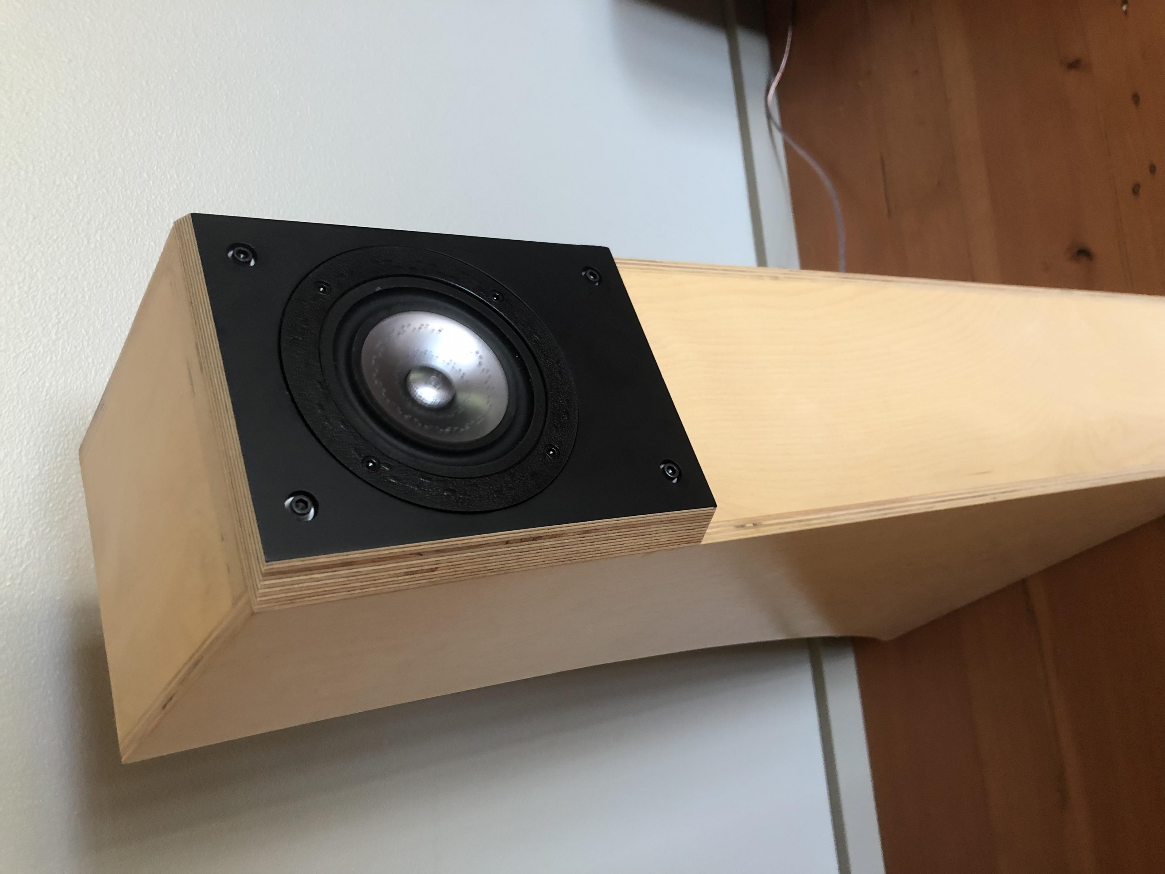

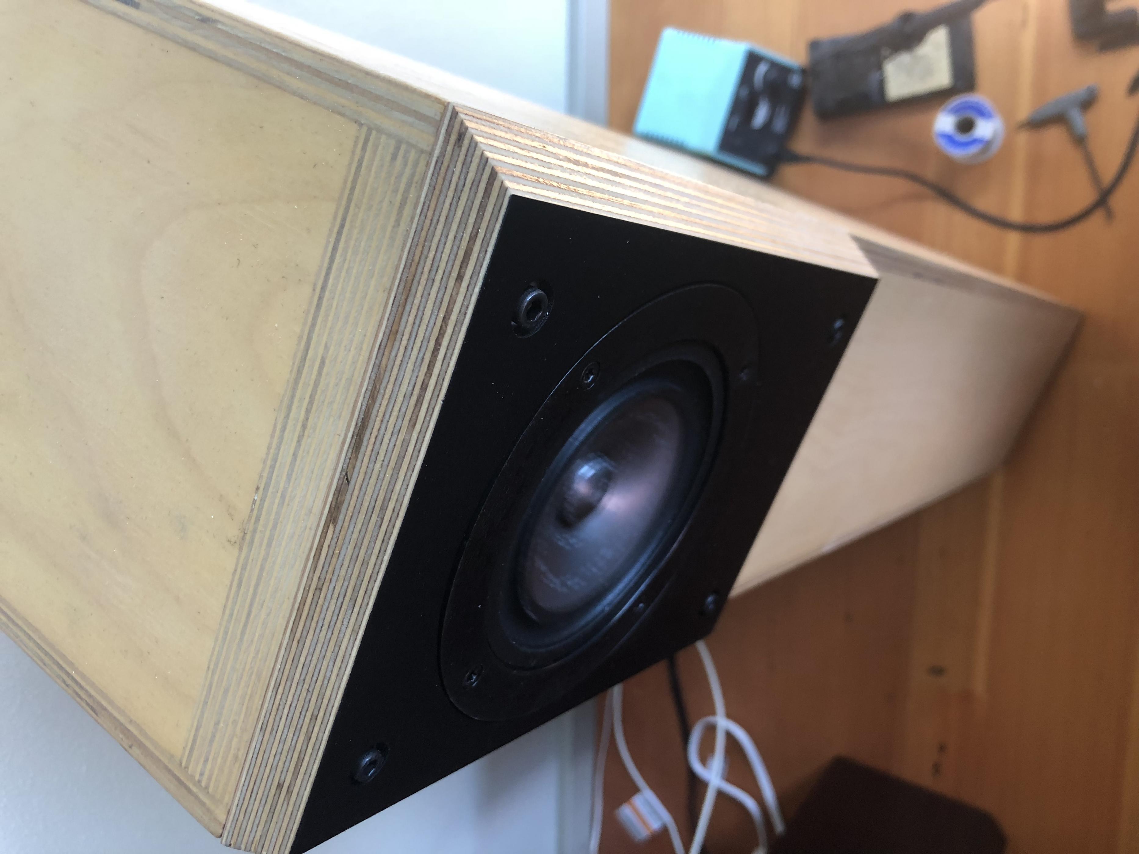

Fostex to Alpair conversion follow-up
In the meantime, I received the Alpair drivers from Dave and hd some time this morning to switch things around.
Pretty happy with how it’s turned out. My initial listening impressions:
- shouty mids are gone
- much warmer sound overall
- improved low end
- not as loud with my SE tube amp, but still plenty
- a little reduced soundstage/airy-ness (all technica terms)
More listening needed. I may try my KT-66 amp and see what happens, too.
Cheers!!!
