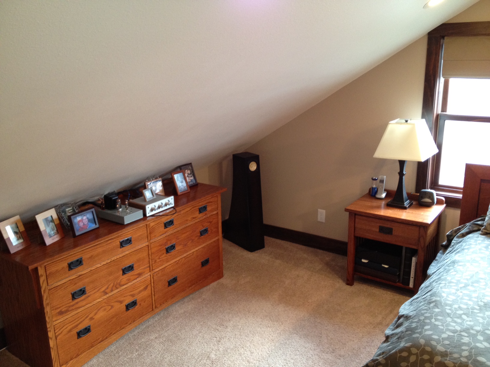

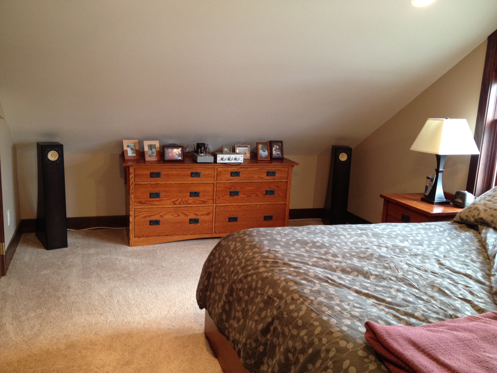

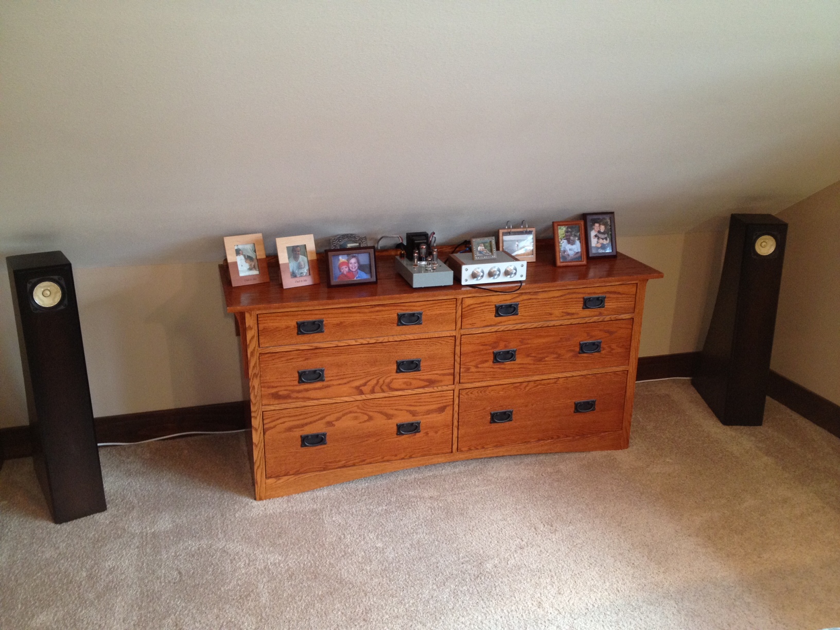

Moved for better sound
Moved these to a slanted ceiling corner in our bedroom.. tremendously improved lower end. Much happier....I now no longer need a lower end unit or sub to help out.. All is good.. Just please send snow for xmas...
that's not really surprising - coupling to slanted ceiling has dramatically increased the effective size of horn mouth

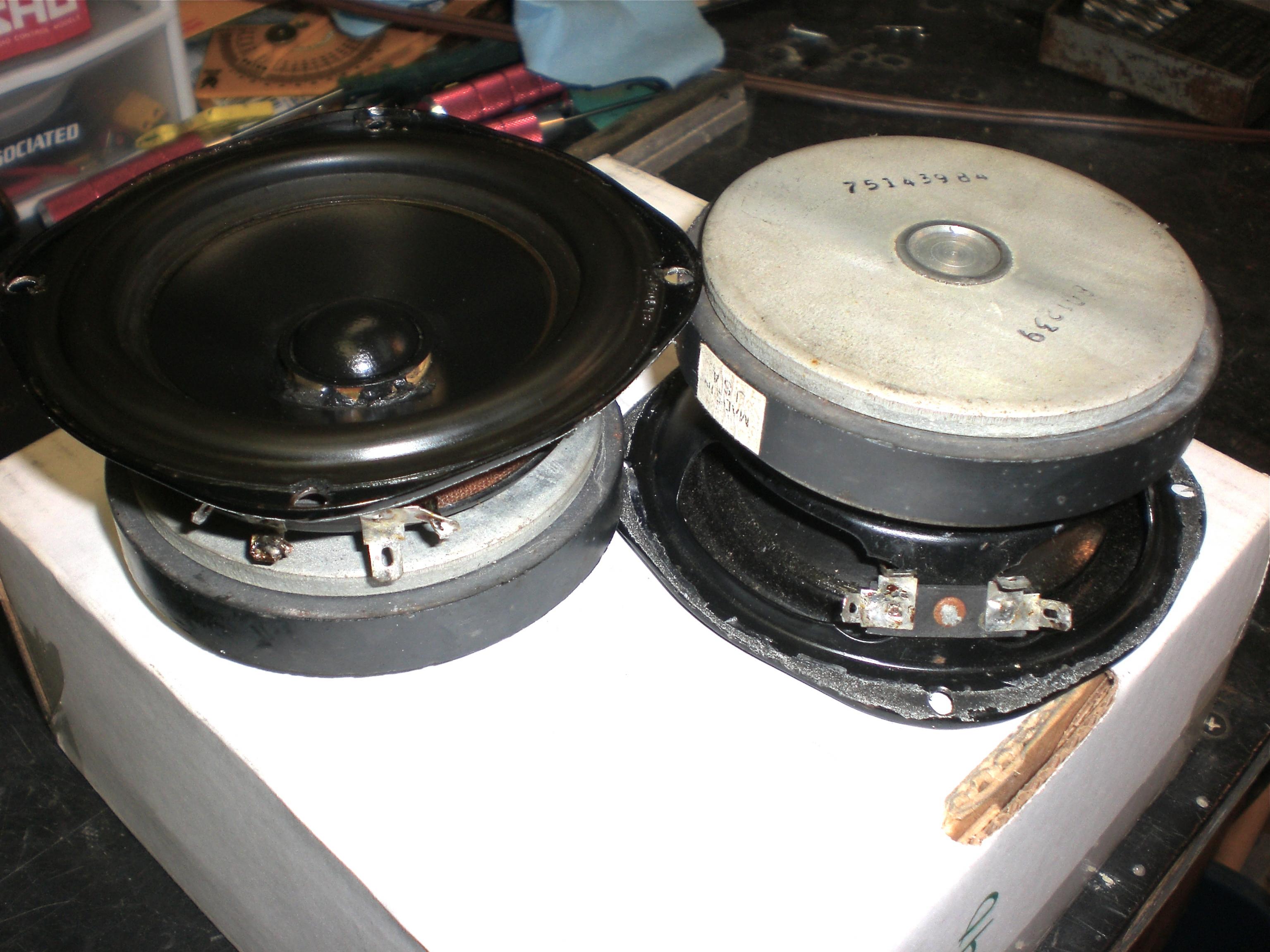

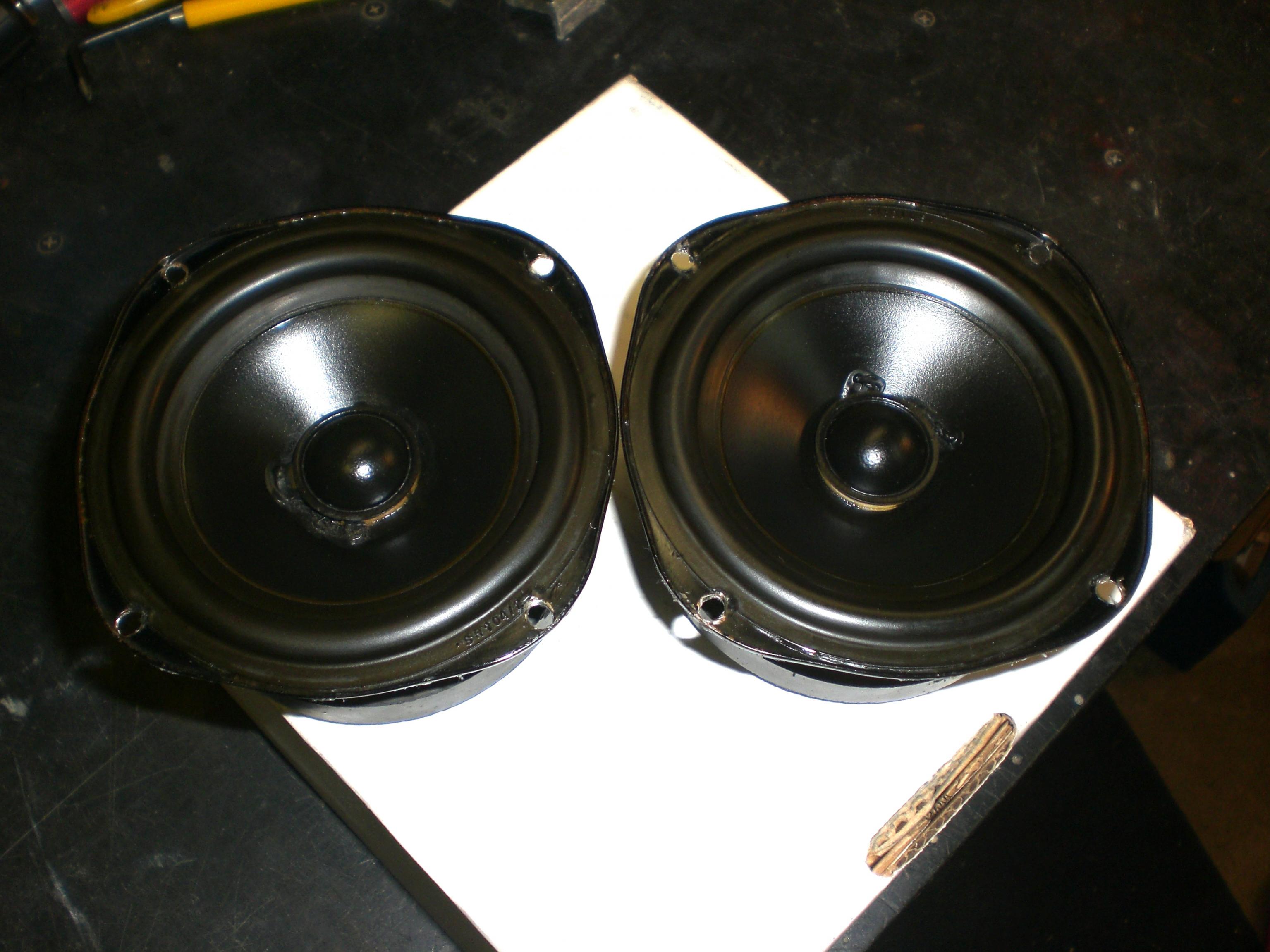

I've had these drivers since 1986. They're from a company out of Dayton, Ohio. I've called a contact number on the web with no luck.... has been disconnected. They still sound amazing. I'm going to try them out in a Mk3 build. Really wish I could get some T/S specs on them. Anyone have any leads or info on them?
Thanks Dave. I looked through all their drivers. Nothing a dead ringer by looks. If they did make it, they've completely changed their design for the dust cover.
It looks almost a dead ringer (except for the cone coating) for the Hemp Acoustics FR4.5 which were made by MISCO.
