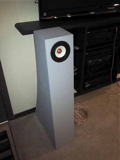

I haven't read any posts about using the Tang Band W4-1879 driver in a Frugel Horn. These drivers are $60 each now at Parts Express. With the price right and a freq. response of 55-20K my curiosity was killing me. So I bought a set. I have one FH3 completed (less paint). I had to cut away a little over 6mm into the panel behind the driver to make room for its depth. Well worth the effort! The sound is absolutely amazing! I'm really excited to complete the other enclosure to hear the set together.
A friend of mine flew in this week. He could not believe what he was hearing. He told me, had I just told him over the phone, that a 4 inch driver was putting out this much sound (i.e. bass), he would not have believed it. He could feel the couch cushions vibrating! Clear highs, not fatiguing. Natural and smooth mids. So, if we can get past the ugly (my wife and I like it) phase plug. I have to say they are well worth a listen.

Here's a photo of the TB W4-1879 mounted in the FH3. The cabinet will be painted gloss black when finished.
I actually love the look of the phase plugs on these. Nice work!!

was there any adjustment to the depth of the w4 tang band.. it appears deeper than the fostex 126? or did it just make it....
I had to cut into the panel right behind the driver about 6mm. Easy to do before it's built. After...not so much. The length of the panel doesn't change. Just the thickness at the top.
