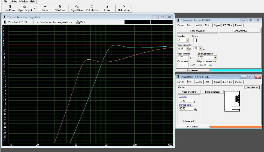

Fair enough. Since I have the 126's already, any suggestions on a two way design utilizing them and a woofer?
Well, you could always try a small OB with H-Frame woofer - just not my (wife's) cup of tea aesthetically
Dave keeps promising to sketch a smallish BR for the 126, but even the Fostex recommended box, while far from optimal, would be as good a quick afternoon bash-together project as any.
As for woofers - were you thinking of passive filters/ single amp, or bi-amping. The latter option simplifies selection of drivers, at the expense of needing additional amp(s)
Actually, a re-tuned 4.7L mFonken box would be waaaaaaaaaaay better than the Fostex 10.5L BR box. Unless I'm completely OTL, the Fostex box appears to be a cruel joke for the FE126e, unless you can EQ in some upper bass, lower mids.
So mFonken vent dims would be approx. .47" x 1.77" x 1.75" long (2 vents). Dave would want to verify (or change) these dims of course. I used WinISD to generate the sim.
jeff
jeff
the 126's cardboard packing box might sound better than either the oversized BR, or the even stranger hybrid "BLH" which we built a pair of
cruel joke? I'm not sure the Fostex staff is authorized to intentionally attempt that, (or that they actually listen to all the designs?)
yes, provided you're not looking for any upper mid bass on down the little mF enclosure would I guess be as good a starting point as anything
