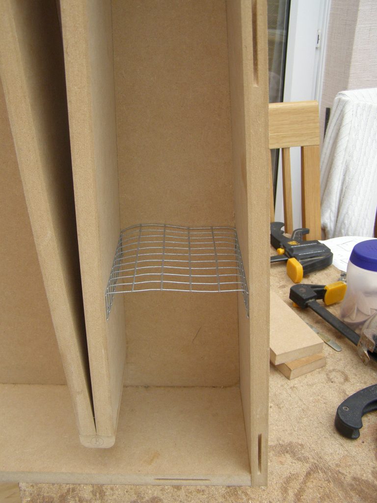

I agree Chris and with all the MA drivers they require extra polyester stuffing placed below the driver. The amount adjusted to taste and speaker location. To help prevent the stuffing falling out the bottom of the horn section I install a wire mesh shelf abot 20" below the driver.

Couldn't find a way to add an image of the mesh shelf...
Neat. What's the mesh do? Keep out the weasels?
keeps the loose dacron fill from falling too far down the expanding section of the path
not all drivers will necessarily need fill below the driver, but in the instances of those that do, at only 140 mm wide and approx 76mm deep directly the driver, and 38mm at the choke point, there's not a lot of room for access if any falls to the bottom of the first fold
