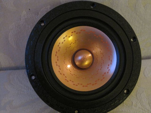

3> wpc surprisingly drives the CHR-70's to very satisfying levels pour moi.
Sawdust is flying as we speak---- these:
Dave's cone treatment must be seen and heard to be appreciated-- time for a fix!
Don
