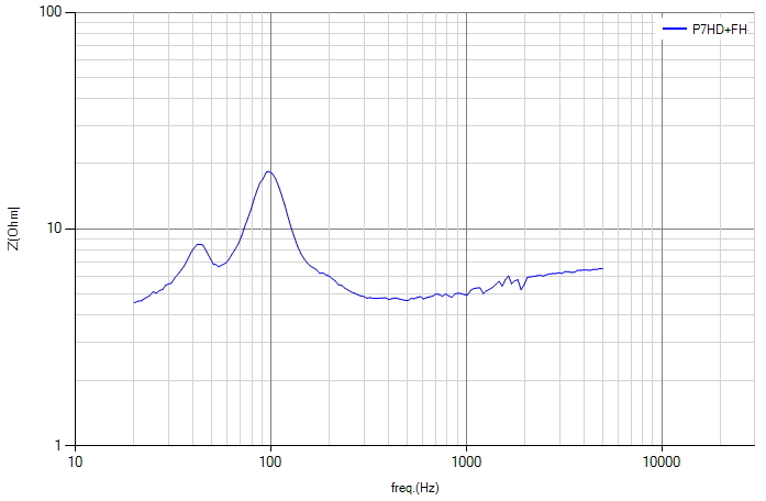

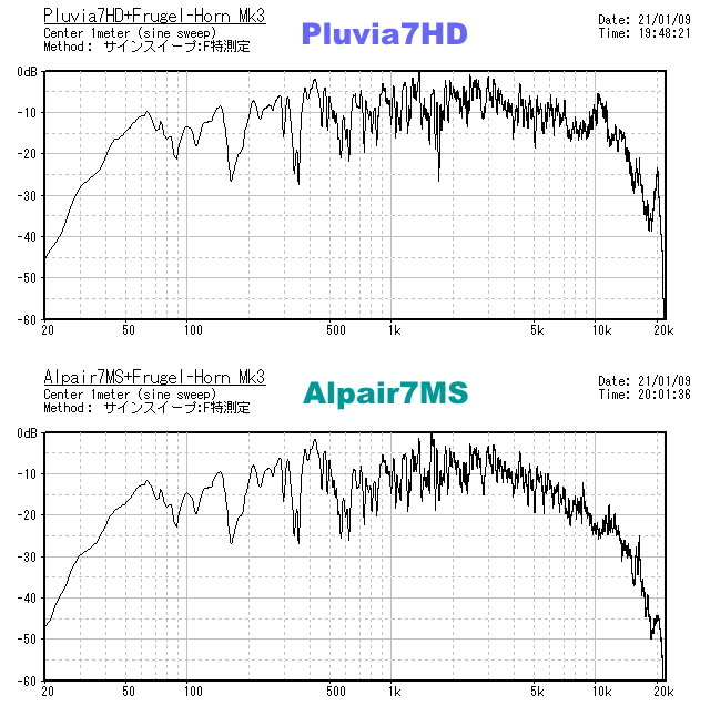

This is really interesting! Can someone please explain the thinking behind a ‘Damp duct’? And no stuffing is used at all? This looks like an easy experiment and I can see that some areas of measurement are tidied up too. The slight extension at 40Hz and reduced drop just under 2k with no other obvious adjustments is intriguing.
