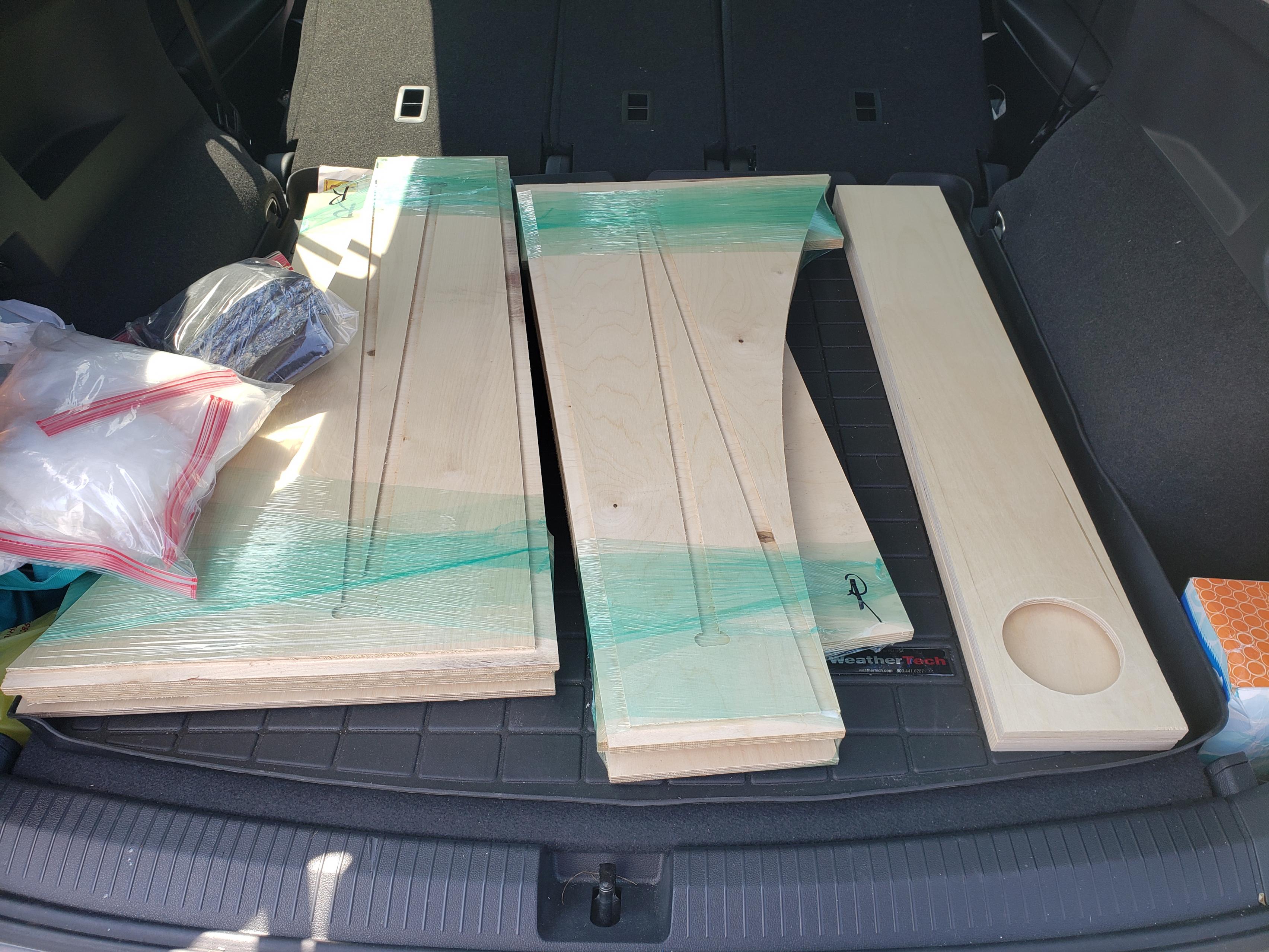

Hey all! I have been lurking a bit here and got a flat pack delivered by Bob at Big Wood Studios. Really excited to get these built, but will take some time as school has started back up.
The flat pack came with a flush mount rebate cut in the front panel without any chamfer to the rear (no supra baffle) and I have a pair of MA Pluvia 7 PHD, and MAOP 7's to put in these.
Is there any performance to be gained by chamfering the rear of the driver cutout with the MAOP 7 or PHD 7? I have searched and searched this thread, but I only find methods of chamfering, and not the reasoning (and how to tell which drivers may or may not benefit from such a thing).
It is my understanding that chamfering the rear of the rebated driver cutout could possibly leave too little mounting support so I'm trying to figure out whether it's even something I should consider.
Thanks for your time and all the info this thread has brought! I'm super excited to get these together and singing! (drivers are already broken in 😀)

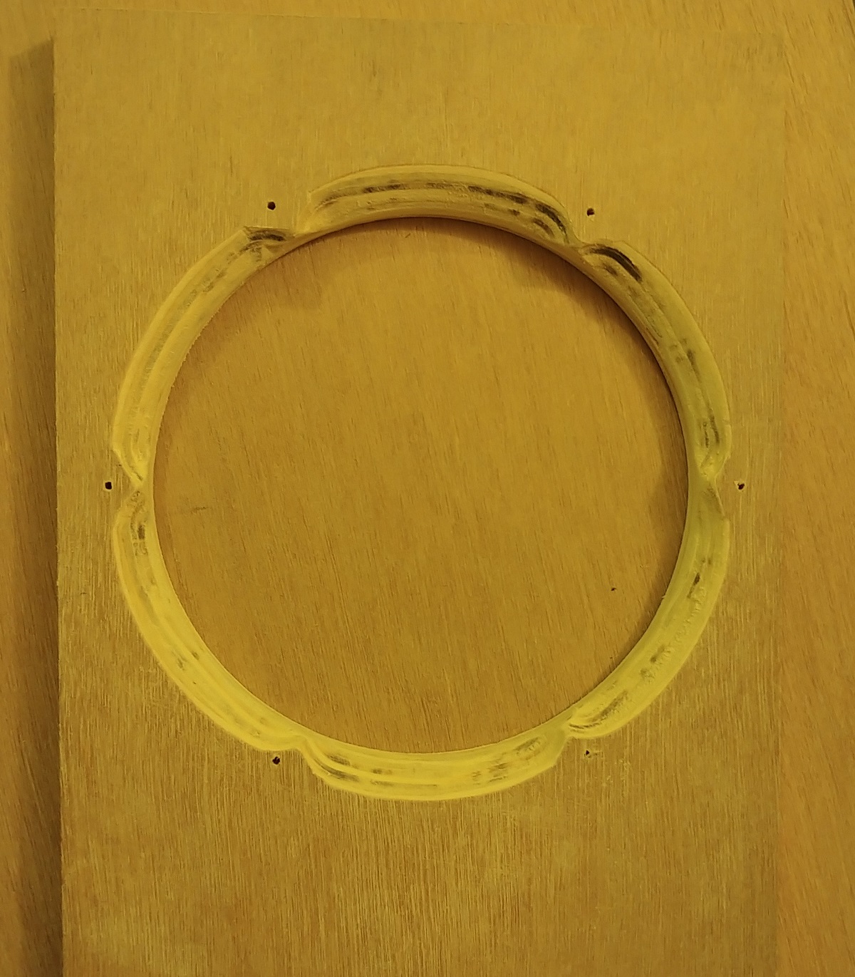

Reima,
Please find attached an image of a chamfer I did recently. Maybe Dave can comment too.
Obviously this was done before gluing up. But it's very much possible to do one even after gluing up. Needs a rasp, sand paper, patience and some elbow grease. 🙂
It might be a good idea to place the driver in the cutout and mark the holes for the screws first, so that when you chamfer the inside of the cutout, you leave more material adjacent to the screws.
