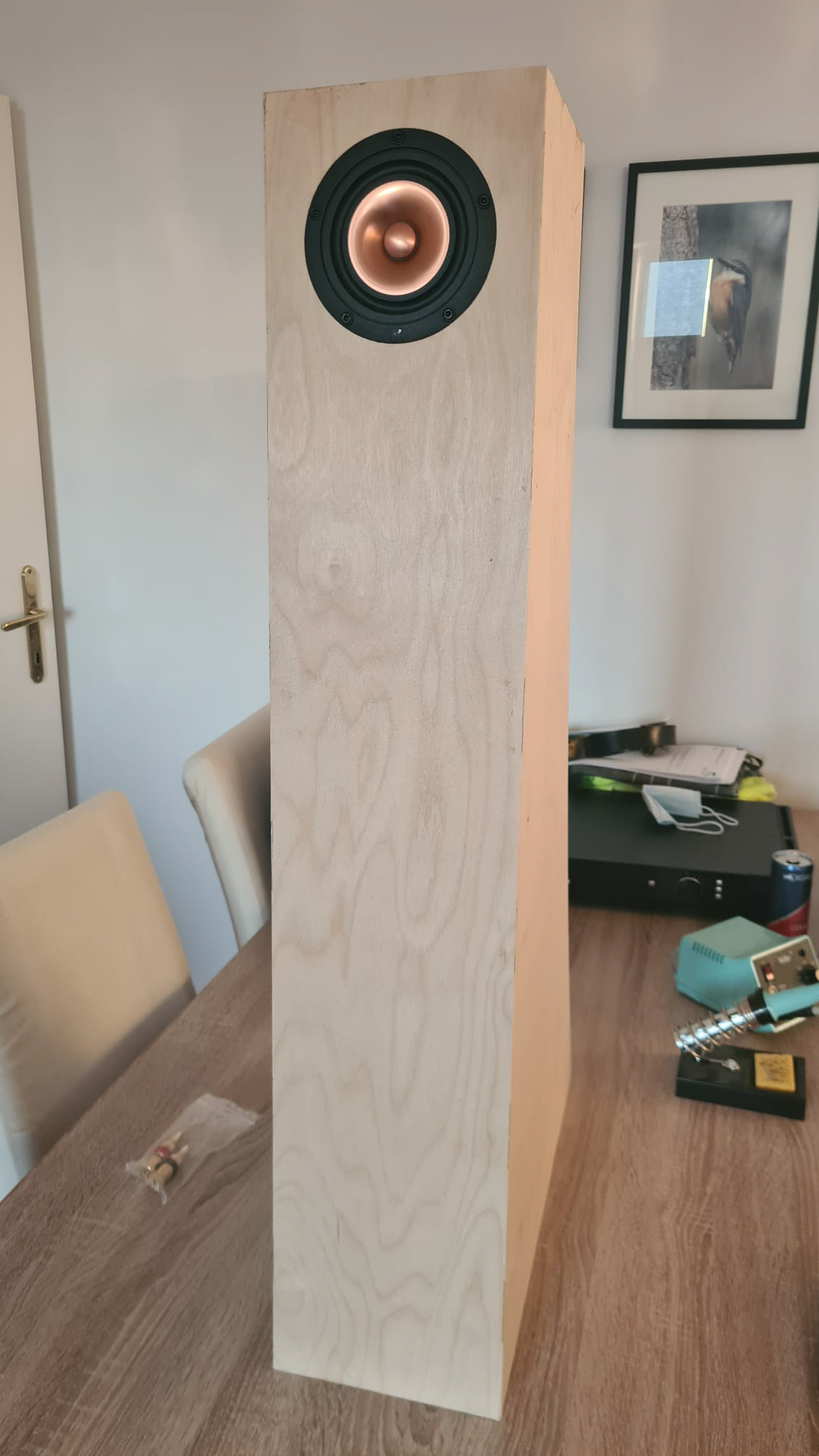

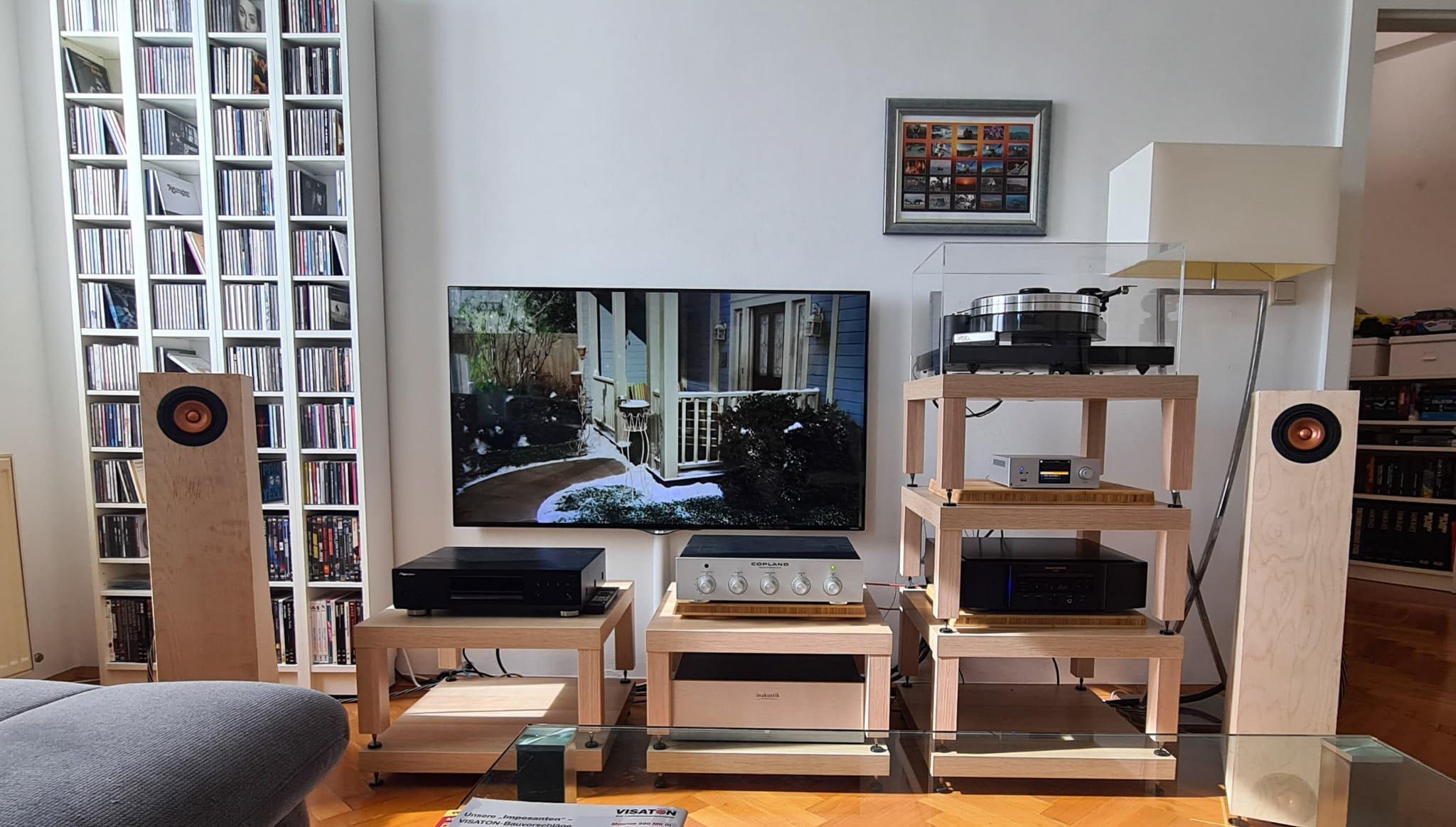

Hello,
I am new to the forum (please see my introduction), not so new to diy-projects, but 3 days ago I have finished my first speaker project, the Frugal Horn MkIII🙂
I mean... I am about to finish it. The cabinets are completed, the Alpair 7MS are mounted and broken in for 20 hours.
Yesterday the first hearing session - well, there are many many things what I really liked 🙂 These are the very open and natural sound and the great stage, among others.
But there are also some issues...

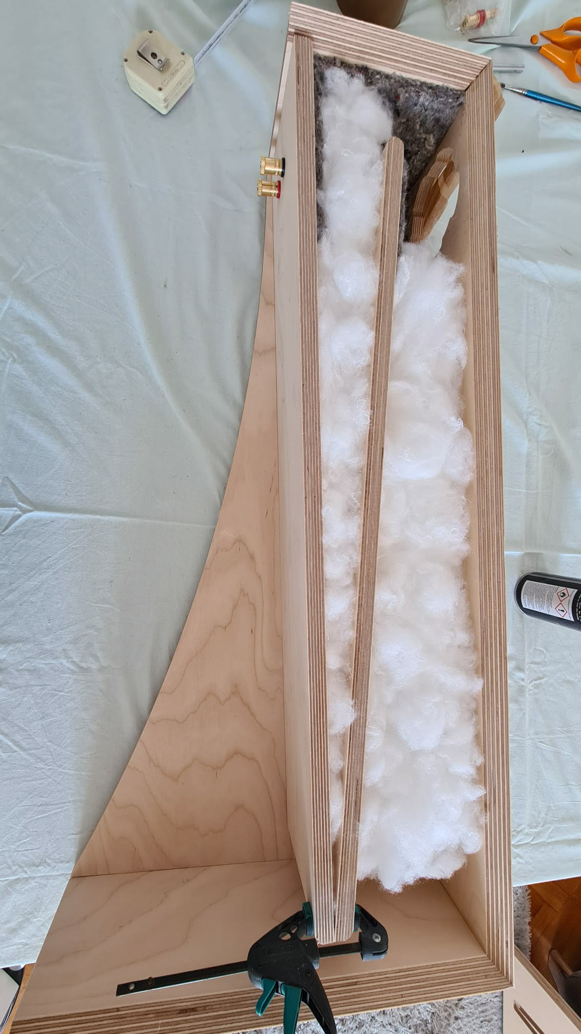

First issue was the missing bass, but I solved it with removing of some stuffing from the front chamber - it is great that I can tune the amount of bass, depending on my room, the driver, the electronics, the color of my t-shirt... 😀
So the bass is now here (maybe I should remove some more), but the main issue is the higher mid section, it is just shrill, or as one member wrote here, it screams. With lower volumes it is "okay", but with increasing the volume it will be somehow disturbing.
I tried to search for information, but there are so many pages and obviously I did'nt found the right one 🙂
So could you help me please with some hints? Thanks a lot in advance!
I upload some pictures too.
Best regards
Istvan

Thank you Dave and Scottmoose, much appreciated.
The stuffing is really bad... since then I removed a good portion and the bass came back.
In the next step I will try to remove all the stuffing from the front chamber, tease it and then put back 40 gramms. The rear chamber is tricky...
There are many pictures where the cut-out for the driver is chamfered "because the drive must breathe" - is it a "must do"?
Thank you in advance.
Best regards
Istvan
While I never lived with any of the “ms” series for more than a few days, I’d suspect them to be more susceptible to less than optimal performance with either excessive damping near drivers, or lack of sufficient chamfering / relief on rear of mounting hole; which I’d say is definitely required on the 7 and 5 cm sized drivers - perhaps less so on the larger models.
Nice work in the folded bevel joinery.
...one of the best tweaks I've done was to remove insufficiently teased stuffing from A7 and A12p Pencils and replace about 1/2 - 3/4's of it after really really teasing small pieces at a time so they drop in there like snowflakes...keep teasing!
