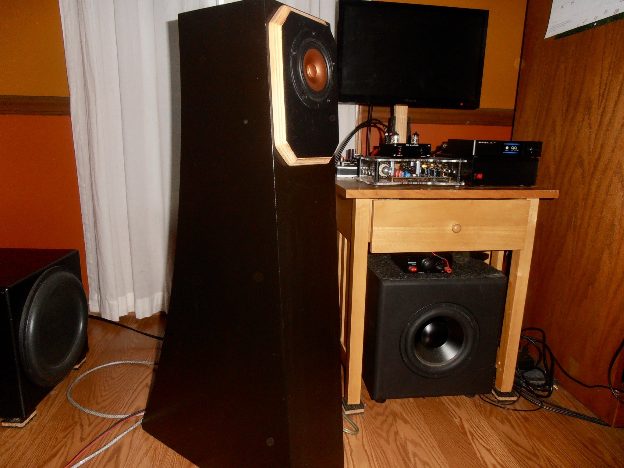

Hello!
As the rear chamber of my FH was full of stuffing, I had to remove all of it, but it is almost impossible. Then came an idea, and my now good friend, a flexible gripping claw helped me 😀 To put the stuffing back I used a flexible drill shaft.
So now there is 35 gr stuffing in the front and 35 gr in the rear chamber, and 17 gr behind the driver.
And boy what a huge difference! Now there is plenty of bass just 9 inches in front of the wall (no corner placement possible), great soundstage and the upper mids are not shrill anymore, it is just a great open sound. I am really excited🙂
Thanks for your help again!
Cheers

Thank you Zman!
I still have to adjust or fine tune the mids, I think now it is slightly overdampened, but it is just a matter of personal taste.

Just playing around with my Frugels, next (last?) round of the adjustments. This time I ended up with just 2 gr stuffing behind the driver (A7MS) and the speakers stand just 3 inches in front of the wall, without spikes. And here it is - it sounds great. Plenty of bass with punch and pressure, clear and open mids without screaming, detailed but not overemphasized highs. It was a long way to set them to suit my room and my taste, but it works 😀
Did I mention that I drive them with two bridged ACAs? 😀

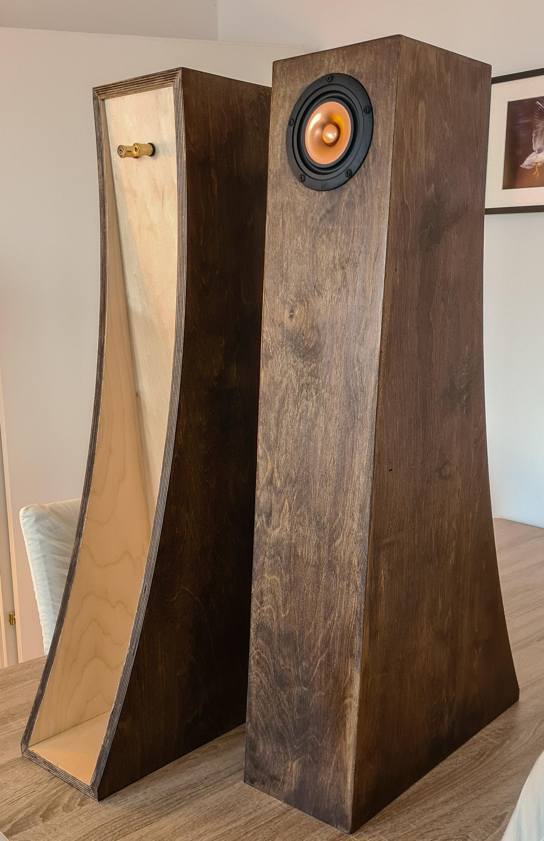

What's the latest intel on the stuffing of the Frugel-Horn Mk. 3 when used with the Alpair 7P driver?

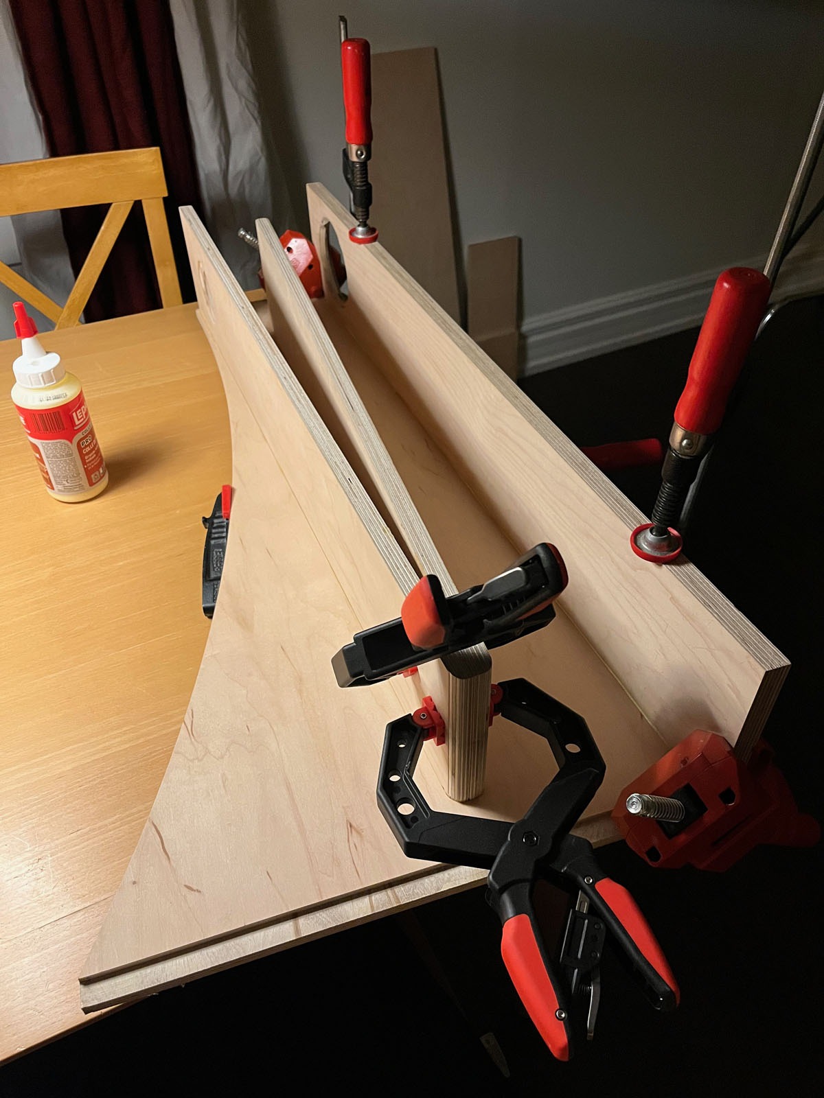

I'm finally getting around to building the flatpack I bought from Dave back in 2018. Because, ya know... You shouldn't rush into these things. 🙂 The build is progressing and I'm at the point where I need to go and tease the Acousta-Stuff. I have four bags of it: Two marked "40 g" and two marked "30 g". This begs the question: do the 30 g go in the closed end of the horn (triangular space below the terminal cup) or in the open end of the horn (larger space below the driver)?
It seems this is the topic of some debate. Maybe Dave could chime in with the official word.
I see now why woodworkers have wood shops. Even though the flatpack comes together pretty easily, working on the dining table is pain. I'm better set up for metalwork.
Thanks,
Tom
