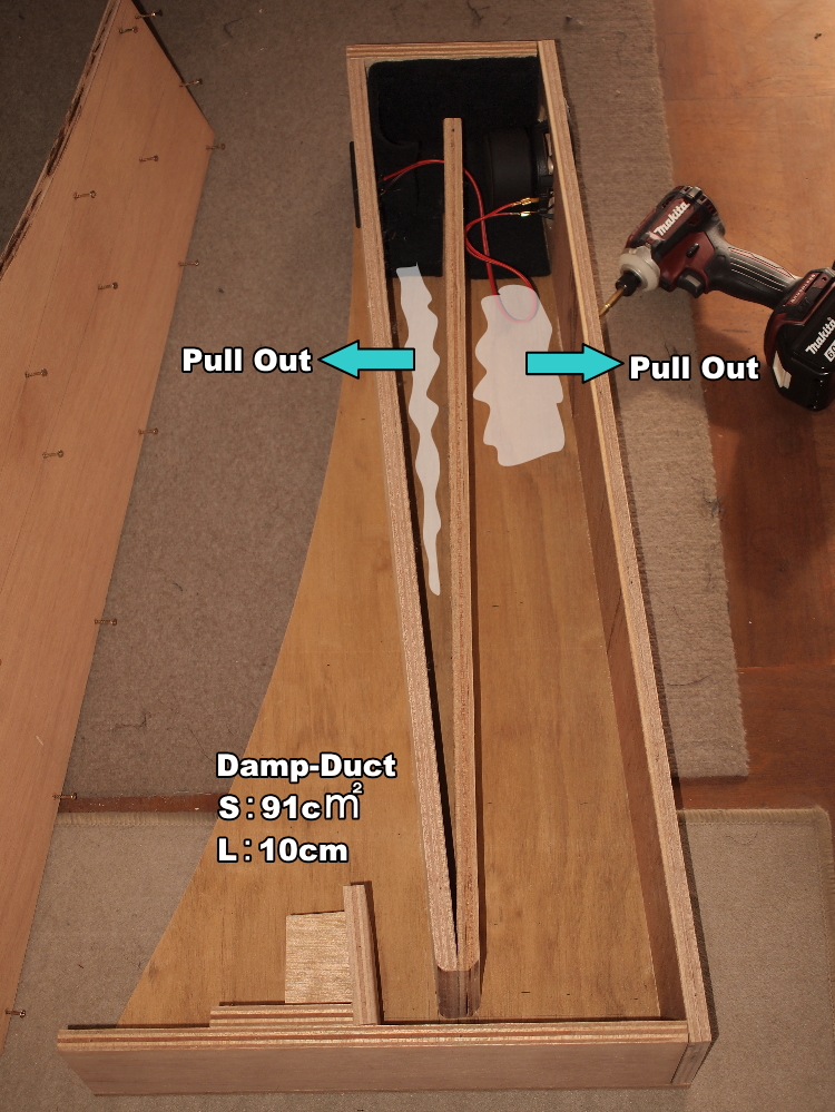

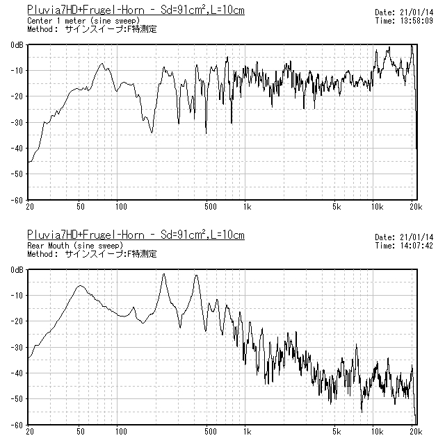

My choice , final adjustments.
Minimal sound absorbers.
Dump-duct Area:91cm2(6.5x14cm) , Length:10cm
My FH mk3 is thunder and storm sounds.
7HD+Frugel Horn - Final adjustment version [ My Final Choice ]---------Damp-Duct (S:91cm2 , L:10cm) - YouTube
This is really interesting! Can someone please explain the thinking behind a ‘Damp duct’?
He's changed the internal low-pass choke into a duct to lower tuning. While it does achieve that, it also entails some compromises that haven't been mentioned and are somewhat at odds with the design goals, so it's not something I would recommend to others (while acknowledging that it suits nandappe).
The 2KHz aspect is either another minor difference from measurement setup (no criticism implied -you can get such changes through something as simple as different atmospheric conditions), or possibly from adjusting the damping & killing an internal reflection: the enclosure does not operate that high in terms of producing output, and FH3's damping scheme is designed to be user-adjustable.

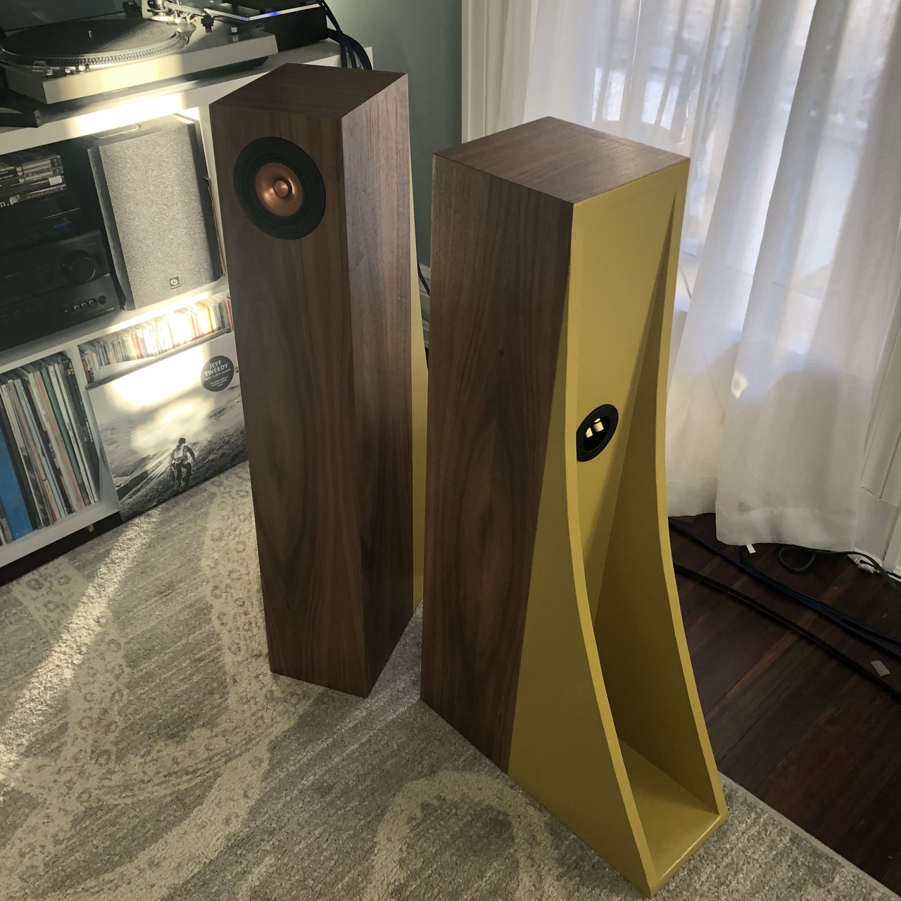

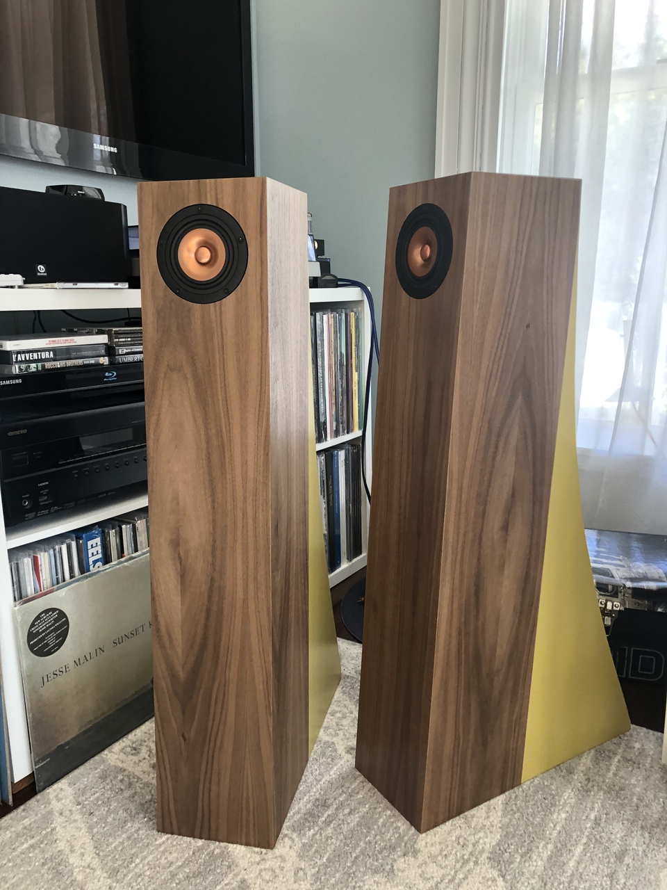

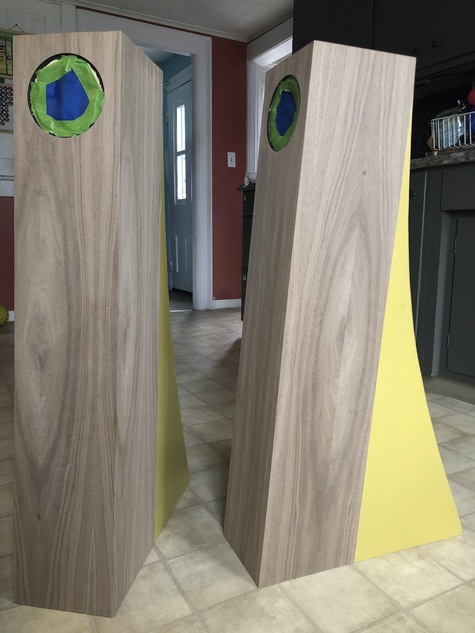

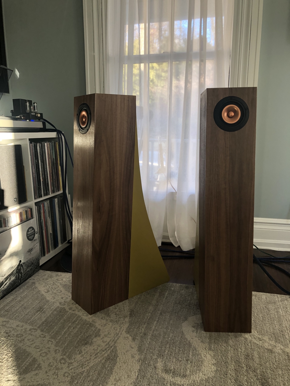

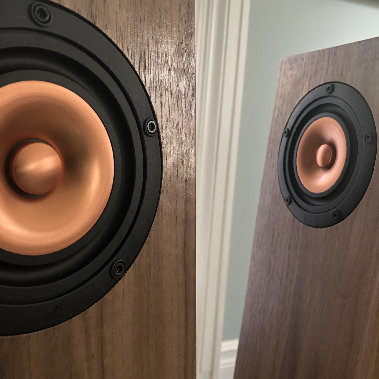

Holy heck. I’m smitten with these speakers. Thank you to those that contributed to the plan and development as well as the community posting on the various build threads. I’ve learned a ton and am enjoying the ride. For anyone thinking about crafting their own pair, I would say without hesitation to go for it. The payoff is huge.
I’m still certainly honeymooning here as I’ve only had these set up for four days. The first impression of my build: I’d say the bass is palatable and frankly, surprising. The mids are strong, and the top end is “getting there” - I think I need more testing with various amps available to see if I can get a bit more sparkle.

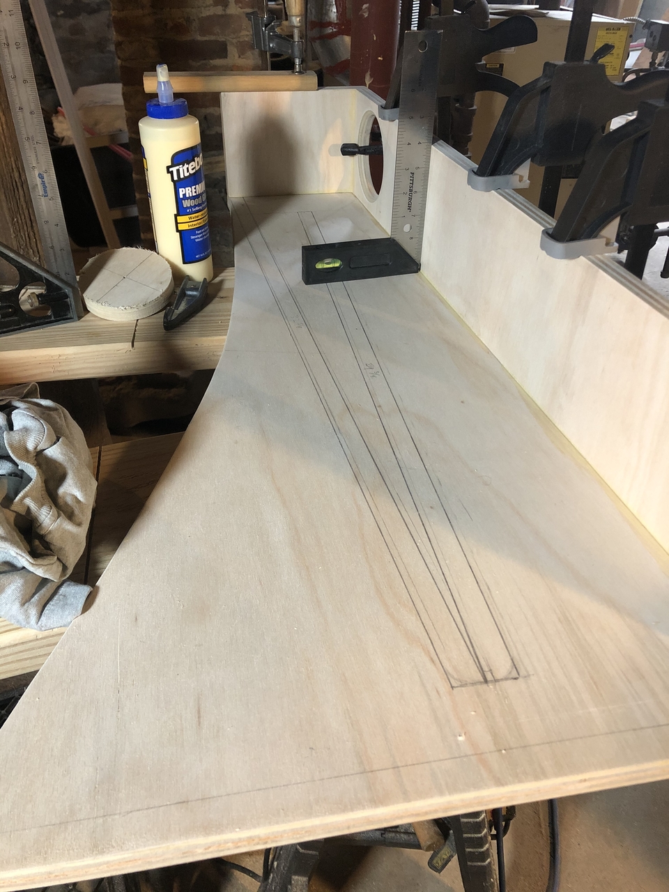

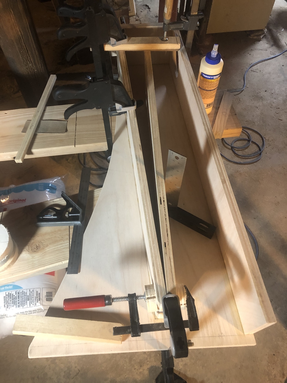

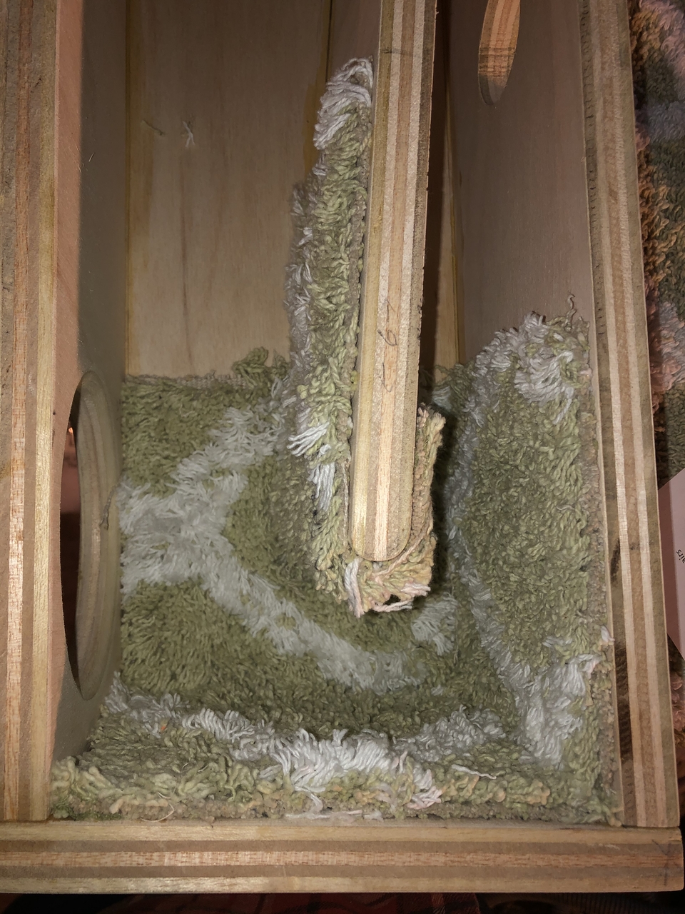

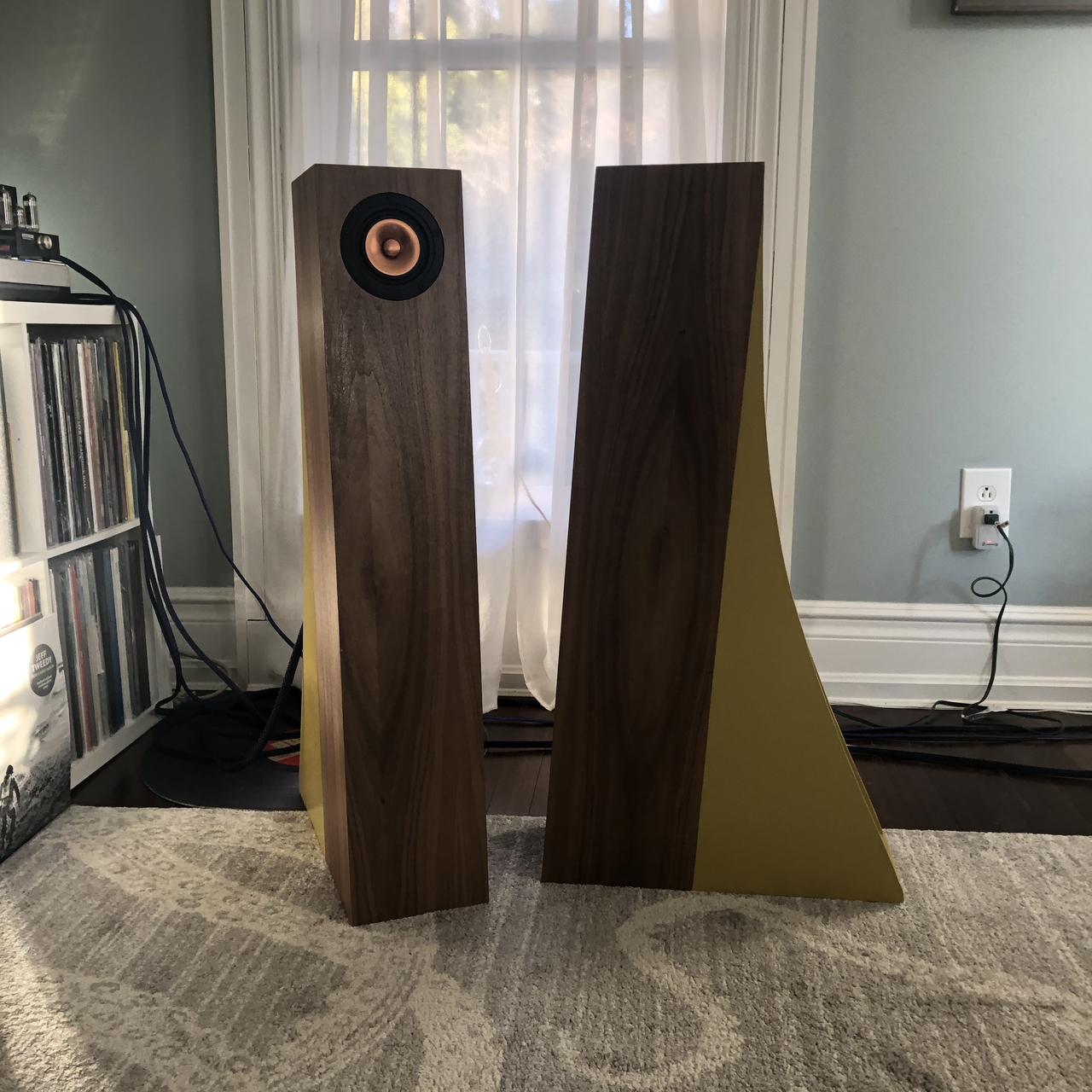

Anyway, here are some pics of my build. Materials included 1 sheet of basic 18mm plywood, a cotton bath mat for dampening, fiberfill, TiteBond II PVA, BIN primer, Benjamin Moore ‘Gibson Gold’, 5-way binding cups/posts, solder and 10g OFC wire, walnut veneer, and shellac.
My design/finishing was directly inspired by user bARTaudio and the post of his build.
The ‘monolith on a slant’ treatment just rings my bell. I feel it emphasizes the backward lean of the design which I think is quite striking and is instantly a visual cue as a differentiator from standard speaker boxes. The color in the rear - “Gibson Gold” was selected by my son who loves the color of a Gibson gold top I have and suggested it. I’m not sold on it for a speaker color, but whatever, it’s something different. The wood veneer is walnut with clear shellac finishing and came out quite good. All in all, I’m quite pleased with the overall look and even better, I LOVE the sound!

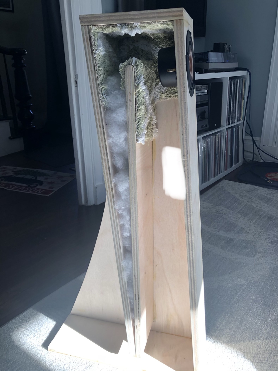

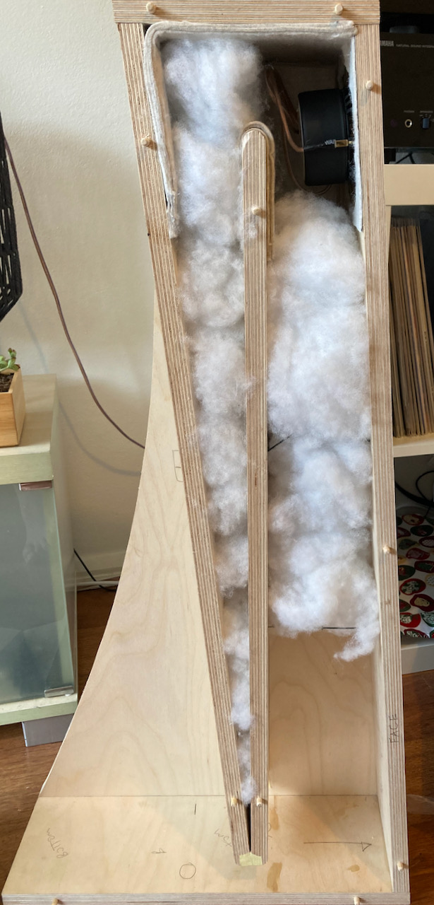

Notice to future weary forum surfers who've built FH MK3s using the Alpair 7MS drivers and are looking to tame the low end - see pic attached for where I ended up on polyfill. I didn't weigh it but I used a good chunk of the 1kg bag... maybe ~130g per cabinet. I'm using a Yamaha A-S301 amp so YMMV.

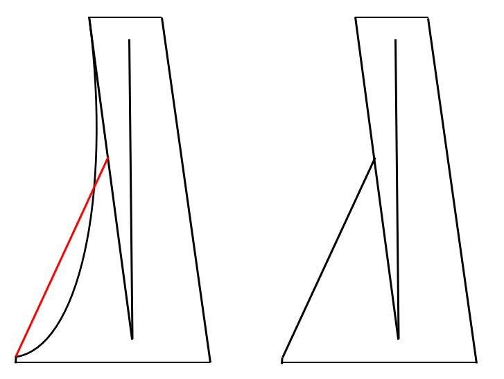

Hi Scott,
Could you please share more details of this attachment, its advantages and disadvantages. didn't seen it earlier .
To be honest it's nothing to do with me and I do not recommend it since it does not appear to be in line with the design objectives, so it's probably best for the gentleman to explain it himself. It does force a lower tuning -but that wasn't the target goal of FH3 (the opposite actually) and it alters the wave expansion (FH3 was not designed purely with the 1d wave equation) which is a part of how it sounds / behaves the way it does. So while I have never pretended FH3 is in any way perfect, it's not a change I'd make myself, and to be honest, based on the feedback over the last decade or more, I think we got the balance of compromises right for the type of speaker it is supposed to be.
Which isn't to say I'm resistant to change / don't listen. If people want a small[ish] horn that targets a lower tuning than FH3, then Dave, ChrisB and I are perfectly happy to create one which we'll design for that object from the outset; that way we'll reduce the compromises in altering an existing design and might potentially be able to make some overall size etc. adjustments. However, if we do so, it would need to be for a specific drive unit as some of the flexibility of FH3 in accepting a range of units will be sacrificed to get that lower tuning.

I love the damp-duct moreover it could be a great tuning tool with both placement and shape/size/angle and it’s easily removable. Does it have as much effect on the sound as stuffing? More? Does extending the horn section give us an opportunity to use a bigger driver with going to the XL? It seems to me it has potential upside without potential drawbacks (don’t like it? take it out). Is it a compromise to the design, sure, to the sound? Not so fast, it could be a benefit to the sound depending on duct size, shape, placement, driver, goals, room specifics, etc...
Note: it seems damped duct is the same as mass loading.

It is mass loading. Period. Unfortunately, in this instance it's mass loading in the wrong place to avoid problems (I know, I looked at it out of interest a decade ago when I had an idle moment).
I'm not sure I follow the query regarding 'extending the horn section', since there are no horn sections in FH3; it's a tapped horn (aka chamberless horn or Voigt horn if you prefer) with a hypex expansion profile and a brief restriction at a fixed point along the expansion to provide a low-pass filter -a technique pioneered by Olson but often overlooked. The size of drive unit that can be used is limited by both its physical width, and the total horn size since most larger units tend to need a larger horn, especially if you're trying to take them low or you will simply end up with a chronic lack of gain. That was one of the problems in the original FH & the Buschorn it was based on.

Yes, it will audibly effect tuning / load behaviour & sound. The curved back / termini is not cosmetic.
