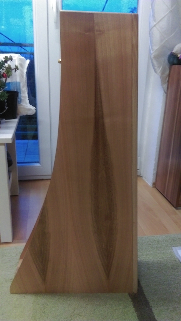

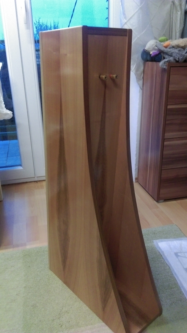

Been asked a few times earlier on this thread. As Dave says, they're a [single] tapped horn, aka Voigt horn variant. There is no vent, but they have an internal low-pass choke to help filter off the unwanted midrange. The location is a matter of convenience for size, folding and minimising the number of panels. This is one reason we said from the outset that all the physical dimensions are functional and serve several purposes, although they might not always be visually obvious ones. It's also why the FH3 load per se doesn't necessarily scale well due to sizing constraints; the others in the family introduce variations, although again, these are buried in the physics rather than necessarily showing major departures in appearance.

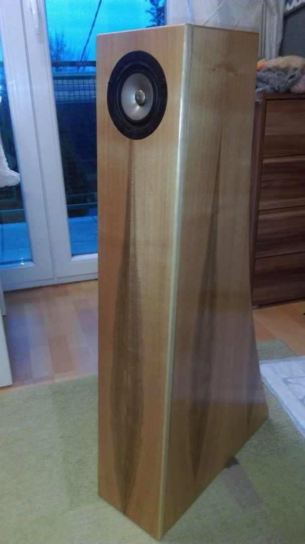

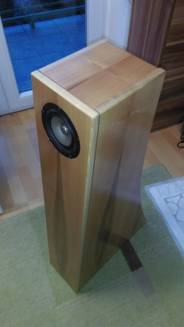

Performing initial tests. One side is glued on, lining and stuffing are in the cabinets.
First impressions: fantastic! Worth the effort. Spotify sounds like garbage.. Records and lossless files however are crisp, detailed. Sound is nicely balanced and as is usually reported, bass is much more present than you might expect. I've never listened to FR drivers before... the word that comes to mind is smooth.
I have my sub set to very low volume and it's almost not necessary.
Thanks to @Roo2 for the suggestions on stuffing and helping me decide on the 7MS.
Final glue up will be this week and I'll continue to break the speakers in while I wait for finishing materials.
Amp is a Yamaha A-S301 and Turntable is a Pro-Ject Debut Carbon.

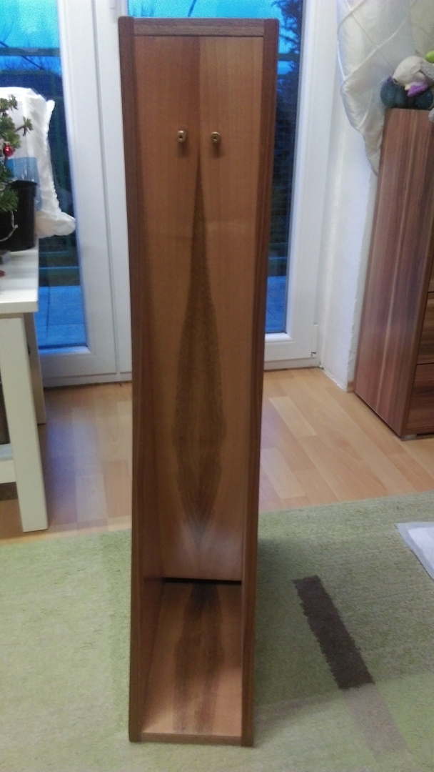

Attached is my current set up with stuffing at the moment, ~30g under the driver and ~30g in the point. Understand that not everyone has experience with the 7MS driver specifically, but - the signature in acoustic and more relaxed/indie rock music is pretty much perfect, but introducing electronic or heavier rock is bass-heavy and the mids are drowned out.
Any suggestions for adding stuffing? I've started fairly light and am going to do some experimenting today, but general guidance would be great. Do people generally put stuffing behind or immediately behind the driver? Would more under the driver or in the point help for controlling low-end?
Thanks again!
