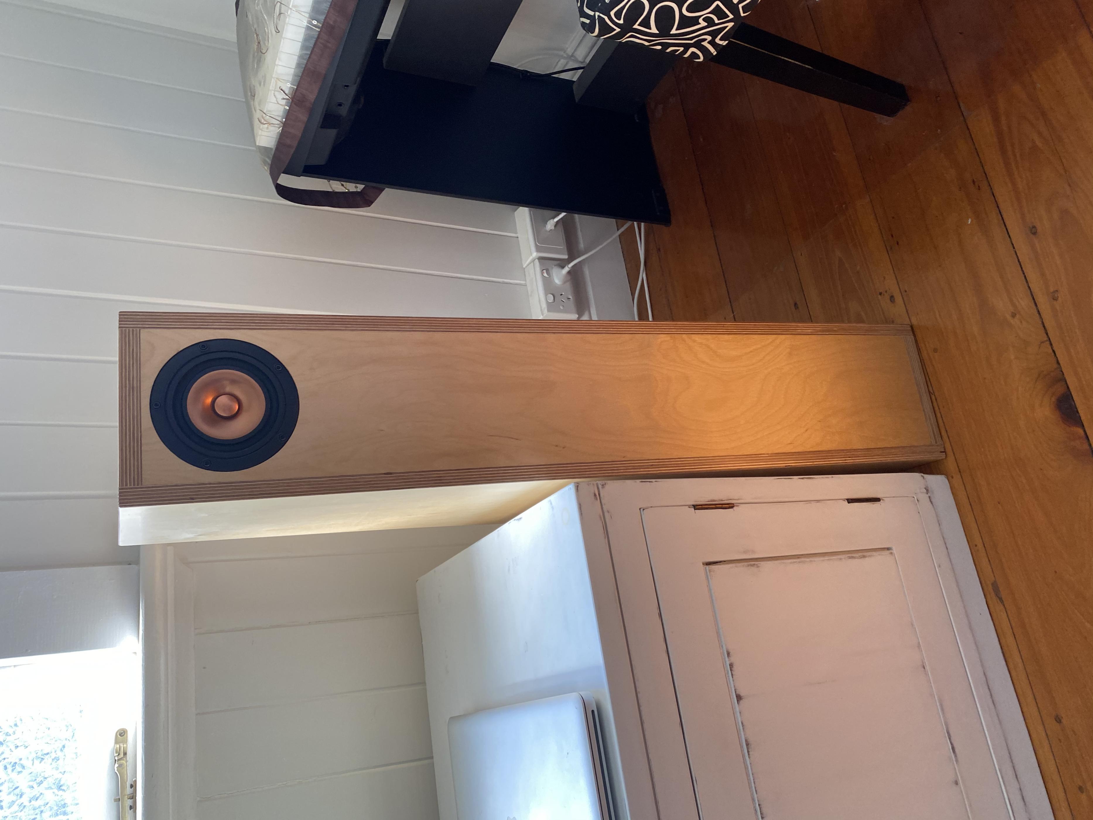

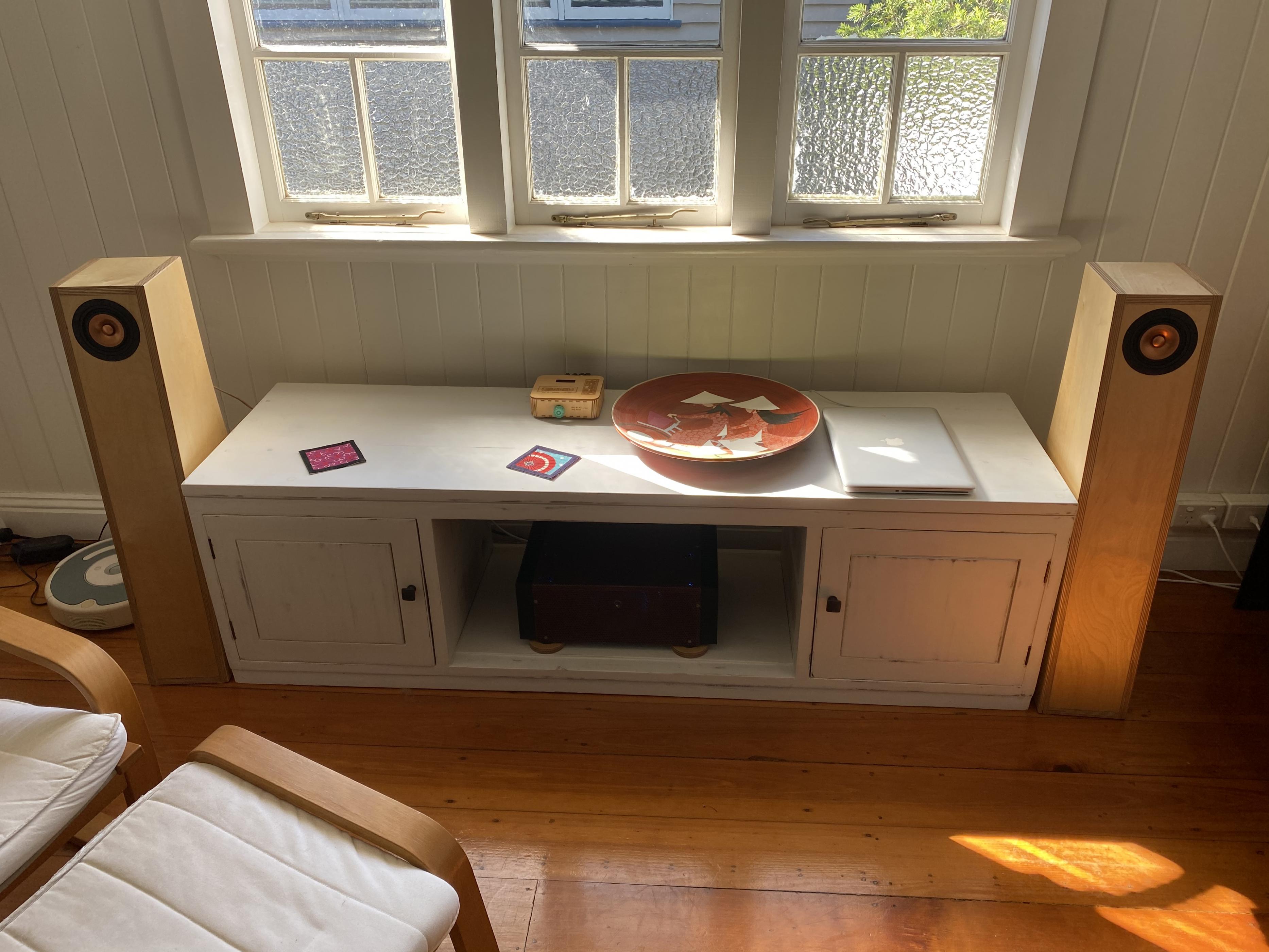

Another pair of FH3’s come to life. Alpair 7MS. 18mm birch ply. 30g stuffing in point and 20g under driver. They sound great to me. Time to play with placement.. Thanks!

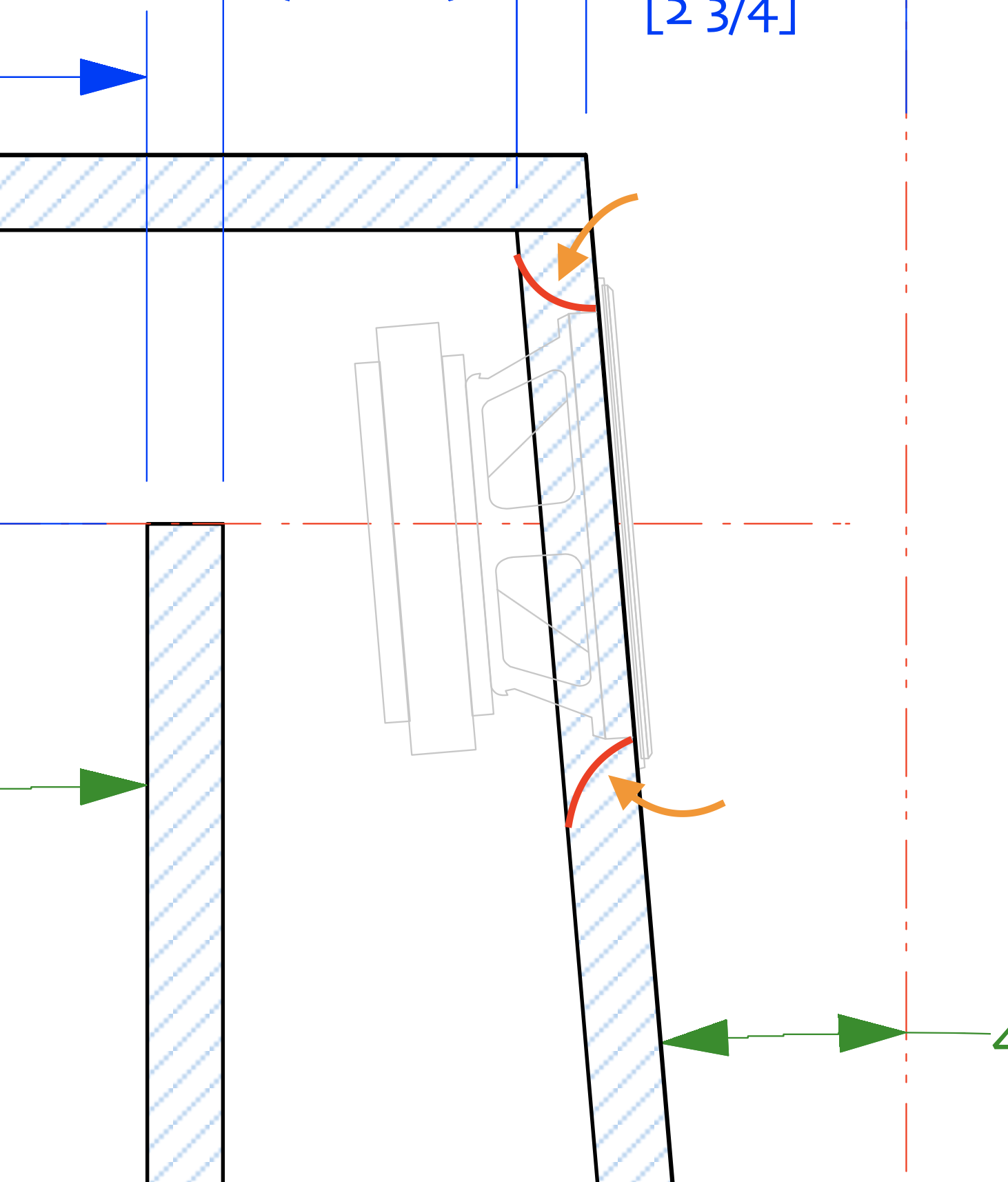

Whether a bevel or quarter round radius, I’d consider it mandatory in any enclosure design incorporating full range drivers. A whole lot easier to accomplish before assembly.

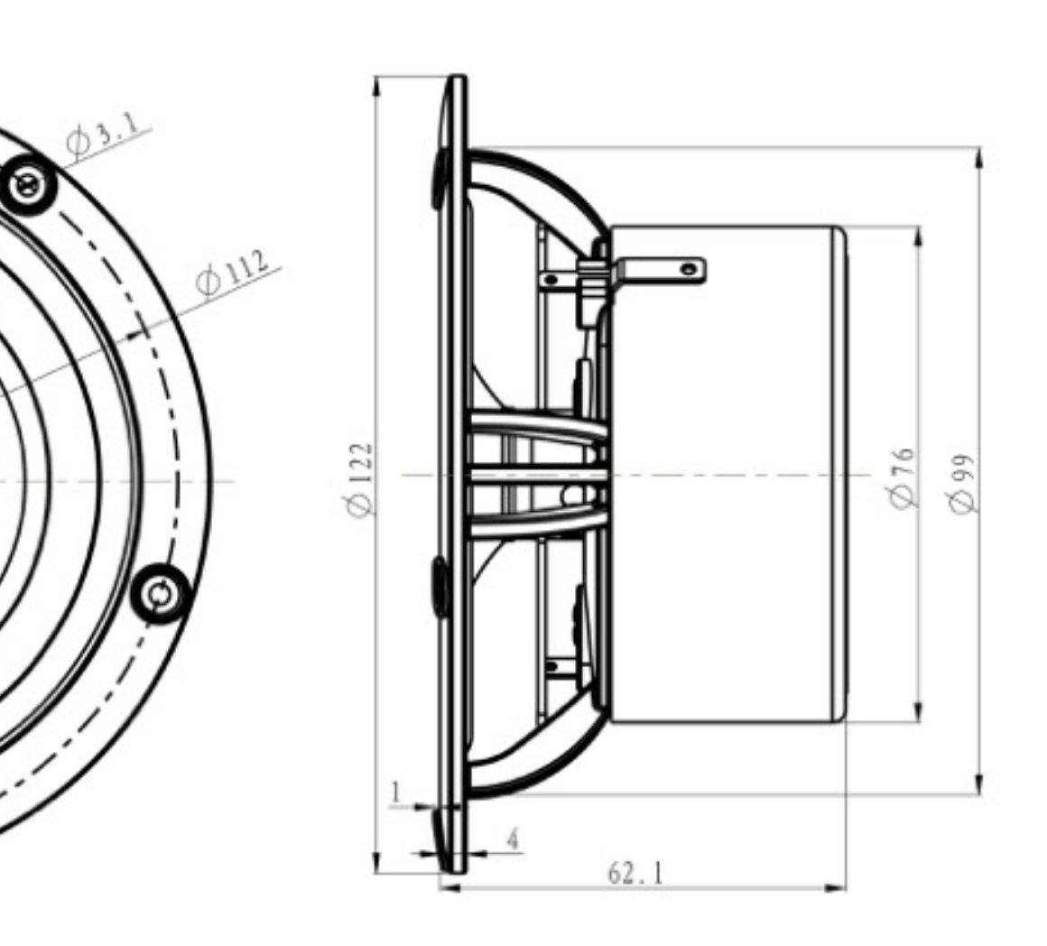

I've been having trouble determining from photos whether the driver should be slightly sunken in to the baffle or mounted on top - I suppose the primary resulting factor here would be the distance from cone to rear of the cabinet (albiet small). If it's on top I'm considering using a thin (~3mm) facing material for a nice face finish.
The other topic I'm looking for guidance on is the cabinet stuffing as it's not easy to source in Australia. Is it really any different (or different at all) from polyester filling material for cushions, etc.? ei Excel Fibre Hobby Fill
While during my active building days I personally got a bit too anal about rebating all FR drivers for flush mounting, including Fostex FE / FF series with thin stamped metal basket frames, it’s probably a bit OC to insist in applying that to any make / model with a thin and tapered profile external flange such as these. But considering the very shallow overall depth and profile of cone, and the efforts extended to reduce restriction of airflow around the mounting legs and motor assembly, chamfering or radiusing the the rear side of driver opening - particularly with baffle material any thicker than let’s say 12mm (1/2”) - should be considered mandatory.
