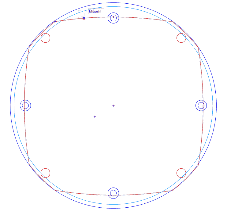

Attached is a comparison of the A7.3 vrs FE126En rebate. The dark blue is the A7.3 with bezel cover, the lighter blue without.
If you have a P10-hifi flat-pak then the baffle is 18mm, and althou tricky, you can just rebate for the A7. If you use the bezel cover (we don’t use it) then no one will know it started out as an FE126 rebate. If you don’t then some fill will be needed to make it pretty.
Alternatively you can ream out a big hole on the baffle and fit a supraBaffle (lots of options wrt shape) and rebate it for A7.3.
Yes, the A7.3 will need a bit more damping. All below the driver. We supply 40g for each speaker, but typically only half of that is needed — room, room placement, taste all play a role. We supply FE126 flat-paks with 40g as optional fill for under the driver (usually not used), so half of that in each speaker will get you into the ballpark.

Yes, I have the P10 flat pak. Ok, this gives me some options.

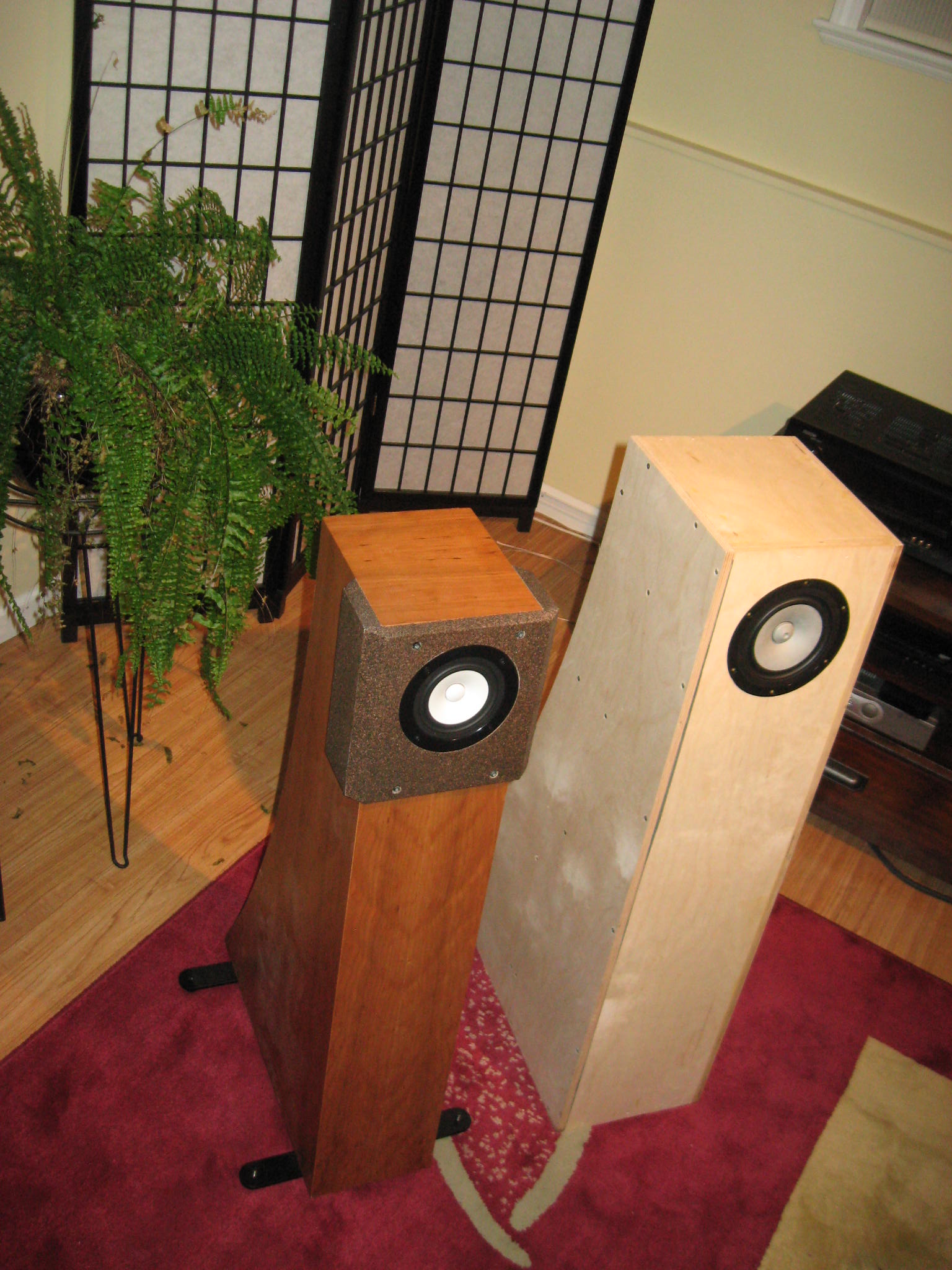

Attached is PDF of my CAD drawing for the CNC patterns for these, as well as the first photo I could find in my files of an FH3 fitted with the SB - seen with MAOP7, and a prototype build of FHXL . If you're interested, there are a couple of kits of the supra-baffle parts for both FE126 and A7.3 available.

We built a few with removable baffles, and I embedded M4 threaded inserts (not T-Nuts) in the enclosure, and counter sunk holes in the removable panels. We also extended them wider than the full 170mm, and added little return pieces to wrap around the sides.

Thanks for the specs. I'm going to try doing them myself since I'm slightly more DIY oriented than I was back when I bought the flat pak 4 years ago. However, if I fail miserably it's nice to know you still have some for sale.

All imagineering aside, and absent any scrupulous acoustic measurement "proof" I can't honestly say they do.
If you mean to hog out the driver opening to something like that shown in my sketch, and add another layer to the front to match the new driver plates, I can't see why not.Also, would it hurt to glue a permanent piece to the front middle/bottom to match up with the baffle (skipping bevels) and make the front completely flush?
For the A7.3s, I'd suggest at least 15mm material (without extra bezel ring) - or 18mm if with.
Just be sure to chamfer the rear side of driver openings.
