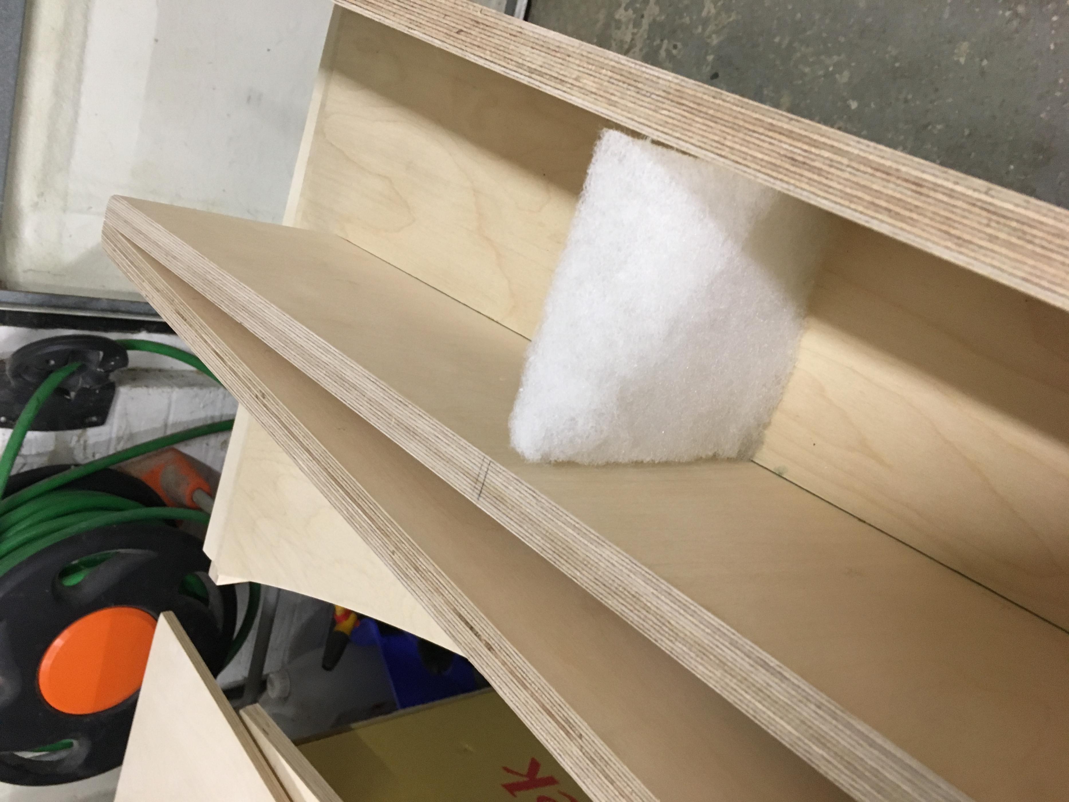

The driver I have is the Alpair 7P's and I have stuffed the V with 30g and the front with 30g. Is it just the front I play with? And is there a rough guide as to what to expect with no stuff v's 30g stuffing? TIA
garym999, good to see the build coming along nicely. Look forward to the final product soon. 🙂
Edit: Looks like you have sealed the cabs? Stuffing is likely to a be bit system and room dependent. Probably a good idea to play the speakers first and adjust accordingly. Driver break in already done?
Without the extra fill below the driver, the Alpairs could sound a bit bass heavy - particularly if situated near a corner. The tricky part of course is that if not well broken in, the Alpairs will open up after between 100 -200 hrs of playing time, and you might need to adjust stuffing. Unlike with my couple of Pensil builds, I found that well teased out recommended amounts above and below the driver worked quite well.

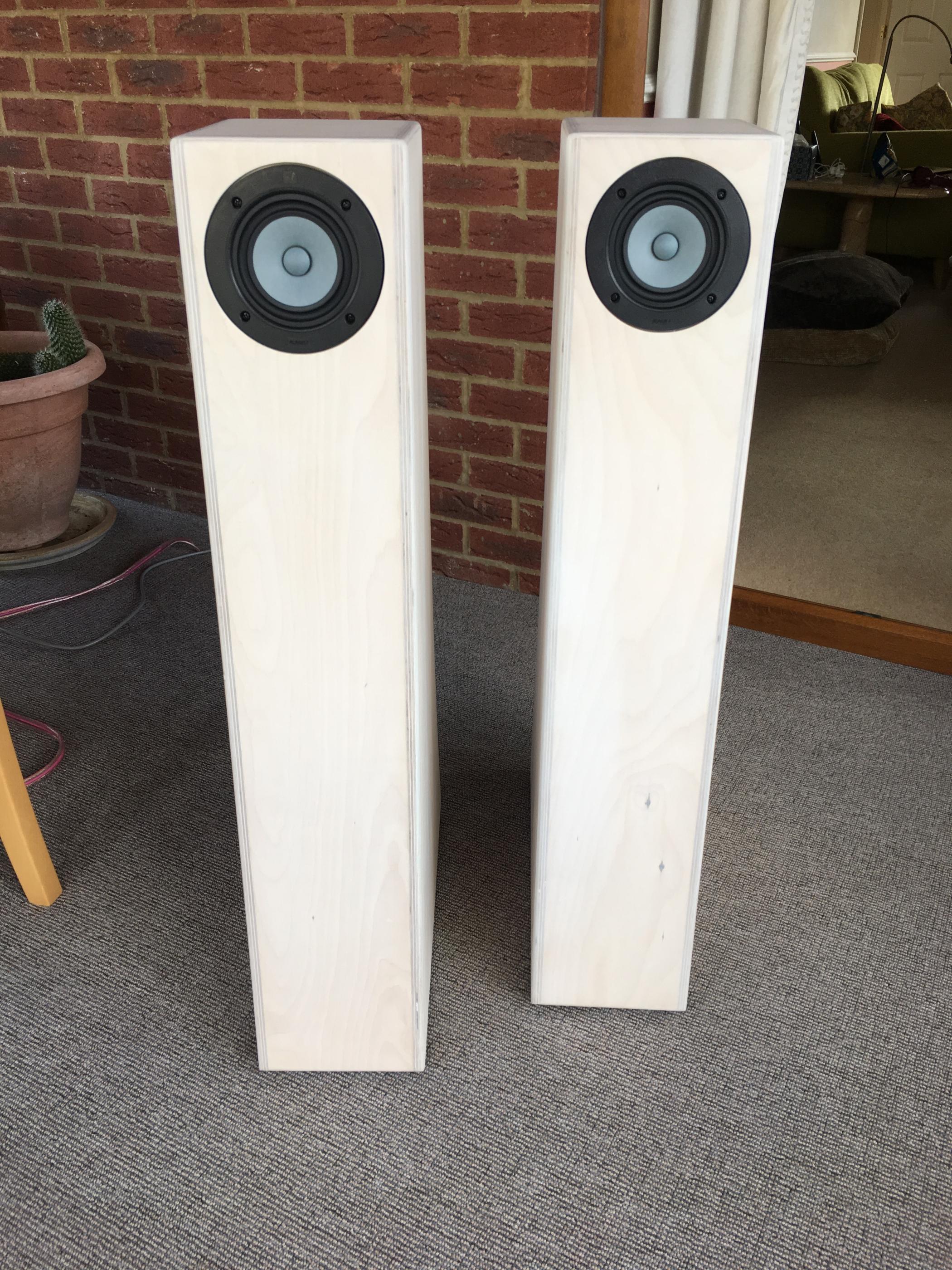

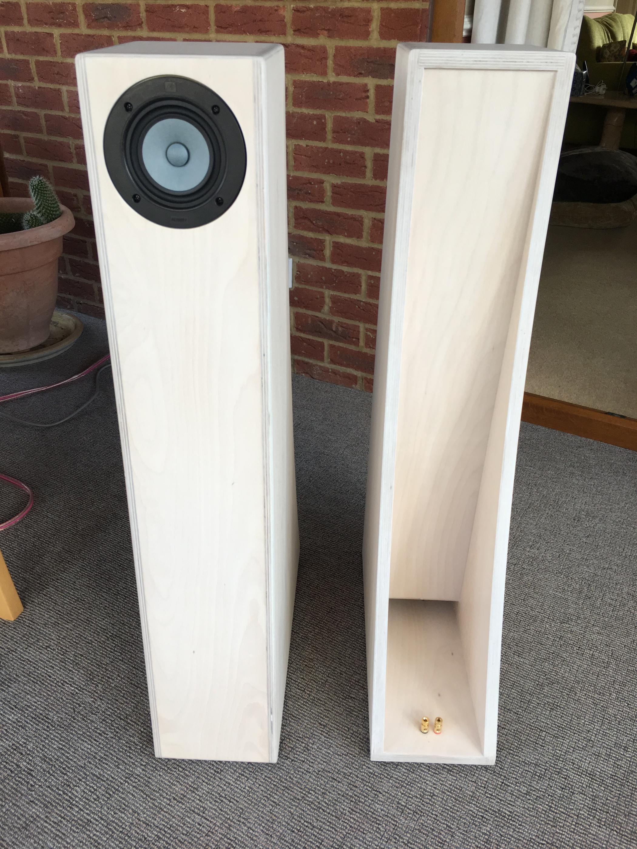

So here they are...
First impressions, bass nice, tight and fast. Obviously does not go real low but I like what there is and that is from a bit of a bass junky. I'm finding the middle a little bit fatiguing, too bright.
So I'll be intrested how the next 100hours changes them. Also have the stuffing to play with.
Trouble is that these and the Modulus-86 amp I have just built is revealing the difficencies in my source, namly a squeezebox and a large MP3 collection. So step one to address this will be to re-rip the CDs as FLAC then I need to consider the player options

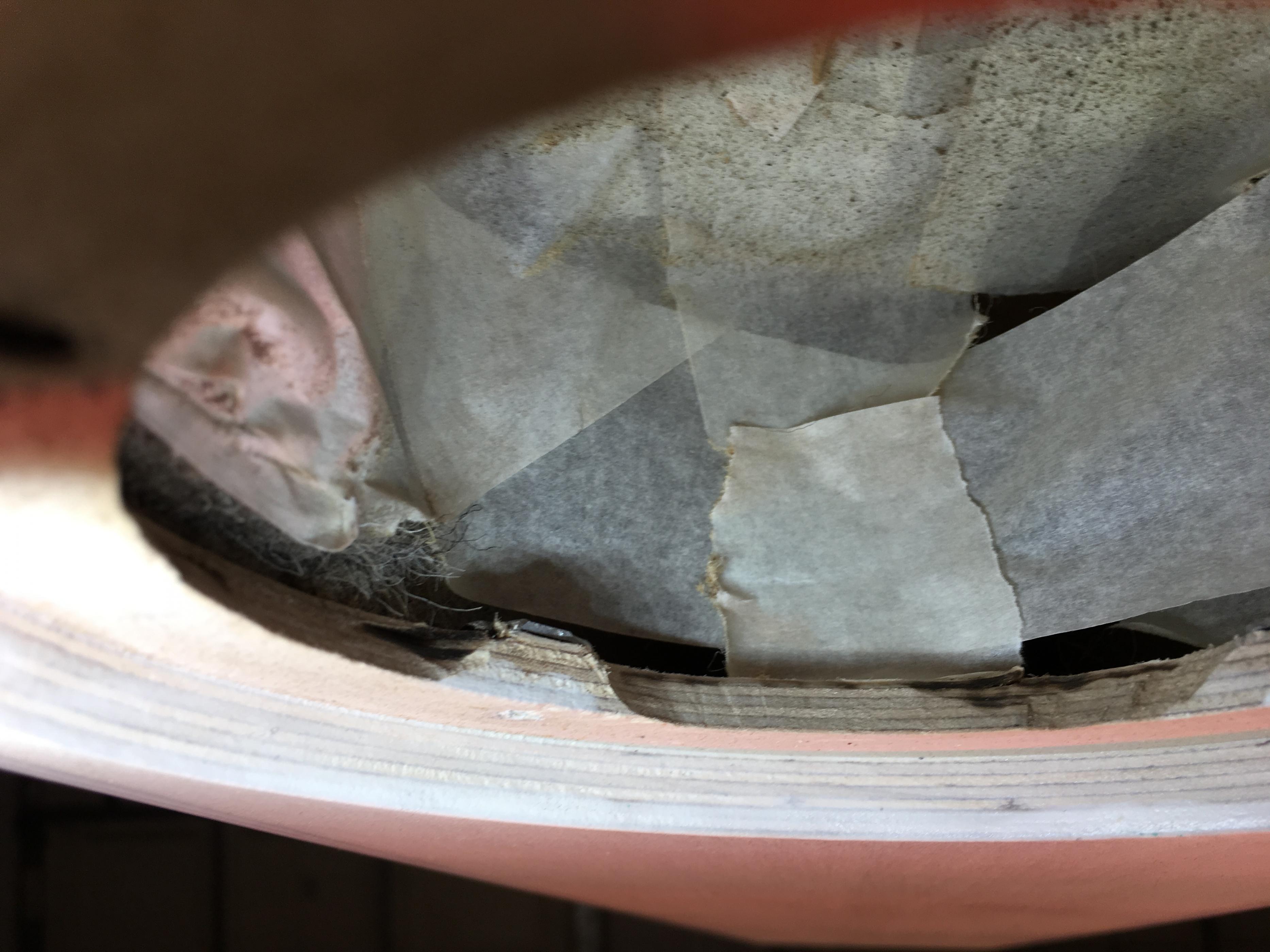

I found one issue and that was that I forgot to open up the rear of the baffle. I meant to do it but got lost in the build.
I thought it was going to be really hard to resolve given the cab is all glued up but it turned on not to be such a truma. I made a working surface out of scrap MDF and was able to cut away around the baffle by using my jigsaw set at 45deg. Not the best of finishes but sorted.
It has softened the sound a bit and brought out the bass more. But still a little bright for my tastes.

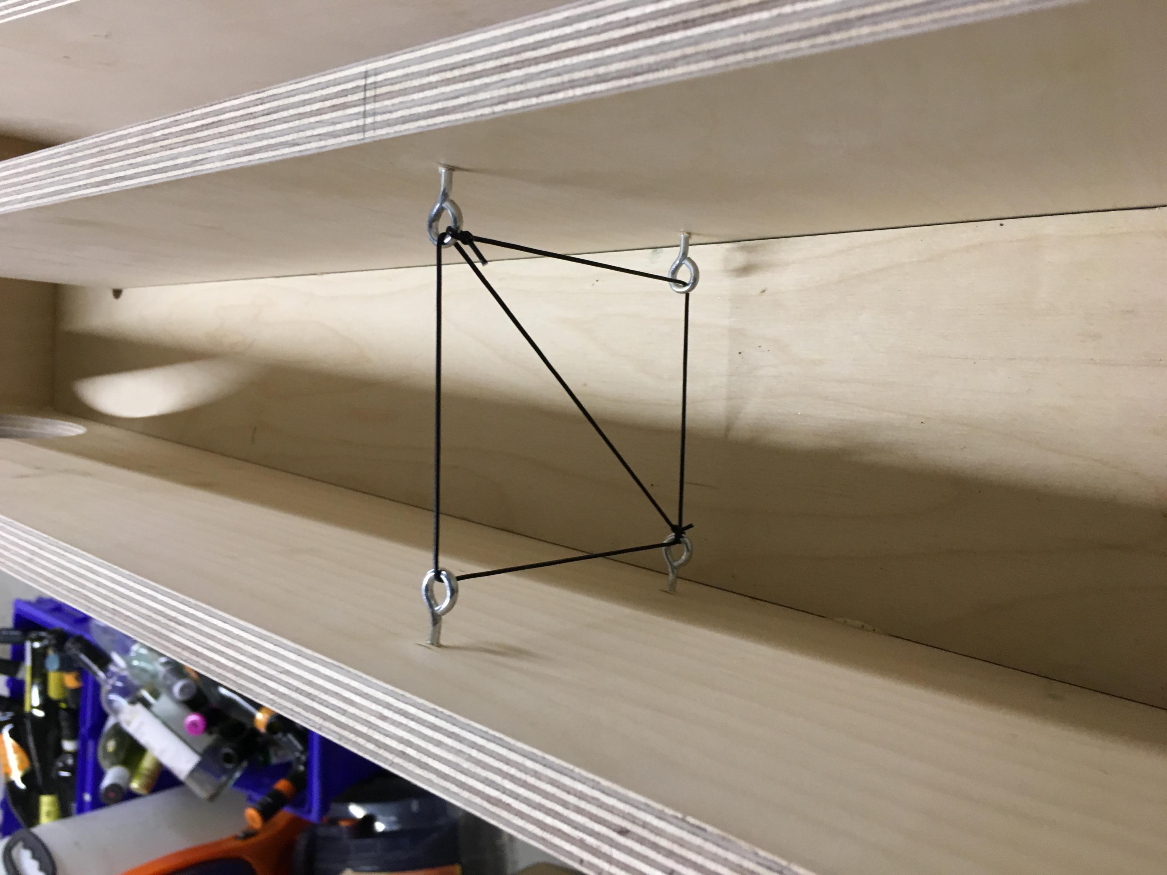

For Frugal horn build how to put stuffing below the speaker driver? do we need to put any mesh like net for holding the stuffing in place or how do we put stuffing below the driver?
I created a suspension wire using eyes and then placed the thinest layer of sheet with a few spots of super glue to hold it in place. That stops the fill from getting lost.

Nice work with the suspension, and I am assuming that the thin sheet is working for you. Personally I would be more comfortable with some thing with more holes in it vs the sheet you put in place. In your case, probably a few more criss-crosses of the string over the eyelets would have been enough also to keep the poly-fill in place (no sheet required). 🙂
