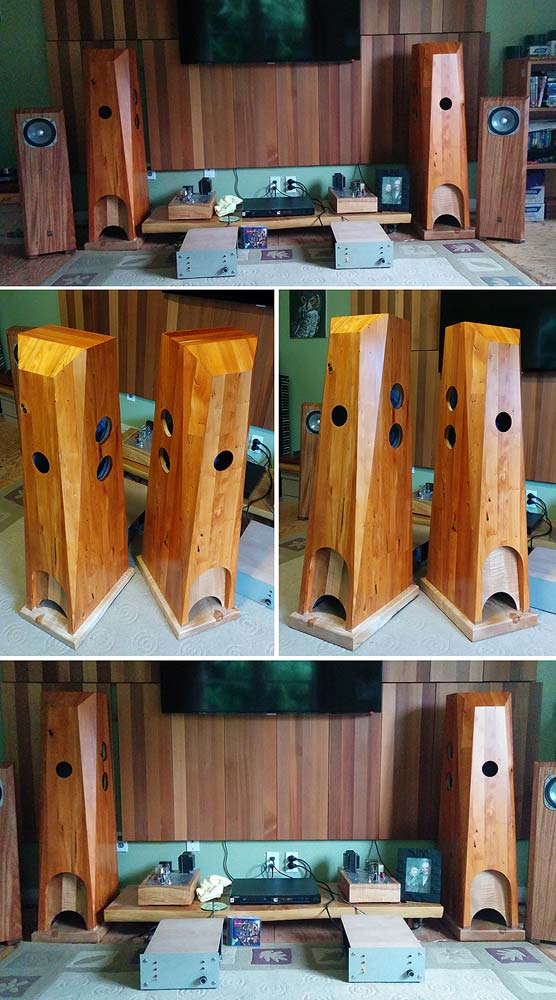

StealthWoofer plans:
Hang tough, i am working on plan updates. And actually checking what we built.
The plans have about 20 litres gross internal volume but are based on a 75° isoceles triangle, we may have built a 90° one. Turns out 90° has less volume than the same width smaller angle.
It is also the case that it has a height designed for the FH1.
dave
The facets are an ML-Voigt, under the uFonkenSET in an ML-TL.
The 830870 ML-TL is a little shorted than the FH3, and less cross-section volume than the 75° stealthWoofer i posted earlier. With only a slight volume increase you could use 4.
For that same slight size increase you could use 2 Silver Flute W14 ML-TL we use in Tysen V2. The line is close to the FH3 height but still a tad shorter. The big advantage is that the SF is less than ½ the price of the Peerless.
Both reach an estimated 35 Hz F10 almost as low as the single SDX7. The sealed SDX7 is more ameniable to EQ and will easily reach 25 with a small boost.
dave

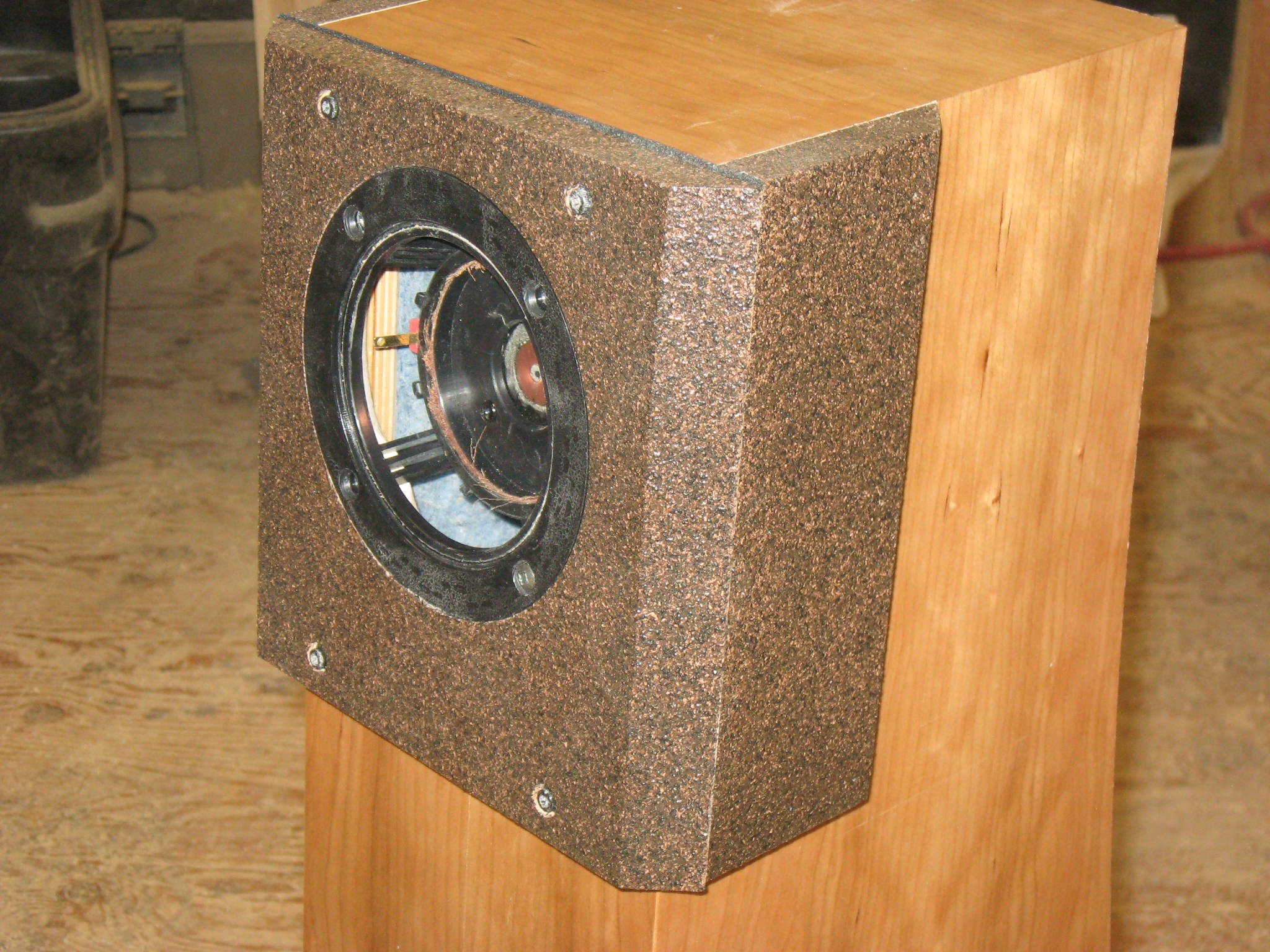

On the subject of baffles, perhaps this is something? – A superelliptical suprabaffle. I haven't found the look of suprabaffles appealing to my tastes. I've given it some thought, and a superellipse was suggested to me. The superellipse seems to work with the shapes of both the cabinet and driver. What do you think?:
What is the advantage of a add on baffle?
Adding a supraBaffle pushes the point that bafflestep occurs down in frequency — but to ensure a smooth transition it should have a trailing backside and edges that are not abrupt, something that makes it more teardrop shaped.
One has to be careful that the baffle isn’t so wide that it overlaps the gain region of the horn.
A suprabaffle can create more room for a larger driver — ie fitting drivers like the TB W5-1611 or Fostex FE138eSR. It also gives more clearance for the magnet vis—a-vi the central divider.
A removable supraBaffle — even a simple one no wider than the box — makes it much easier to try different drivers.
In practise i have not seen that many FH3 with suprabaffles.
dave
I've built my fair share of all three sizes of Frugel-Horns, and several other of Scott / Dave's designs for that matter, and the only ones used on the FH were "vestigial", to facilitate the experimental swapping of drivers.(seen below with "dead" Alpair 7 used for fitment test) As I tend to take an aesthetic approach, I find the elegance of their shape diminished by the addition of anything much larger than that.
As Dave implies, the LF gain of the rear mouth horn requires less BSC than, say a stand mounted milli-Fonken with the same driver.
