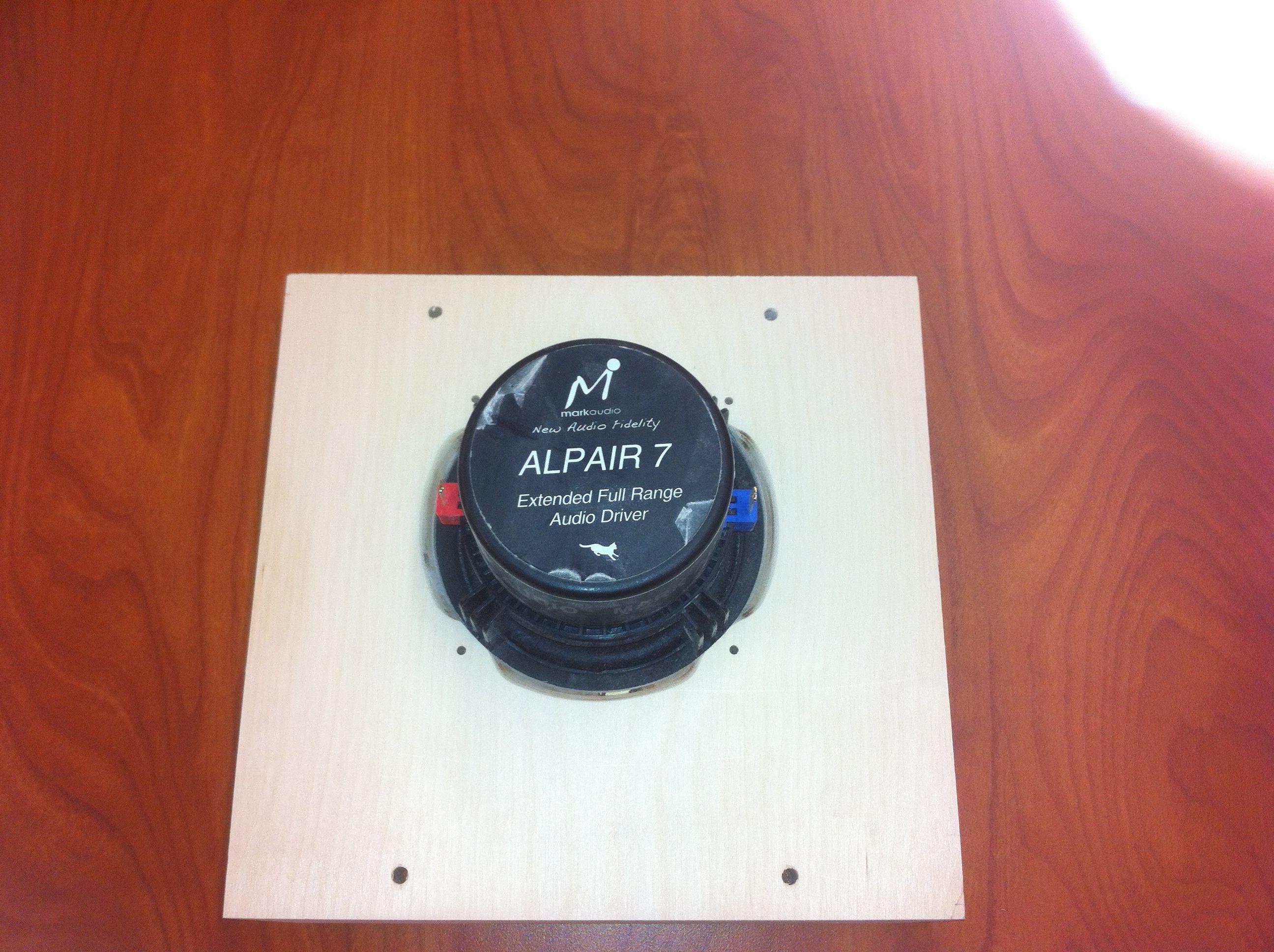

I am just about to start building my pair with MA 7.3 drivers. I have a 15mm birch plywood (11 layers). When i rebate approx. 9-10mm I will end up with 5-6mm. Is this enough to support the drivers or maybe I can glue extra 4mm wooden ring inside (behind the driver)?

Philip - I've built dozens of pairs of flat pack kits for that exact driver using 15mm BB, and if you use the (excellent) supplied screws and carefully pre-tap the pilot holes, I think you've got nothing to worry about. As I've said before, this ain't the cylinder head of a Cummins diesel engine you're torquing down.
Don't forget to chamfer the rear side of driver opening, and scallop around the location of the 4 mounting screws
… and if you use the (excellent) supplied screws...
Can’t be said too often…
Do not overtighten the screws. They should only be tight enuff so as to just hold a real or imaginary washer from turning.
