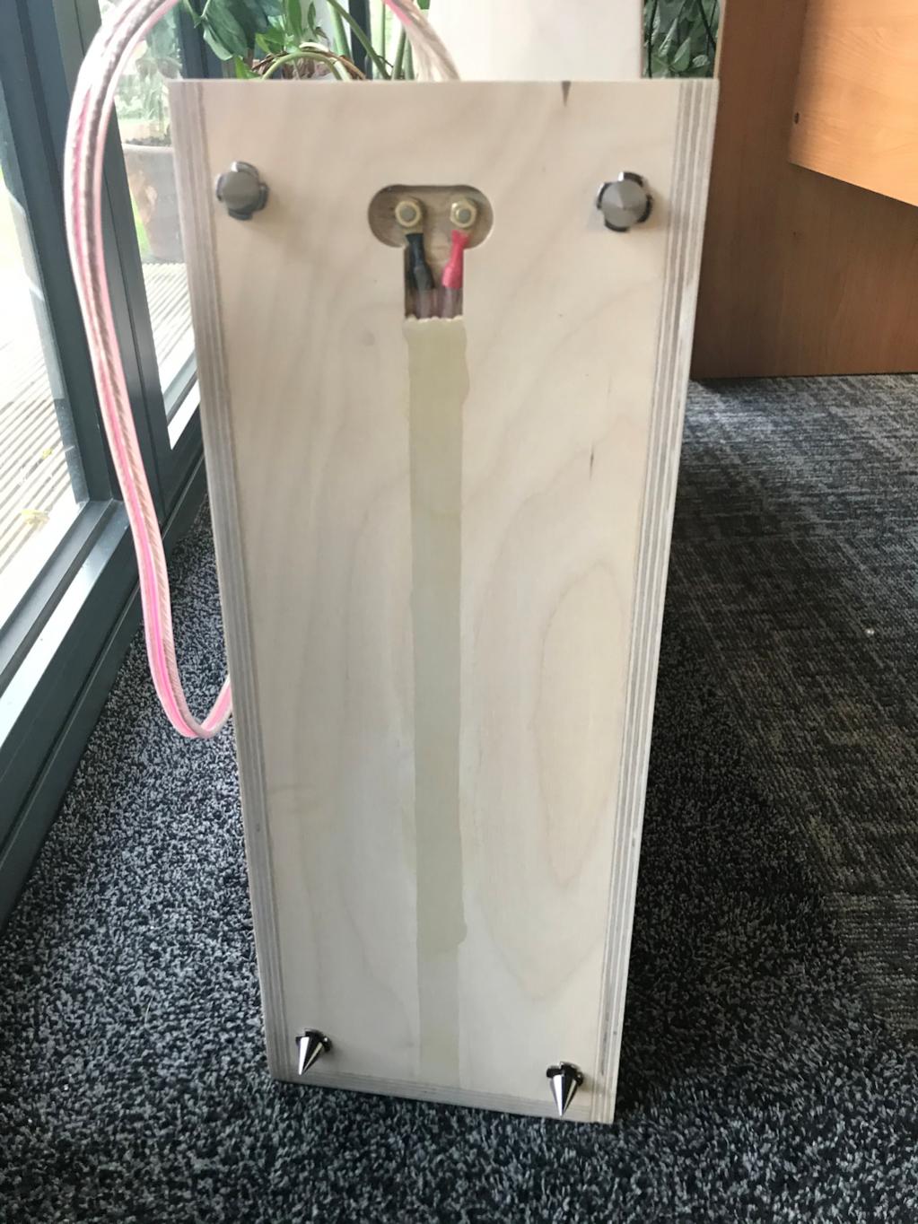

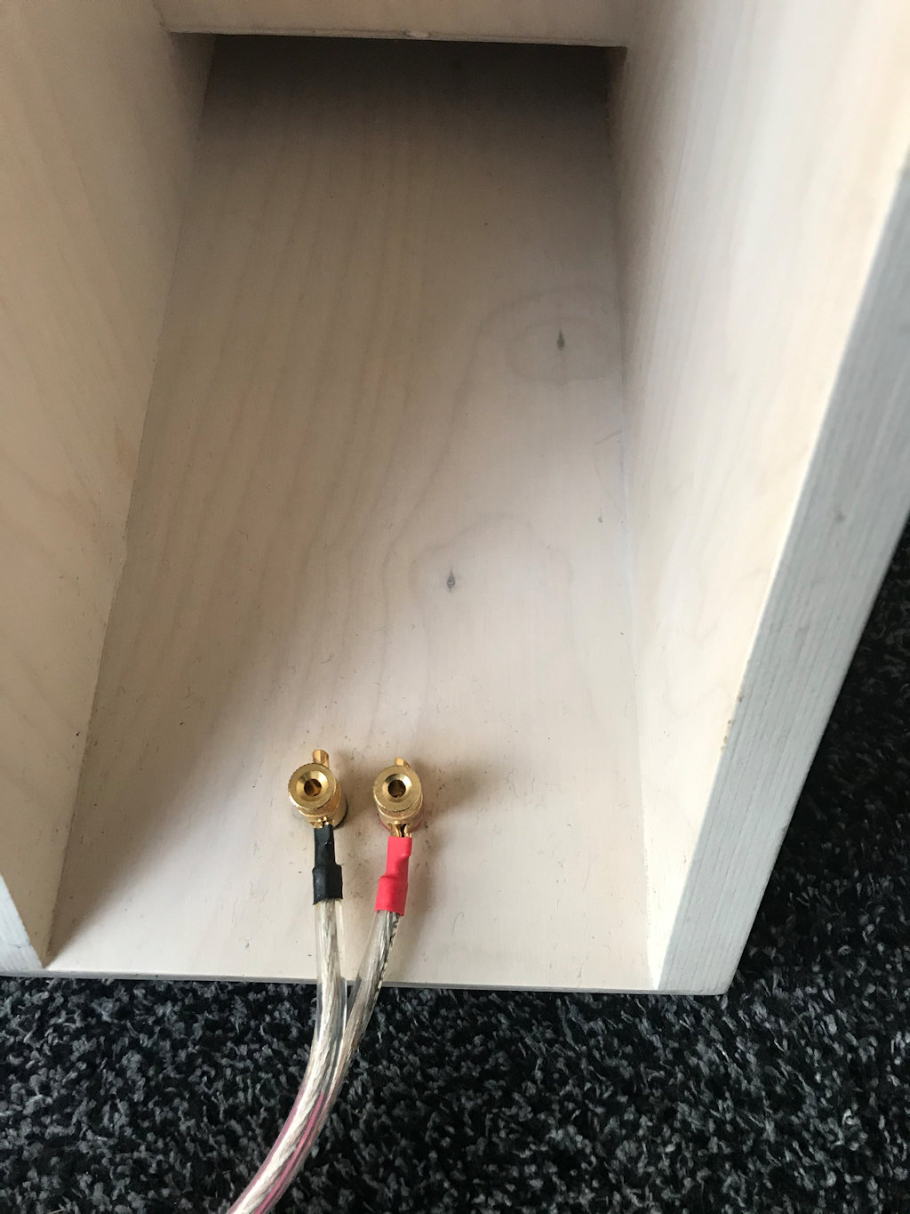

I'm finally back to my horns after a long time diverted on other projects primarilly building a garden office. That’s all but done and my horns have found a new home there in front of my desk.
My solution to the binding posts was to mount them on base at the mouth of the horn. I then rebated the rear of the base to route the cables. I just thought if the cables are going to trail the floor may as well put them down there already.

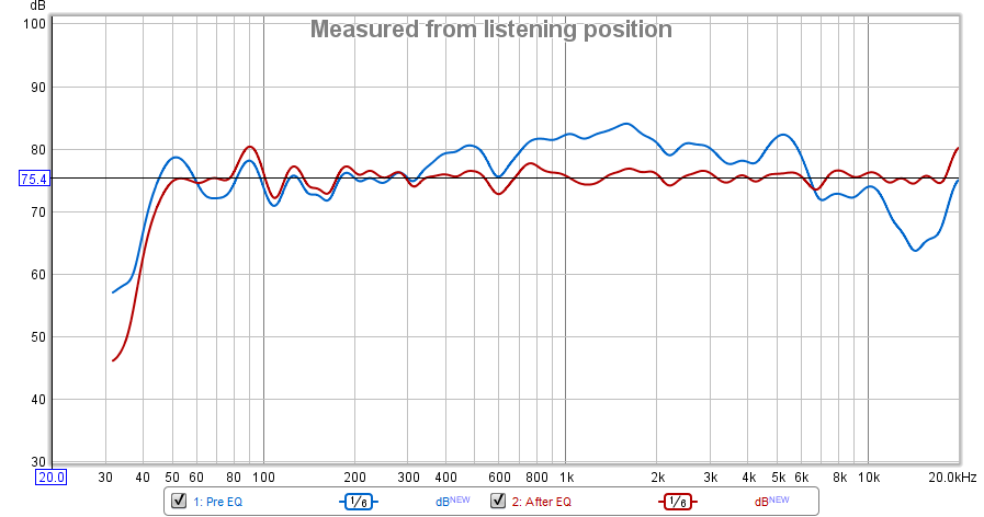

Another reason for not doing much with the horns was that I did not like thier sound I found them well, just too fatiguing and not having any means of measurement I had no idea what was going on. So, I invested in a UMIK-1 and somehow a MiniDSP 2x4HD landed in the cart. After playing with REW for a little while and fumbling around I’m now enjoying the speakers and getting some hours in.
Gary, tidy solution - what material did you use to fill the routed channels on bottom plate, and which drivers?
The cable channel was filled with two-pack wood filler and sanded back. I did not spend too much time on this as you can see. It is the underneath of the speaker afterall.

Can you post some pre-EQ measures?

Gary, I think your above post contradicts the legend on bottom of graph . I’ve heard the 7P and while I definitely prefer the A7.3, I wouldn’t describe the former exactly as harsh, as compared say to a Fostex FE126 - whose more forward upper midrange presentation I do find a bit fatiguing, particularly on certain solid state amps, like cheaper class D.
I don’t think the FH3 is the problem, and if you’re in a position to lend your ear to a pair of A7.3, or any of the newer metal coned MA drivers in that size range - in any enclosure - I think you could quickly confirm that maybe the 7P is just not your cup of tea.
Hi Dave the Red trace is pre-eq Blue after.
Thanx.
I think Chris is right about red & blue being swapped. I would have expected a bit more peakiness, but your measure shows a strong upper midrange/lower treble lift.
dave
Sorry gents, yes red/blue swapped. The text on the graph is correct

These are my first FR speakers and I am impressed overall. They should be well run in now. I have considered alternative drivers but would like to try and tame these more first.
PS on a leaning cliff with the DSP, mic and REW so if you see anything amiss please let me know.
The first time I heard the 7P's up at Dave's, that's exactly what they sounded like. If you'd have put a blindfold on me, I would have sworn that they were Fostex drivers that needed a lot of break-in time.
