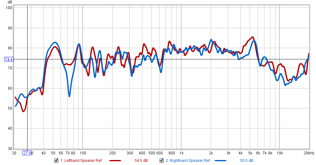

OK so I'm green with REW, UMIK & miniDSP 2x4HD but I'm finding it a great way to play and investigate.
After a couple of passes I'm certainly enjoying the horns+MA, Before I could just not settle into them or give them any prolonged listening. With EQ applied I've had no reason to stop :). My tastes seem to favour the addition of a Low Shelf filter to lift the low end from 100Hz.
Previous measurements were based on just one speaker so I thought I would compare the two at the listening position without any EQ. I was surprised to see the dip at ~72Hz on the RH speaker. At first I thought there was something wrong with the speaker but swapping positions they showed the same response on the RH speaker again. Of course I'm showing my naivety here as I soon realised it’s a room mode/positioning issue. The RH speaker is towards a corner.
I've played with the stuffing again and did not see much change in the results what would I be expecting to see/hear?

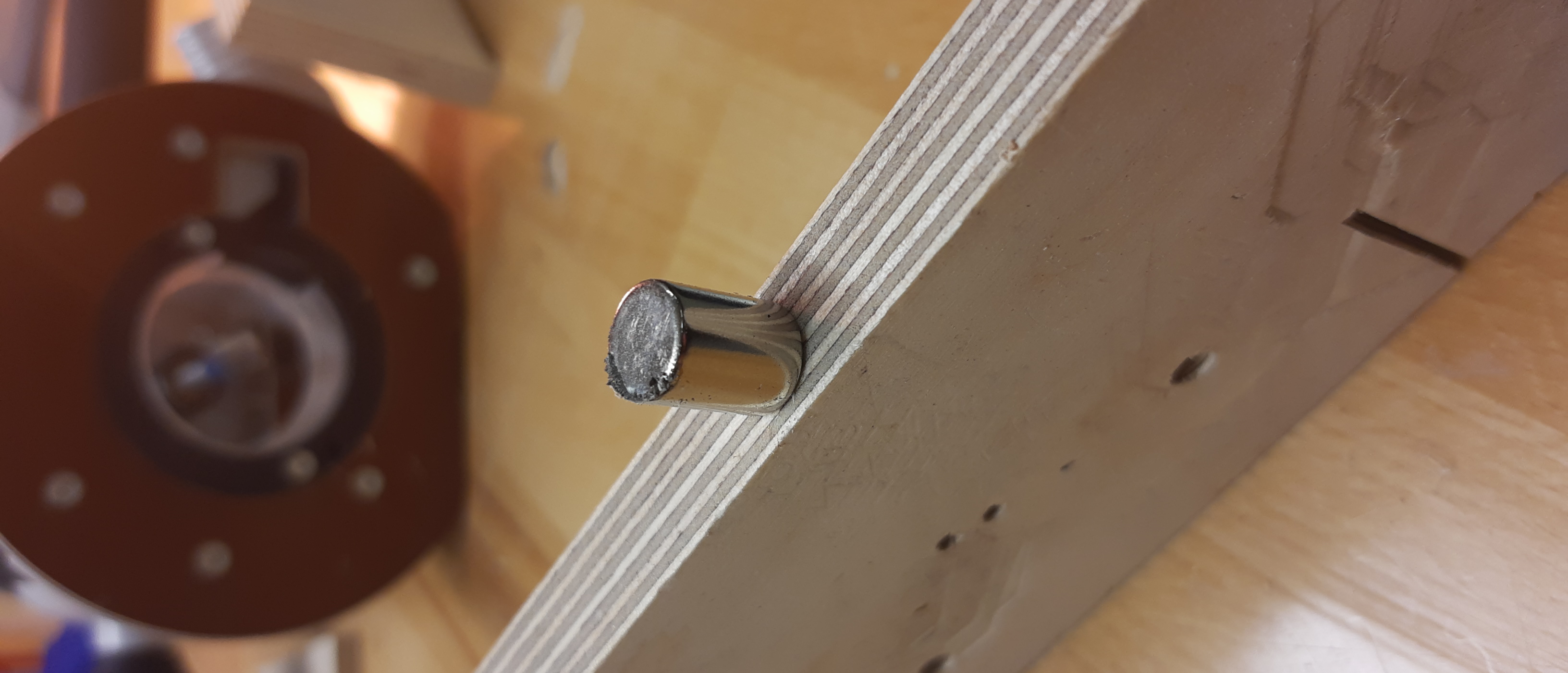

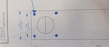

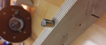

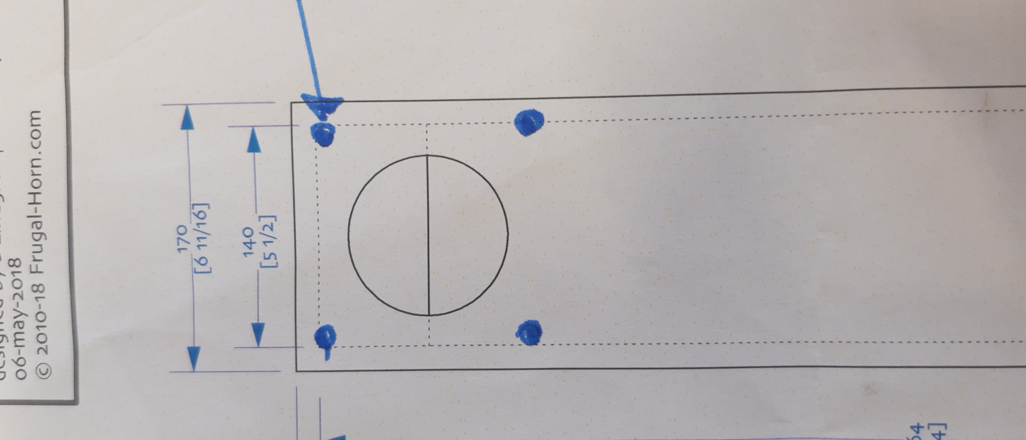

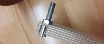

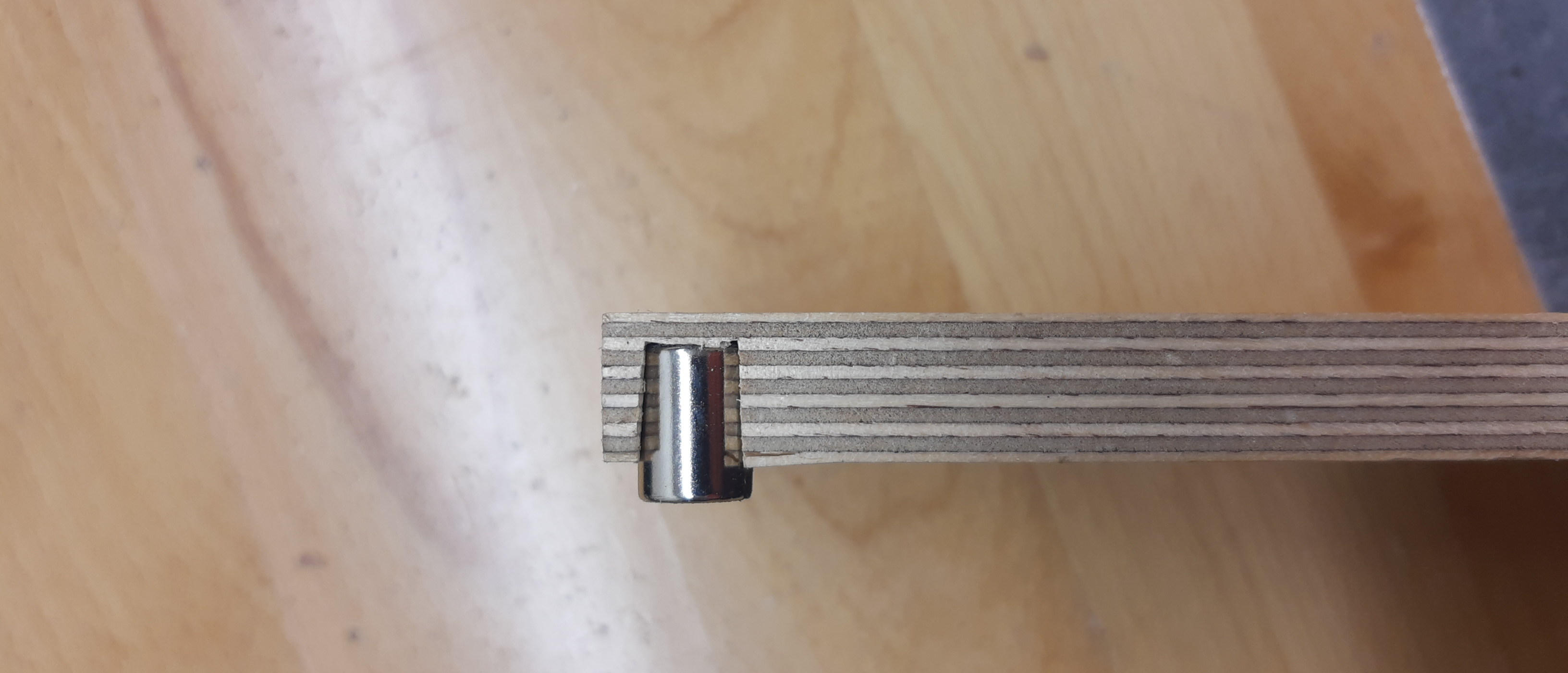

I have read most of this thread and it has been inspiring, now I can no longer resist the temptation and have begun to build a couple of FH with MA 7 drivers.
Speaker grills become necessary (WAF and kids), when I listen I will probably take them off.
I think I want to put magnets in the back of the front plate before assembling, and a little bit of Iron in the corners of speaker grills, so when you take speaker the gril off there is no visible magnets ,the magnets is 2 mm. under the wood of the front plate.
I want to place them so that they all have the same distance to the device, so the magnetic impact will be the same from every side of the driver.
The question
can this solution affect the driver magnetically , the MA 7 driver is magnetically shielded,i ask because I have no experience with this and want a good and pretty result.
For illustration see the photos.

The magnets will not effect things.
You want to use a magnet in the baffle under the veneer, and corresponding magnets in the grills.
Take care to get things aligned and the correct orientation of the magnets.
I am always thrilled with how the grill just pulls itself into place when you put it near.
(Note: this is 2nd hand, look for chrisb post that describes the process in more detail)
