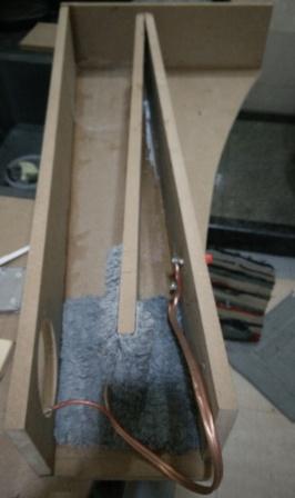

I use a Shanling MC30 - a 3 watt tube SET setup all in one. Considering that I had a low power tube amp I chose the Mark Audio Alpair 7p with the paper cone as the SPLs were slightly higher as against the 7.3s ( though unsure if the 87.5 db of the 7p is sufficient for my tubes...there seem to be so few builds with the 7p )
Build was with 17mm MDF. For the side padding I just used a thick cotton foot mat. Damping filling is currently optimised to 30 g at the back and 20 g in the front. More filling in the front really puts down the bass while taking them fully out seems to introduce a boom in some lower frequencies. Have them about 8 inches from the side walls and 15 inches from the rear in the room corner (11 x 15 ft) well toed in.

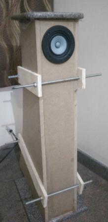

If we want to make FH3 with a removable baffle so that if needed we may change the speaker drivers in future, which is recommended way to do it:
1. cut front baffle piece into 2 parts, bottom part fixed and have to top part removable and cut to fit a particular driver as shown below:

Hi sarathssca,
My build featured a removal smaller baffle (supra-baffle) - the main front baffle had a cut-out around the driver area, and the removable baffle was fixed on the main baffle. The builder in the other post you linked went one step further and made a removable "top" also - which I am assuming is for accessing the stuffing from the top.

FWIW, I approached this by fabricating the front panel with a large rectangular opening, fitted with threaded insert fittings in the corners, and attached the removable driver mounting plates with machine thread screws. The driver plates were sealed with thin closed cell foam weatherstripping. I tried to come up with something that would sit the driver plate flush, but my limited pea-brain couldn't come up with an easy method that would allow for quick field changes that didn't require a redesign of the whole product.

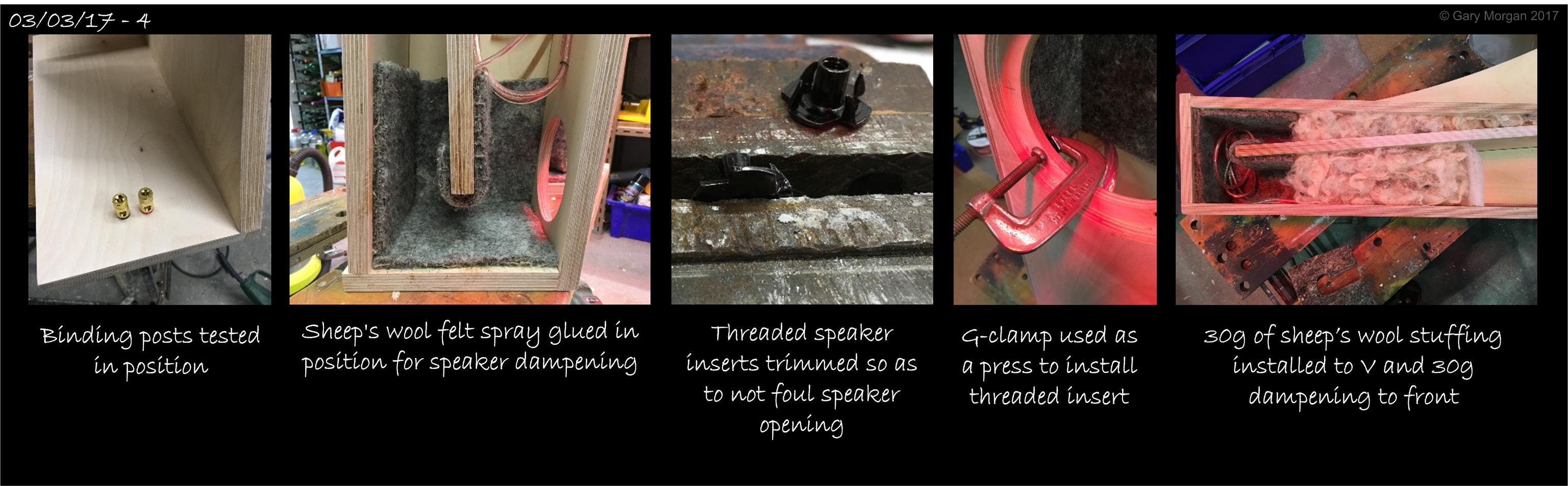

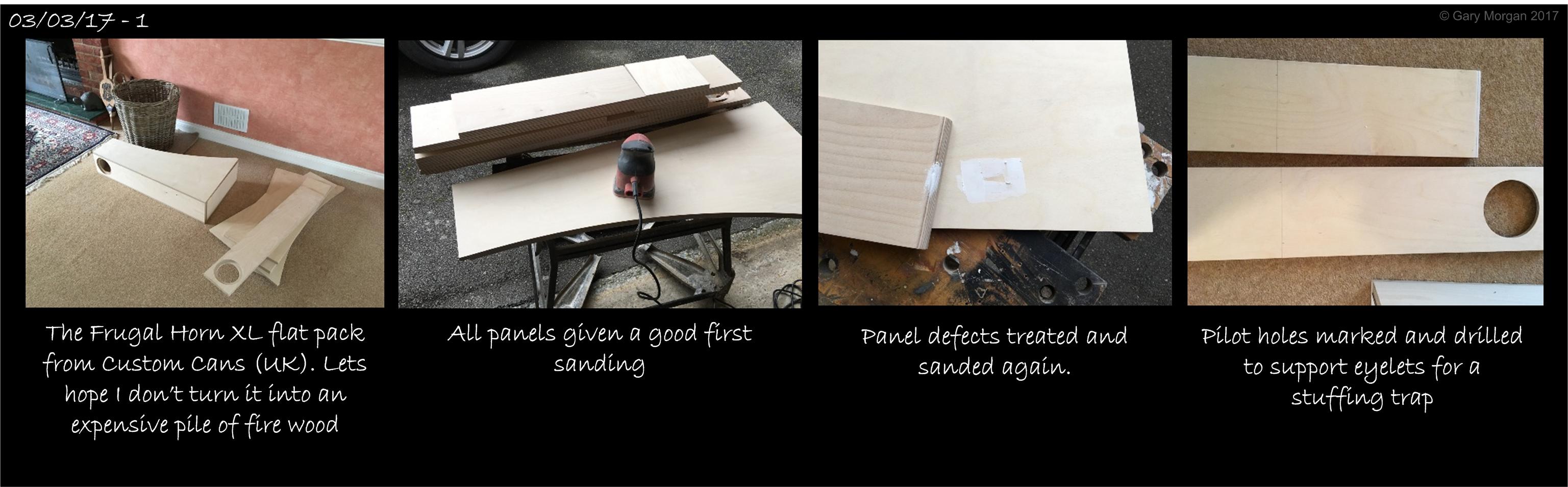

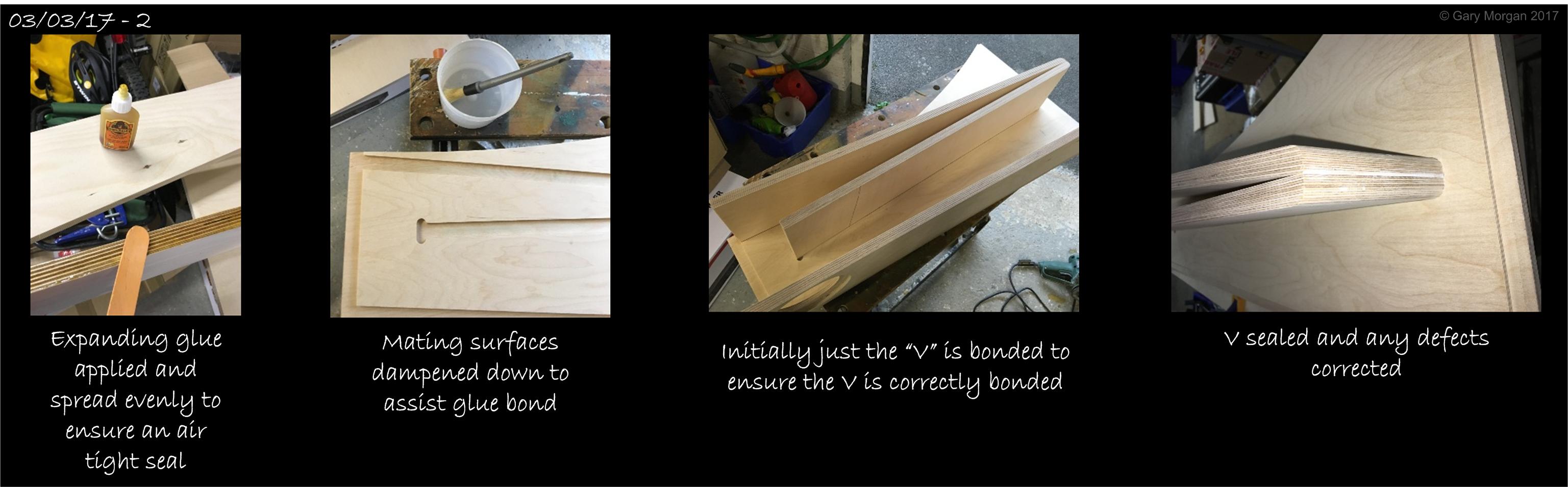

After lurking for a while I finally bit the bullet. On Friday I picked up my flat pack from Custom Cans.

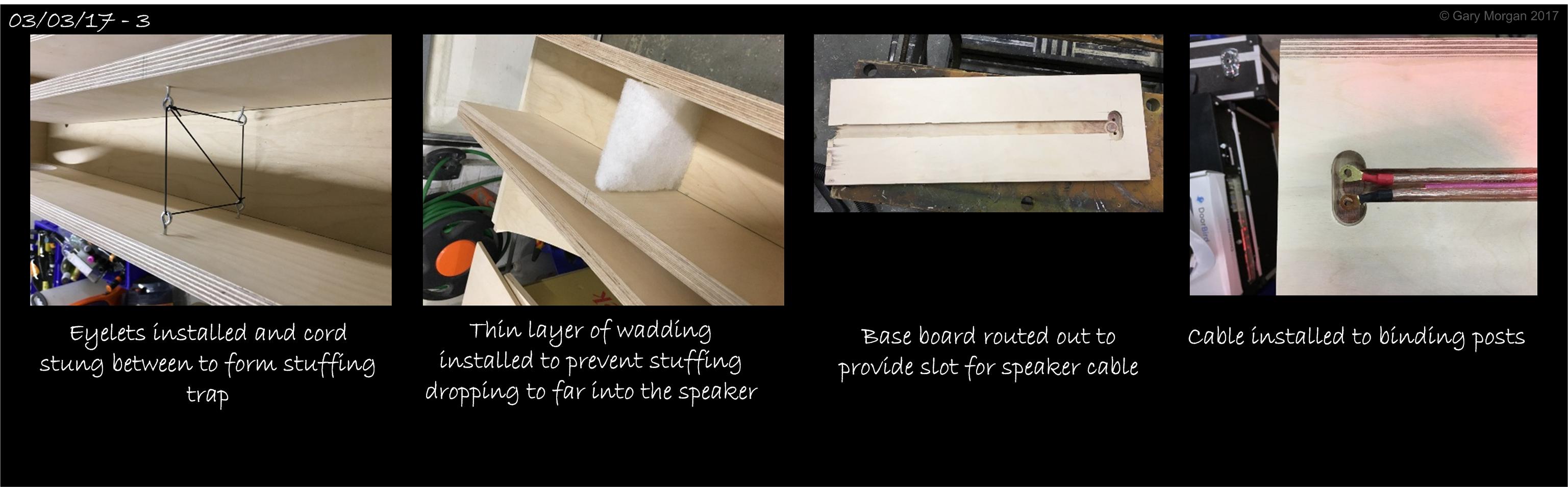

So I thought it time I ask my first stupid question... Speaker terminals. I'm not keen with the cable dropping down the back of the speaker given that it is a floor stander. I'm thinking of fitting a pair of binding posts on the deck behind the exit throat about 1 1/2 inches from the back. So they would be mounted vertically with the hardwired connections on the underside. The speaker cable would travel underneath the deck and then enter the cab and run up the inside. Foaming glue will be used at the entry point to ensure it is all sealed.
Will the terminals affect the port in anyway?
As there was no answer I bit the bullet and deceided to mount the speaker binding posts on the base plate.

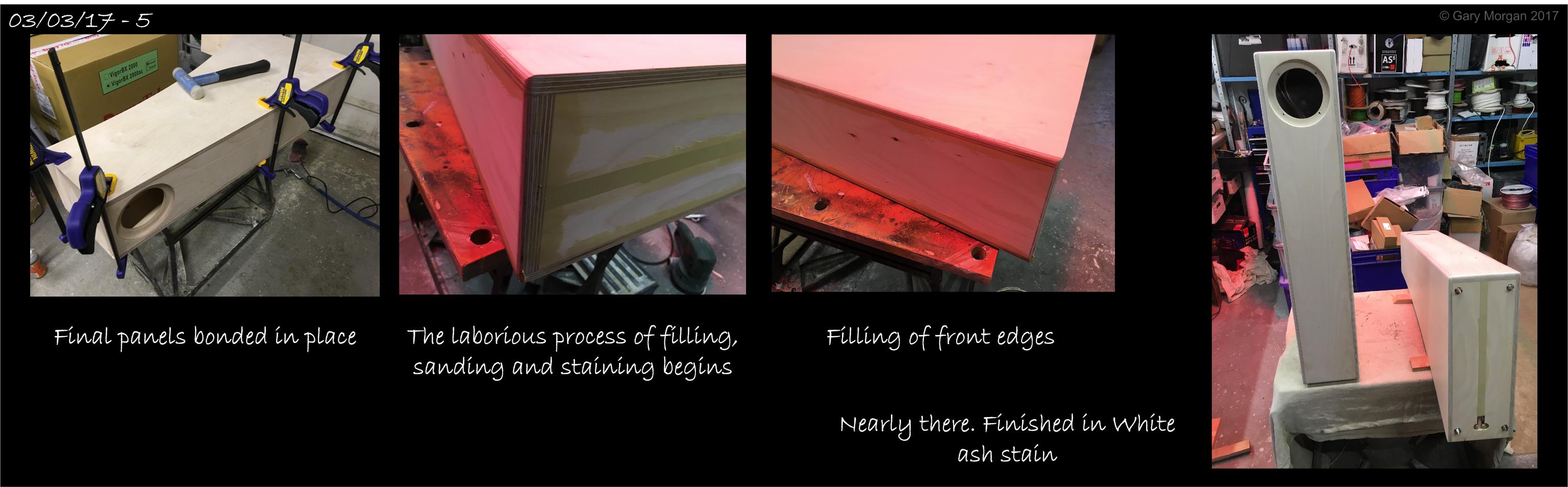

I have storyboarded my build so far. I wanted the natural look but also wanted the ply to appear whiter so opted for a white ash stain. This mean't loads of coats, sanding back and coating again.
Just need to finish that and the speakers can be installed.
gary - sorry you didn't get a timely reply, but it looks like you found an elegant,- if not quick- solution to the issue of wiring / location of terminals. I doubt the binding posts will be a problem.
nice build - yes, often the finishing takes longer than the build
