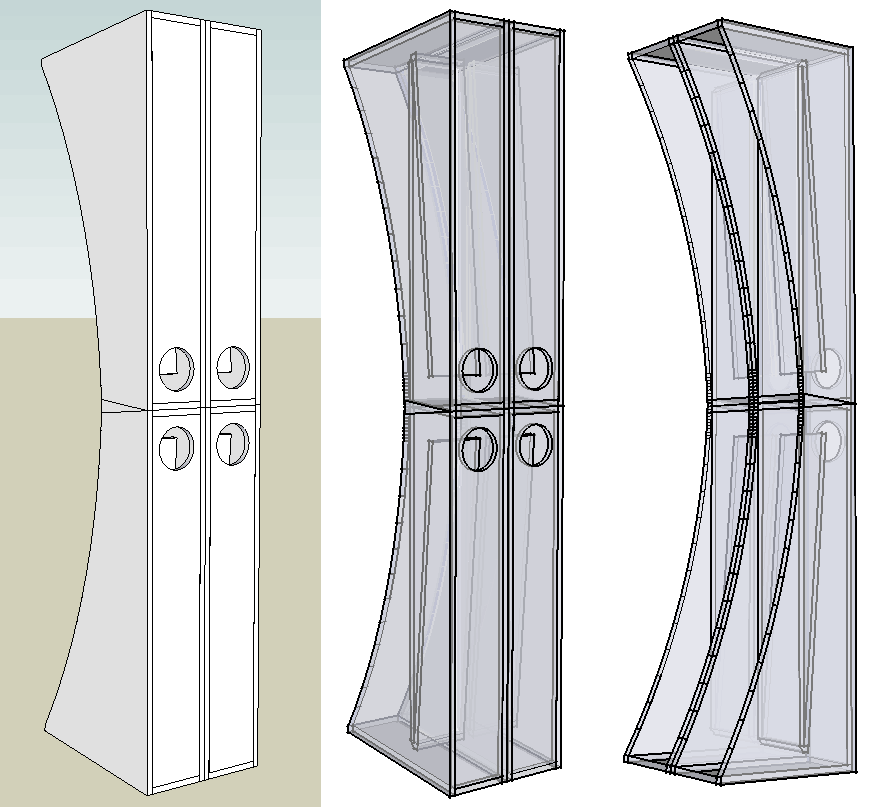

I'm under the spell of the vision of building a quadruple stack of frugel-horns, in the style of Ed Schilling's model 3. I will most probably attempt a build like this in a near future. I have a question about the slight backward tilt of the cabinets; if 'stacking' 2 frugel-horns up side down on top of 2 bottom horns, should the tilt be kept? Or is it a good idea to somehow compensate the tilt to make the cabinet front vertically aligned?
I think i have posted this earlier... i'd for one, be VERY interested in seeing someone have a go at these. As can be deduced from the visualization i have preliminary plans already.
attachment.php
dave
Wow!! Dave, thanx for the fast reply and for posting your 3D plans! I will definitely have a go at building these, now that I've seen your plans. Awesome looking and intriguing! I have built Scott's Valiants with Fostex 126En and I am very satisfied with that design. But Ed's model 3 has got stuck in my mind. I see you put a wedge between the lower and upper horns. Elegant solution. I assume that a multiple build like this has been one of the considerations when designing the frugel-horn. Absolutely gorgeous looking speaker! So what drivers would you put in this beast?
Actually just lazy... the target was the 3D not the drawing, so what looks like a wedge is the 2 tops intersecting each other. In practise that would just be a dividing panel, and there would only be one thickness in the middle.
In theory you could get away with none of those internal partitions, but to my mind they go a long ways to ensuring structural rigidity.
dave
