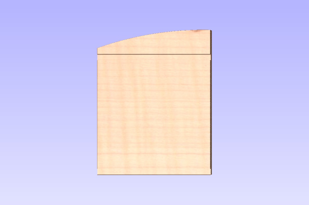

Hi, I just joined this thread and the CNC part of this piqued my interest. Can you explain the above statement? I have found a way to cut virtually any miter angle on the plywood edge on my 3-axis machine if that is what you are talking about and would be happy to share.
For example, I plan on cutting all the pieces on my machine for the DecWare Corner horn:
http://www.diyaudio.com/forums/full-range/169641-decware-corner-horns-3.html

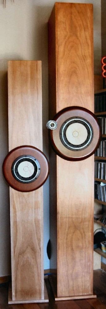

I made some stands to match the University Dean speakers I previously made on the CNC machine. They used the same 62.5 degree miter on the outer edges as the Deans themselves but this time I cut the miters on my Shopbot CNC.
Here is the link to the Dean construction but that was prior to me knowing how to cut miters on the plywood edges. University Speaker "Dean" similar to "Classic" 3D Model and Build - AudioKarma.org Home Audio Stereo Discussion Forums

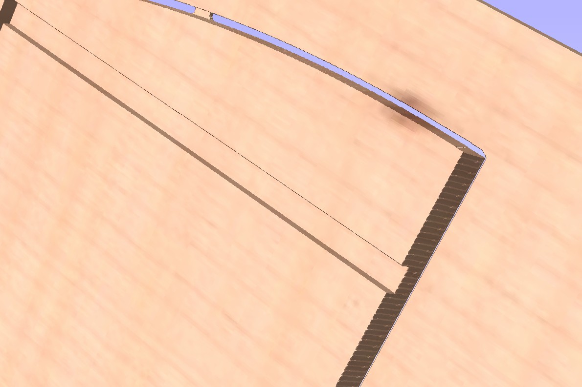

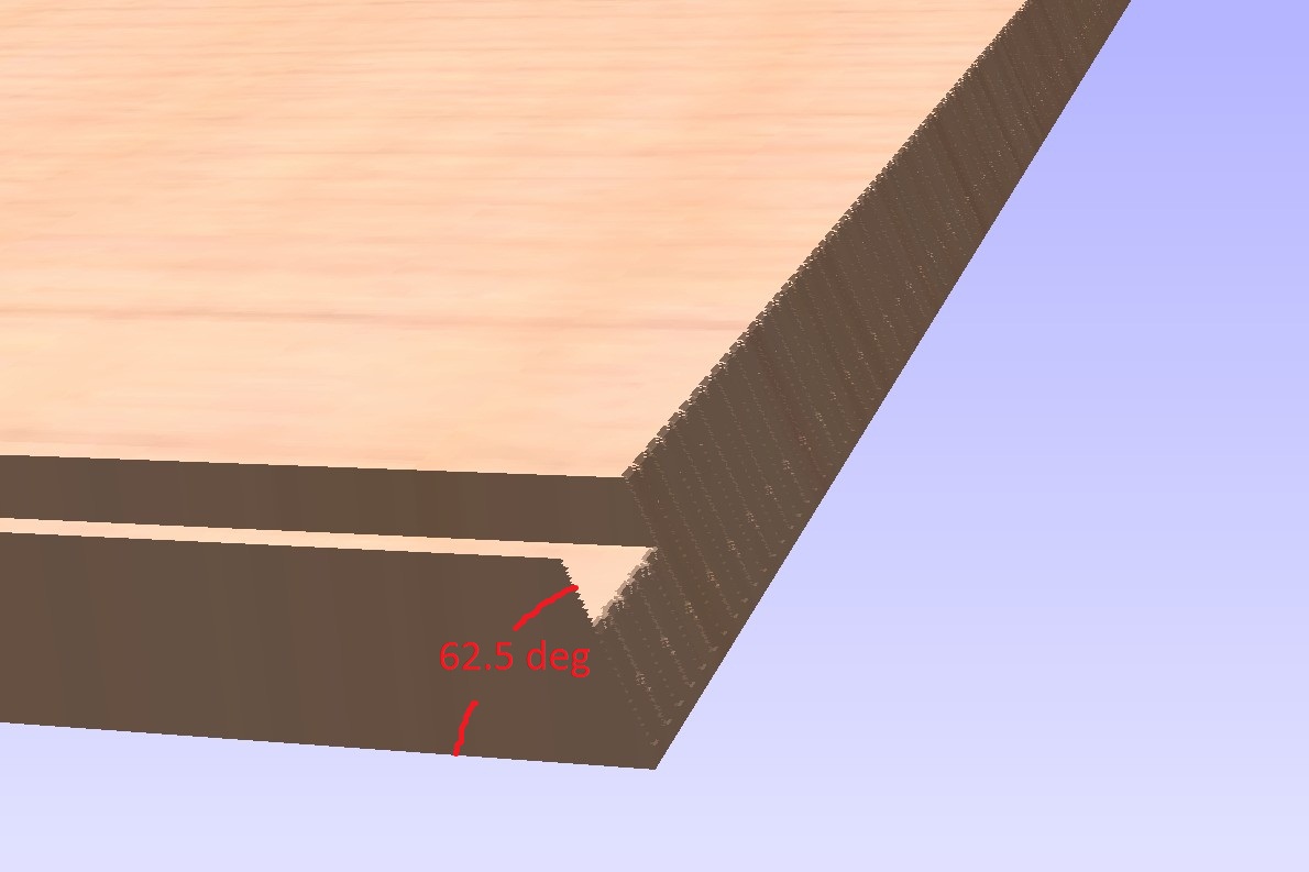

The Shopbot comes with versatile software called PartWorks. In it is a command "Create Fluting Toolpath". Flutes are cuts that start at a given height in the material and end at a lower level (think drainage grooves on a cutting board). In this case the flutes are not very long and they plunge quickly (rate determines angle). They are also spaced really close together.
The pics show one of the sides of the speaker stand, a piece about 18 inches high.
I used the same 1/4" flat endmill bit as I usually cut the parts out with. What you do is start the flutes (I made mine .15" apart) at the top of the material and have the tool go down an "incline" ---which of course is specified by the user -- till it reaches the bottom. You have to be careful with your layout to make sure you start and stop the bit at the correct place, taking into account bit diameter. At .15 spacing the "cut" has noticeable teeth but if you shift the adjacent part's fluting vectors by half that distance it fits together really nice. If you want virtually no teeth, go with .075 but of course that takes twice as long to machine. These teeth are not stair steps but lengthwise from the top of the material to the bottom. For example, one of these vectors (flutes) cutting a 45 degree angle on 1 inch thick material would be 1.414 inches long. To machine the 18 inch long miter with .15 spacing took 10 minutes.
If anyone wants the PartWorks file I will supply it or attach it here if interest.
Any miter can be cut this way; some Trig calcs are usually necessary to input the Fluting commmand.
The stands are completed and unfortunately I cleaned up too good as I can't find any scraps I tested the miters on.

No need to sand out the teeth, especially if you index the adjacent teeth to fit into each other. Also, if you machine these at .07 apart you can barely even see, let alone feel, any teeth.
As far as programming, you just program one flute and then repeat it for the length of the cut, takes seconds really. Well worth it in my opinion, when you can simply lift the finished piece off the machine with no extra attention to it required.

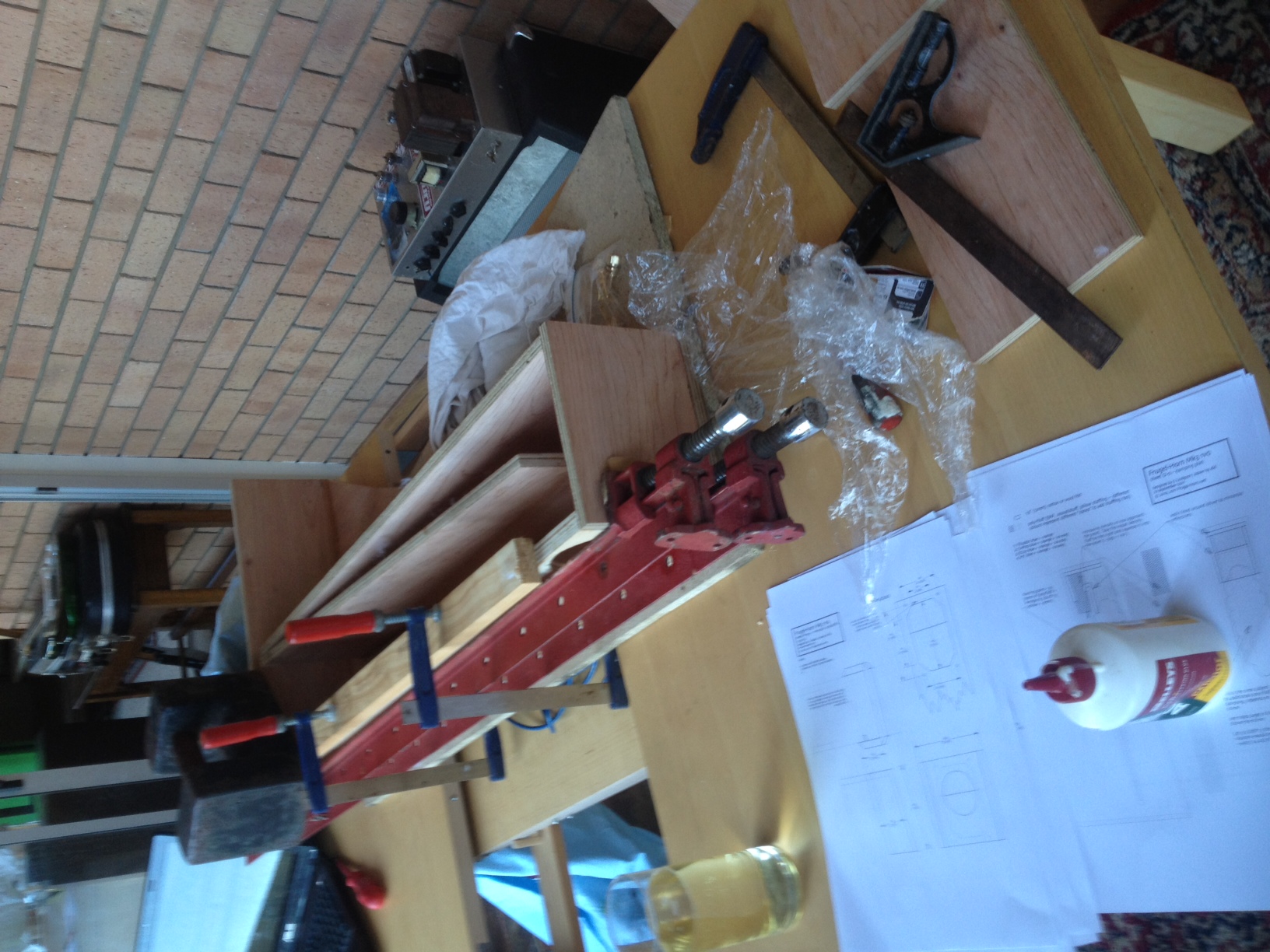

This is my build on the IKEA work bench/dinner table.No wife, wonder why
Now i know why the leaves come out the middle

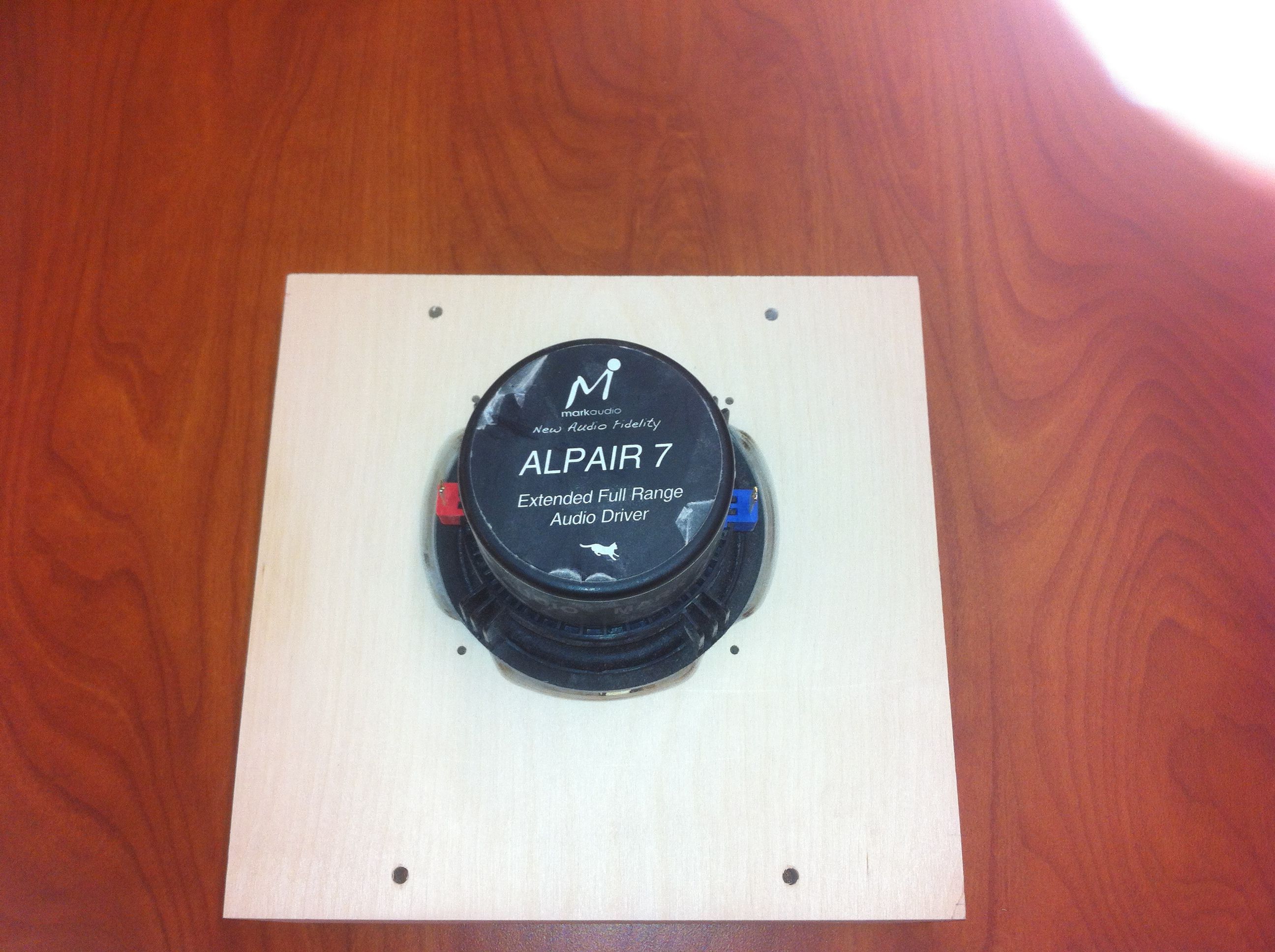

I will differ with fastbike1 on the lack of requirement to rebate/flush mount any of the Alpairs, and all that's required is to increase the thickness of front baffle to 18mm (what we do with the P10 flat packs) - either by laminating 3mm of ply or MDF to the face, or using thicker material if on hand. The 7.3 is not a particularly massive driver, and with scalloping of the relief of rear cut-out to leave solid "pads" at the mounting screw locations, still leaves plenty of material for mechanical fasteners.
