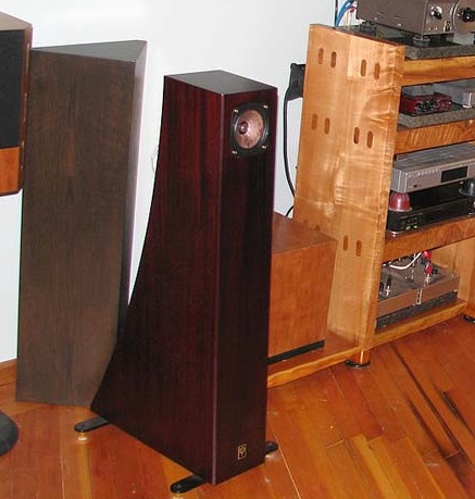

Ok, I am going to build the triangle rear baffles/reflection for behind my speakers. I would like to include a driver to reach some of the lower freq. Does anyone have the dimensions for ones that they are using? Can I put the driver on the front two angled sides (using two drivers) or should I put it on the back facing the wall/corner? Also, could I down fire it instead? All suggestions would be great... Thanks Folks.
attached as built sketch for the pair in above photo.
intended as easy build, with simple clean lines from the front, which is why the single driver (SDX7) was rear mounted, and amp external
yes - in metric
Thanks Chris... any thoughts to mounting driver down or two on each side of the angled front?
That was quick - note on the drawings that the SDX7 enclosure is sealed. As long as the driver of your choice is comfortable in a smallish sealed application you could mount them (multiples if you like) where ever they fit, but keep in mind that boundary loading directly into the floor would require at least a few inches of clearance.
With the 90` equilateral triangle shape (chosen for ease of build), the back (hypotenuse) is the widest panel and you can see that it's still a tight fit for magnet to clear.
Two other thoughts - IMHO, it's at least as important to use plywood vs MDF in a small woofer such as this, and bracing is imperative.
And so we could call it a stealthWoofer...
and so that we would get maximum room loading to push the response downward.
downward firingwould be fine, but when you look at the size of the triangle you aren't going to get much woofer mounted there -- i haver some nice looking Peerless 4" i'm trying.
