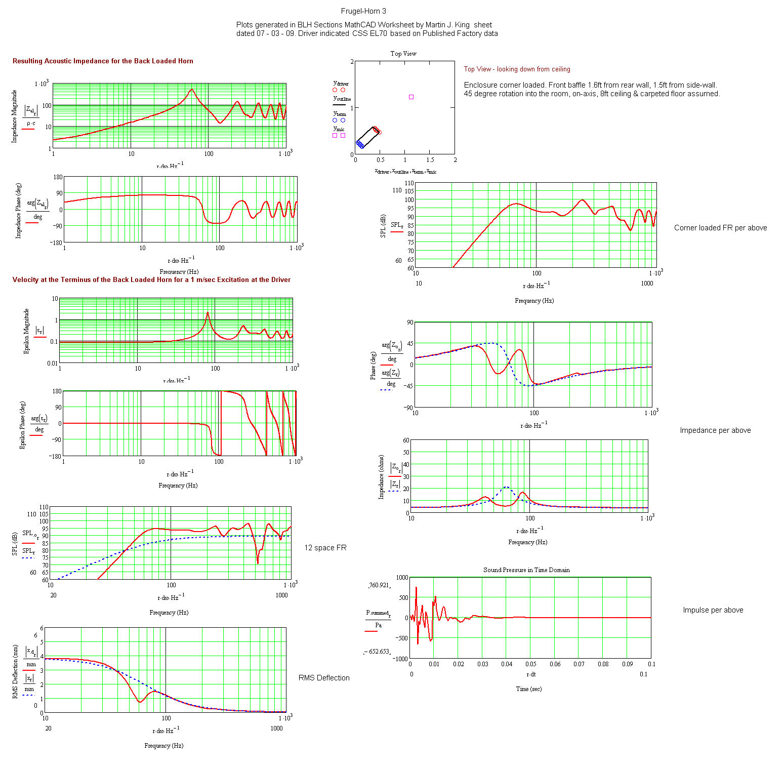

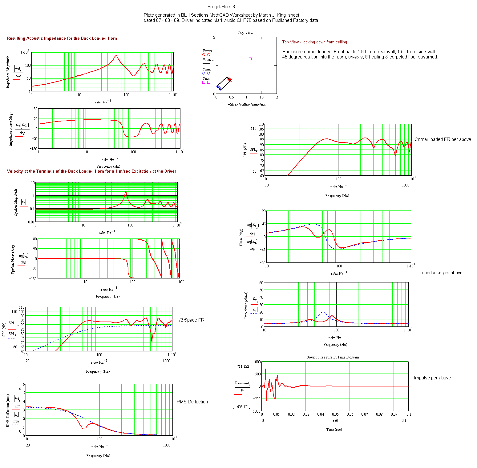

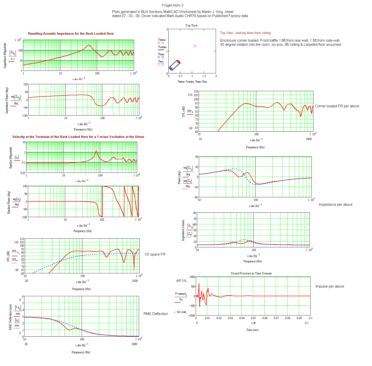

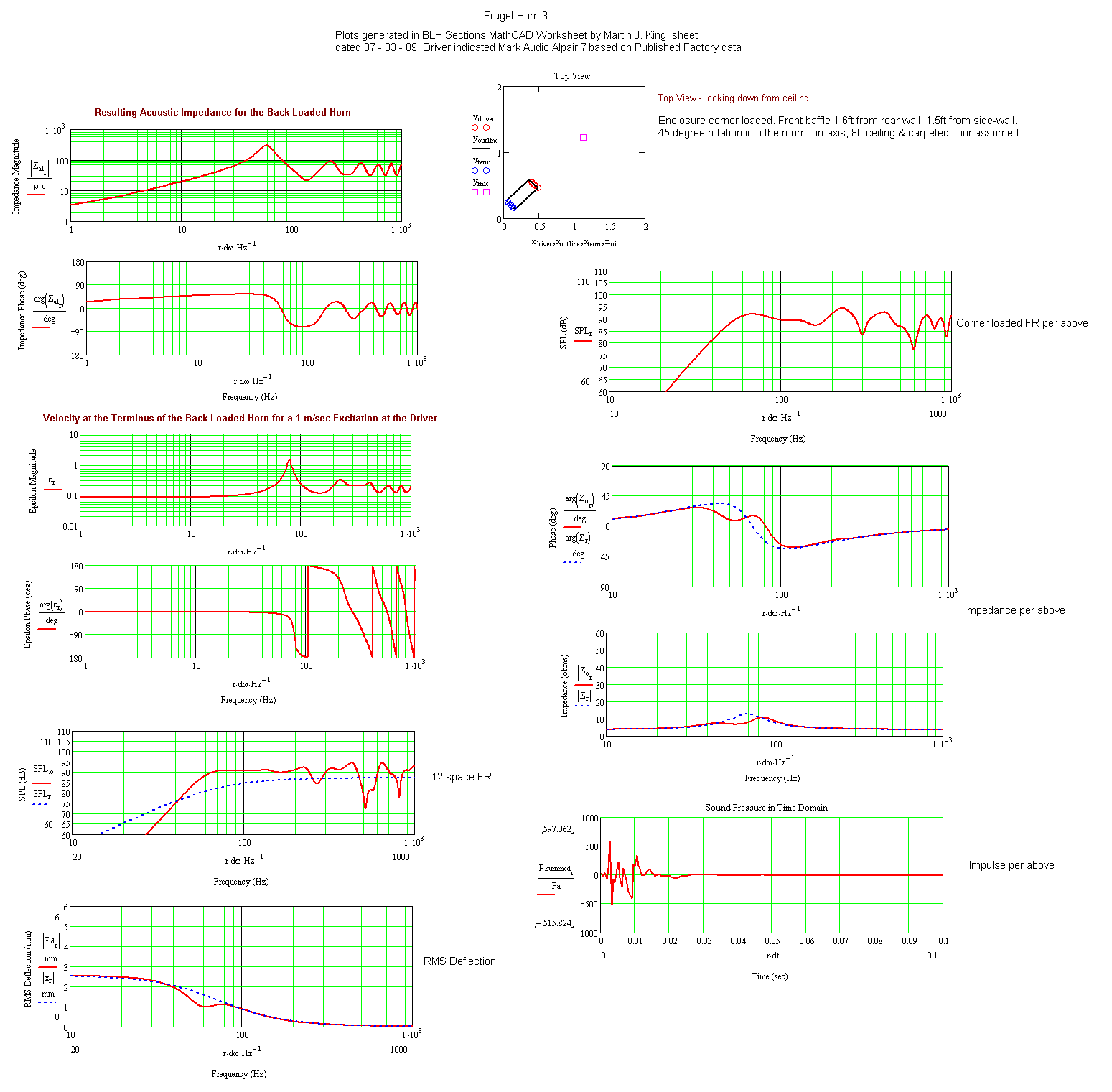

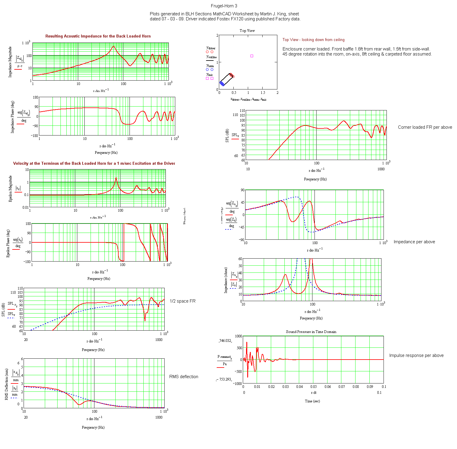

Does anyone have an impedance curve for any of the popular drivers in a FH3 cabinet?
Larry
Check from this post on: http://www.diyaudio.com/forums/full-range/172605-frugel-horn-mk3-40.html#post2491274
They are simulation but might help you...
Fostex FX120:A simulation of fe-126...interesting, thanks!
Larry

as well as CHR70.2:
diyAudio
CHP70 (G 1 as it would now be referenced, and possibly soon out of distribution)
diyAudio
Alpair 7 ( G1)
diyAudio
CSS EL70:
diyAudio
