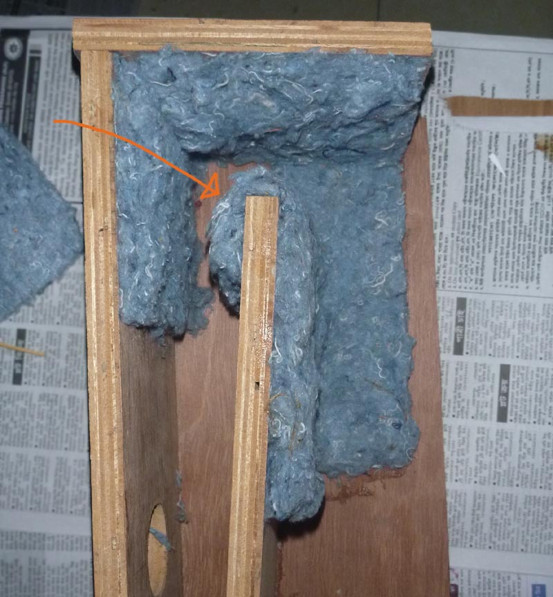

Lining question
Dave, Chrisb
Do I need to cover that empty spot (where the arrow is pointing at) in the pic?

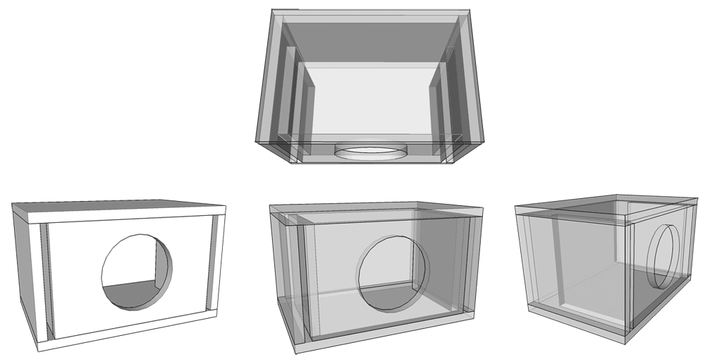

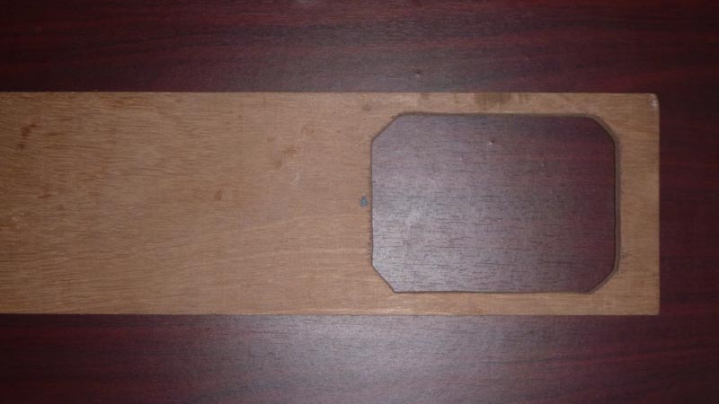

Thanks Dave.
BTW, I've gone for the removable baffle build - I made the cutout and removable baffle piece based on the pics from you and Chris had posted earlier. Let's see how it goes. 🙂
-Zia

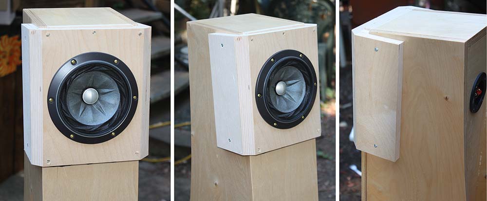

Is there a circular baffle that we should be looking at also? Is the reason for the extended baffle to help with phase or extend ??????? JP
As always, feel free to get creative with supra-baffles and report findings - but the arrangement pictured was intended a much as anything to accommodate drivers that would otherwise be tricky to install -
We designed our "kit" to allow for easy build with a minimum of tools / clamps etc - the front panel/driver baffle is inset (dadoed) into the side; any driver requiring cutouts approaching the 140mm internal would reduce the integrity of this piece, hence the wider plant-on baffle - which also allows for swapping out drivers of different dimensions and rebated cut-outs.
